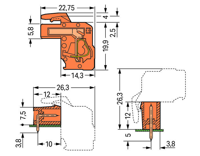

Actuation typeOperating toolOperating toolOperating toolOperating toolOperating toolOperating toolOperating toolOperating toolOperating toolOperating toolOperating toolOperating toolOperating toolOperating toolOperating toolOperating toolOperating toolOperating toolOperating toolOperating toolOperating toolOperating toolOperating toolOperating tool
Clamping spring materialChrome nickel spring steel (CrNi)Chrome nickel spring steel (CrNi)Chrome nickel spring steel (CrNi)Chrome nickel spring steel (CrNi)Chrome nickel spring steel (CrNi)Chrome nickel spring steel (CrNi)Chrome nickel spring steel (CrNi)Chrome nickel spring steel (CrNi)Chrome nickel spring steel (CrNi)Chrome nickel spring steel (CrNi)Chrome nickel spring steel (CrNi)Chrome nickel spring steel (CrNi)Chrome nickel spring steel (CrNi)Chrome nickel spring steel (CrNi)Chrome nickel spring steel (CrNi)Chrome nickel spring steel (CrNi)Chrome nickel spring steel (CrNi)Chrome nickel spring steel (CrNi)Chrome nickel spring steel (CrNi)Chrome nickel spring steel (CrNi)Chrome nickel spring steel (CrNi)Chrome nickel spring steel (CrNi)Chrome nickel spring steel (CrNi)Chrome nickel spring steel (CrNi)
Цветgraygraygraygraygraygraygraygraygraygraygraygraygrayorangeorangeorangeorangeorangeorangeorangeorangeorangeorangeorange
Conductor entry direction to mating direction, °270270270270270270270270270270270270270270270270270270270270270270270270
Connection technologyCAGE CLAMP®CAGE CLAMP®CAGE CLAMP®CAGE CLAMP®CAGE CLAMP®CAGE CLAMP®CAGE CLAMP®CAGE CLAMP®CAGE CLAMP®CAGE CLAMP®CAGE CLAMP®CAGE CLAMP®CAGE CLAMP®CAGE CLAMP®CAGE CLAMP®CAGE CLAMP®CAGE CLAMP®CAGE CLAMP®CAGE CLAMP®CAGE CLAMP®CAGE CLAMP®CAGE CLAMP®CAGE CLAMP®CAGE CLAMP®
Connector connection typefor conductorsfor conductorsfor conductorsfor conductorsfor conductorsfor conductorsfor conductorsfor conductorsfor conductorsfor conductorsfor conductorsfor conductorsfor conductorsfor conductorsfor conductorsfor conductorsfor conductorsfor conductorsfor conductorsfor conductorsfor conductorsfor conductorsfor conductorsfor conductors
Contact materialCopper alloyCopper alloyCopper alloyCopper alloyCopper alloyCopper alloyCopper alloyCopper alloyCopper alloyCopper alloyCopper alloyCopper alloyCopper alloyCopper alloyCopper alloyCopper alloyCopper alloyCopper alloyCopper alloyCopper alloyCopper alloyCopper alloyCopper alloyCopper alloy
Contact platingtin-platedtin-platedtin-platedtin-platedtin-platedtin-platedtin-platedtin-platedtin-platedtin-platedtin-platedtin-platedtin-platedtin-platedtin-platedtin-platedtin-platedtin-platedtin-platedtin-platedtin-platedtin-platedtin-platedtin-plated
Contact type (pluggable connector)Female connector/socketFemale connector/socketFemale connector/socketFemale connector/socketFemale connector/socketFemale connector/socketFemale connector/socketFemale connector/socketFemale connector/socketFemale connector/socketFemale connector/socketFemale connector/socketFemale connector/socketFemale connector/socketFemale connector/socketFemale connector/socketFemale connector/socketFemale connector/socketFemale connector/socketFemale connector/socketFemale connector/socketFemale connector/socketFemale connector/socketFemale connector/socket
Country of originDEDEDEDEDEDEDEDEDEDEDEDEDEDEDEDEDEDEDEDEDEDEDEDE
Габариты: глубина22.75 mm / 0.896 inch22.75 mm / 0.896 inch22.75 mm / 0.896 inch22.75 mm / 0.896 inch22.75 mm / 0.896 inch22.75 mm / 0.896 inch22.75 mm / 0.896 inch22.75 mm / 0.896 inch22.75 mm / 0.896 inch22.75 mm / 0.896 inch22.75 mm / 0.896 inch22.75 mm / 0.896 inch57.75 mm / 2.274 inch22.75 mm / 0.896 inch22.75 mm / 0.896 inch22.75 mm / 0.896 inch22.75 mm / 0.896 inch22.75 mm / 0.896 inch22.75 mm / 0.896 inch22.75 mm / 0.896 inch22.75 mm / 0.896 inch22.75 mm / 0.896 inch22.75 mm / 0.896 inch22.75 mm / 0.896 inch
Designangledangledangledangledangledangledangledangledangledangledangledangledangledangledangledangledangledangledangledangledangledangledangledangled
Fine-stranded conductor0.08 … 2.5 mm² / 28 … 12 AWG0.08 … 2.5 mm² / 28 … 12 AWG0.08 … 2.5 mm² / 28 … 12 AWG0.08 … 2.5 mm² / 28 … 12 AWG0.08 … 2.5 mm² / 28 … 12 AWG0.08 … 2.5 mm² / 28 … 12 AWG0.08 … 2.5 mm² / 28 … 12 AWG0.08 … 2.5 mm² / 28 … 12 AWG0.08 … 2.5 mm² / 28 … 12 AWG0.08 … 2.5 mm² / 28 … 12 AWG0.08 … 2.5 mm² / 28 … 12 AWG0.08 … 2.5 mm² / 28 … 12 AWG0.08 … 2.5 mm² / 28 … 12 AWG0.08 … 2.5 mm² / 28 … 12 AWG0.08 … 2.5 mm² / 28 … 12 AWG0.08 … 2.5 mm² / 28 … 12 AWG0.08 … 2.5 mm² / 28 … 12 AWG0.08 … 2.5 mm² / 28 … 12 AWG0.08 … 2.5 mm² / 28 … 12 AWG0.08 … 2.5 mm² / 28 … 12 AWG0.08 … 2.5 mm² / 28 … 12 AWG0.08 … 2.5 mm² / 28 … 12 AWG0.08 … 2.5 mm² / 28 … 12 AWG0.08 … 2.5 mm² / 28 … 12 AWG
Fine-stranded conductor with ferrule with plastic collar0.25 … 1.5 mm²0.25 … 1.5 mm²0.25 … 1.5 mm²0.25 … 1.5 mm²0.25 … 1.5 mm²0.25 … 1.5 mm²0.25 … 1.5 mm²0.25 … 1.5 mm²0.25 … 1.5 mm²0.25 … 1.5 mm²0.25 … 1.5 mm²0.25 … 1.5 mm²0.25 … 1.5 mm²0.25 … 1.5 mm²0.25 … 1.5 mm²0.25 … 1.5 mm²0.25 … 1.5 mm²0.25 … 1.5 mm²0.25 … 1.5 mm²0.25 … 1.5 mm²0.25 … 1.5 mm²0.25 … 1.5 mm²0.25 … 1.5 mm²0.25 … 1.5 mm²
Fine-stranded conductor with ferrule without plastic collar0.25 … 2.5 mm²0.25 … 2.5 mm²0.25 … 2.5 mm²0.25 … 2.5 mm²0.25 … 2.5 mm²0.25 … 2.5 mm²0.25 … 2.5 mm²0.25 … 2.5 mm²0.25 … 2.5 mm²0.25 … 2.5 mm²0.25 … 2.5 mm²0.25 … 2.5 mm²0.25 … 2.5 mm²0.25 … 2.5 mm²0.25 … 2.5 mm²0.25 … 2.5 mm²0.25 … 2.5 mm²0.25 … 2.5 mm²0.25 … 2.5 mm²0.25 … 2.5 mm²0.25 … 2.5 mm²0.25 … 2.5 mm²0.25 … 2.5 mm²0.25 … 2.5 mm²
Fire load, MJ0.080.1220.1630.2050.2470.2890.3310.3730.4150.4570.4990.6670.7430.0820.1240.1670.2090.2510.2930.3350.3770.4190.4610.503
Flammability class per UL94V0V0V0V0V0V0V0V0V0V0V0V0V0V0V0V0V0V0V0V0V0V0V0V0
GTIN404491839146740449183916104044918391689404491839171940449183917334044918391801404491839186340449183919794044918392020404491839204440449183920684044918392075404491839211240449183915354044918392594404491839261740449183926554044918392693404491839273040449183927544044918392778404491839279240449183928154044918392839
Height23.9 mm / 0.941 inch23.9 mm / 0.941 inch23.9 mm / 0.941 inch23.9 mm / 0.941 inch23.9 mm / 0.941 inch23.9 mm / 0.941 inch23.9 mm / 0.941 inch23.9 mm / 0.941 inch23.9 mm / 0.941 inch23.9 mm / 0.941 inch23.9 mm / 0.941 inch23.9 mm / 0.941 inch23.9 mm / 0.941 inch23.9 mm / 0.941 inch23.9 mm / 0.941 inch23.9 mm / 0.941 inch23.9 mm / 0.941 inch23.9 mm / 0.941 inch23.9 mm / 0.941 inch23.9 mm / 0.941 inch23.9 mm / 0.941 inch23.9 mm / 0.941 inch23.9 mm / 0.941 inch23.9 mm / 0.941 inch
Insulating materialPolyamide 66 (PA 66)Polyamide 66 (PA 66)Polyamide 66 (PA 66)Polyamide 66 (PA 66)Polyamide 66 (PA 66)Polyamide 66 (PA 66)Polyamide 66 (PA 66)Polyamide 66 (PA 66)Polyamide 66 (PA 66)Polyamide 66 (PA 66)Polyamide 66 (PA 66)Polyamide 66 (PA 66)Polyamide 66 (PA 66)Polyamide 66 (PA 66)Polyamide 66 (PA 66)Polyamide 66 (PA 66)Polyamide 66 (PA 66)Polyamide 66 (PA 66)Polyamide 66 (PA 66)Polyamide 66 (PA 66)Polyamide 66 (PA 66)Polyamide 66 (PA 66)Polyamide 66 (PA 66)Polyamide 66 (PA 66)
Legend (ratings)(III / 2) ≙ Overvoltage category III / Pollution degree 2(III / 2) ≙ Overvoltage category III / Pollution degree 2(III / 2) ≙ Overvoltage category III / Pollution degree 2(III / 2) ≙ Overvoltage category III / Pollution degree 2(III / 2) ≙ Overvoltage category III / Pollution degree 2(III / 2) ≙ Overvoltage category III / Pollution degree 2(III / 2) ≙ Overvoltage category III / Pollution degree 2(III / 2) ≙ Overvoltage category III / Pollution degree 2(III / 2) ≙ Overvoltage category III / Pollution degree 2(III / 2) ≙ Overvoltage category III / Pollution degree 2(III / 2) ≙ Overvoltage category III / Pollution degree 2(III / 2) ≙ Overvoltage category III / Pollution degree 2(III / 2) ≙ Overvoltage category III / Pollution degree 2(III / 2) ≙ Overvoltage category III / Pollution degree 2(III / 2) ≙ Overvoltage category III / Pollution degree 2(III / 2) ≙ Overvoltage category III / Pollution degree 2(III / 2) ≙ Overvoltage category III / Pollution degree 2(III / 2) ≙ Overvoltage category III / Pollution degree 2(III / 2) ≙ Overvoltage category III / Pollution degree 2(III / 2) ≙ Overvoltage category III / Pollution degree 2(III / 2) ≙ Overvoltage category III / Pollution degree 2(III / 2) ≙ Overvoltage category III / Pollution degree 2(III / 2) ≙ Overvoltage category III / Pollution degree 2(III / 2) ≙ Overvoltage category III / Pollution degree 2
Limit temperature range-60 … +100 °C-60 … +100 °C-60 … +100 °C-60 … +100 °C-60 … +100 °C-60 … +100 °C-60 … +100 °C-60 … +100 °C-60 … +100 °C-60 … +100 °C-60 … +100 °C-60 … +100 °C-60 … +100 °C-60 … +100 °C-60 … +100 °C-60 … +100 °C-60 … +100 °C-60 … +100 °C-60 … +100 °C-60 … +100 °C-60 … +100 °C-60 … +100 °C-60 … +100 °C-60 … +100 °C
Material groupIIIIIIIIIIIIIIIIIIIIIIII
Mismating protectionNoNoNoNoNoNoNoNoNoNoNoNoNoNoNoNoNoNoNoNoNoNoNoNo
Number of Poles23456789101112161623456789101112
Number of connection types111111111111111111111111
Number of levels111111111111111111111111
Pin spacing7.5 mm (0.295 inch)7.5 mm (0.295 inch)7.5 mm (0.295 inch)7.5 mm (0.295 inch)7.5 mm (0.295 inch)7.5 mm (0.295 inch)7.5 mm (0.295 inch)7.5 mm (0.295 inch)7.5 mm (0.295 inch)7.5 mm (0.295 inch)7.5 mm (0.295 inch)7.5 mm (0.295 inch)7.5 mm (0.295 inch)7.62 mm (0.3 inch)7.62 mm (0.3 inch)7.62 mm (0.3 inch)7.62 mm (0.3 inch)7.62 mm (0.3 inch)7.62 mm (0.3 inch)7.62 mm (0.3 inch)7.62 mm (0.3 inch)7.62 mm (0.3 inch)7.62 mm (0.3 inch)7.62 mm (0.3 inch)
Product Group3 (Multi Conn. System)3 (Multi Conn. System)3 (Multi Conn. System)3 (Multi Conn. System)3 (Multi Conn. System)3 (Multi Conn. System)3 (Multi Conn. System)3 (Multi Conn. System)3 (Multi Conn. System)3 (Multi Conn. System)3 (Multi Conn. System)3 (Multi Conn. System)3 (Multi Conn. System)3 (Multi Conn. System)3 (Multi Conn. System)3 (Multi Conn. System)3 (Multi Conn. System)3 (Multi Conn. System)3 (Multi Conn. System)3 (Multi Conn. System)3 (Multi Conn. System)3 (Multi Conn. System)3 (Multi Conn. System)3 (Multi Conn. System)
Rated current, A141414141414141414141414141414141414141414141414
Rated impulse voltage (II / 2), kV666666666666666666666666
Rated impulse voltage (III / 2), kV666666666666666666666666
Rated impulse voltage (III / 3), kV666666666666666666666666
Rated voltage (II / 2), В100010001000100010001000100010001000100010001000100010001000100010001000100010001000100010001000
Rated voltage (III / 2), В630630630630630630630630630630630630630630630630630630630630630630630630
Rated voltage (III / 3), В500500500500500500500500500500500500500500500500500500500500500500500500
Solid conductor0.08 … 2.5 mm² / 28 … 12 AWG0.08 … 2.5 mm² / 28 … 12 AWG0.08 … 2.5 mm² / 28 … 12 AWG0.08 … 2.5 mm² / 28 … 12 AWG0.08 … 2.5 mm² / 28 … 12 AWG0.08 … 2.5 mm² / 28 … 12 AWG0.08 … 2.5 mm² / 28 … 12 AWG0.08 … 2.5 mm² / 28 … 12 AWG0.08 … 2.5 mm² / 28 … 12 AWG0.08 … 2.5 mm² / 28 … 12 AWG0.08 … 2.5 mm² / 28 … 12 AWG0.08 … 2.5 mm² / 28 … 12 AWG0.08 … 2.5 mm² / 28 … 12 AWG0.08 … 2.5 mm² / 28 … 12 AWG0.08 … 2.5 mm² / 28 … 12 AWG0.08 … 2.5 mm² / 28 … 12 AWG0.08 … 2.5 mm² / 28 … 12 AWG0.08 … 2.5 mm² / 28 … 12 AWG0.08 … 2.5 mm² / 28 … 12 AWG0.08 … 2.5 mm² / 28 … 12 AWG0.08 … 2.5 mm² / 28 … 12 AWG0.08 … 2.5 mm² / 28 … 12 AWG0.08 … 2.5 mm² / 28 … 12 AWG0.08 … 2.5 mm² / 28 … 12 AWG
Strip length8 … 9 mm / 0.31 … 0.35 Inch8 … 9 mm / 0.31 … 0.35 Inch8 … 9 mm / 0.31 … 0.35 Inch8 … 9 mm / 0.31 … 0.35 Inch8 … 9 mm / 0.31 … 0.35 Inch8 … 9 mm / 0.31 … 0.35 Inch8 … 9 mm / 0.31 … 0.35 Inch8 … 9 mm / 0.31 … 0.35 Inch8 … 9 mm / 0.31 … 0.35 Inch8 … 9 mm / 0.31 … 0.35 Inch8 … 9 mm / 0.31 … 0.35 Inch8 … 9 mm / 0.31 … 0.35 Inch8 … 9 mm / 0.31 … 0.35 Inch8 … 9 mm / 0.31 … 0.35 Inch8 … 9 mm / 0.31 … 0.35 Inch8 … 9 mm / 0.31 … 0.35 Inch8 … 9 mm / 0.31 … 0.35 Inch8 … 9 mm / 0.31 … 0.35 Inch8 … 9 mm / 0.31 … 0.35 Inch8 … 9 mm / 0.31 … 0.35 Inch8 … 9 mm / 0.31 … 0.35 Inch8 … 9 mm / 0.31 … 0.35 Inch8 … 9 mm / 0.31 … 0.35 Inch8 … 9 mm / 0.31 … 0.35 Inch
Total number of connection points234567891011121623456789101112
Total number of potentials23456789101112161623456789101112
Вес, г4.366.8958.8411.10513.3715.63518.22420.16522.4324.69526.9636.0238.354.436.6958.7511.23513.48815.76518.0320.29522.5625.527.09
Ширина14.9 mm / 0.587 inch22.4 mm / 0.882 inch29.9 mm / 1.177 inch37.4 mm / 1.472 inch44.9 mm / 1.768 inch52.4 mm / 2.063 inch59.9 mm / 2.358 inch67.4 mm / 2.654 inch74.9 mm / 2.949 inch82.4 mm / 3.244 inch89.9 mm / 3.539 inch119.9 mm / 4.72 inch119.9 mm / 4.72 inch15.1 mm / 0.594 inch22.72 mm / 0.894 inch30.34 mm / 1.194 inch37.96 mm / 1.494 inch45.58 mm / 1.794 inch53.2 mm / 2.094 inch60.82 mm / 2.394 inch68.44 mm / 2.694 inch76.06 mm / 2.994 inch83.68 mm / 3.294 inch91.3 mm / 3.594 inch
