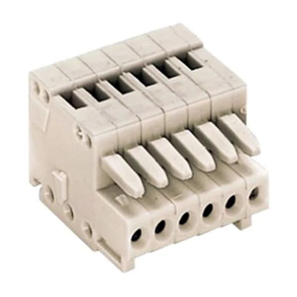

Datasheet Wago 733-105/010-000 — Даташит
1-проводниковая розетка; 100% защита от неправильного подсоединения; Контакты с позолотой; 0,5 мм²; Шаг контактов 2,5 мм; 5-пол.
![]() 33 предложений от 11 поставщиков Съемная клеммная колодка, 2.5 мм, 5 вывод(-ов), 28AWG до 20AWG, 0.5 мм², Зажим, 6 А | |||
733-105. Wago | от 650 ₽ | ||
733-105 | от 701 ₽ | ||
733-105/037-000 Wago | по запросу | ||
733105 | по запросу |
Actuation type | Operating tool |
Clamping spring material | Chrome nickel spring steel (CrNi) |
Цвет | light gray |
Connection technology | CAGE CLAMP® |
Connector connection type | for conductors |
Contact material | Copper alloy |
Contact plating | gold-plated |
Contact type (pluggable connector) | Female connector/socket |
Country of origin | DE |
Габариты: глубина | 17.1 mm / 0.673 inch |
Fine-stranded conductor | 0.08 … 0.5 mm² / 28 … 20 AWG |
Fine-stranded conductor with ferrule with plastic collar | 0.25 … 0.34 mm² |
Fine-stranded conductor with ferrule without plastic collar | 0.25 … 0.34 mm² |
Fire load | 0.004 MJ |
GTIN | 4044918366748 |
Height | 11.8 mm / 0.465 inch |
Legend (ratings) | (III / 2) ≙ Overvoltage category III / Pollution degree 2 |
Limit temperature range | -60 … +100 °C |
Material group | I |
Mismating protection | Yes |
Number of Poles | 5 |
Number of connection types | 1 |
Number of levels | 1 |
Pin spacing | 2.5 mm (0.098 inch) |
Product Group | 3 (Multi Conn. System) |
Rated current | 6 A |
Rated impulse voltage (II / 2) | 2.5 kV |
Rated impulse voltage (III / 2) | 2.5 kV |
Rated impulse voltage (III / 3) | 2.5 kV |
Rated voltage (II / 2) | 320 В |
Rated voltage (III / 2) | 160 В |
Rated voltage (III / 3) | 100 В |
Solid conductor | 0.08 … 0.5 mm² / 28 … 20 AWG |
Strip length | 5 … 6 mm / 0.2 … 0.24 Inch |
Total number of connection points | 5 |
Total number of potentials | 5 |
Вес | 2.75 г |
Ширина | 14.6 mm / 0.574 inch |
