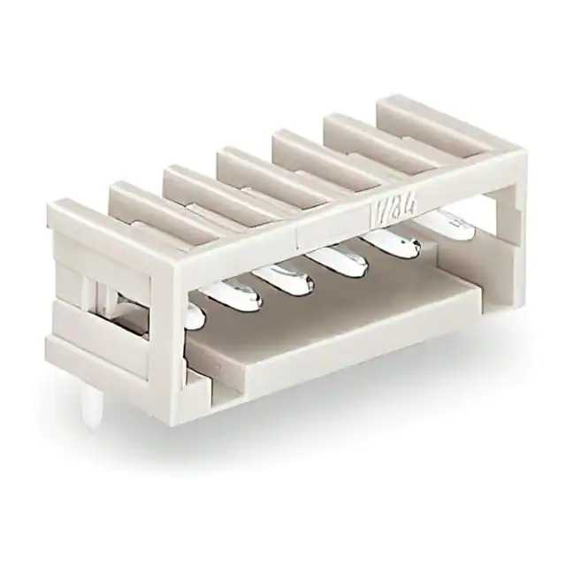

Вилка THT; 0.8 x 0.8 mm solder pin; угловые; 100% защита от неправильного подсоединения; Шаг контактов 2,5 мм; 6-пол.

Цвет | light gray |
Connector connection type | for PCBs |
Contact material | Electrolytic copper (Ecu) |
Contact plating | tin-plated |
Contact type (pluggable connector) | Male connector/plug |
Country of origin | DE |
Габариты: глубина | 8.9 mm / 0.35 inch |
Drilled hole diameter (tolerance) | 1.1(+ 0.1) мм |
Fire load | 0.015 MJ |
GTIN | 4044918974400 |
Height | 11.5 mm / 0.453 inch |
Height from the surface | 7.8 mm / 0.307 inch |
Legend (ratings) | (III / 2) ≙ Overvoltage category III / Pollution degree 2 |
Limit temperature range | -60 … +100 °C |
Material group | I |
Mismating protection | Yes |
Number of Poles | 6 |
Number of levels | 1 |
Number of solder pins per potential | 1 |
PCB contact | THT |
Pin spacing | 2.5 mm (0.098 inch) |
Product Group | 3 (Multi Conn. System) |
Rated current | 6 A |
Rated impulse voltage (II / 2) | 2.5 kV |
Rated impulse voltage (III / 2) | 2.5 kV |
Rated impulse voltage (III / 3) | 2.5 kV |
Rated voltage (II / 2) | 320 В |
Rated voltage (III / 2) | 160 В |
Rated voltage (III / 3) | 80 В |
Solder pin arrangement | over the entire male connector, in line |
Solder pin dimensions | 0.8 x 0.8 mm |
Solder pin length | 3.7 мм |
Total number of potentials | 6 |
Вес | 0.98 г |
Ширина | 17.5 mm / 0.689 inch |
