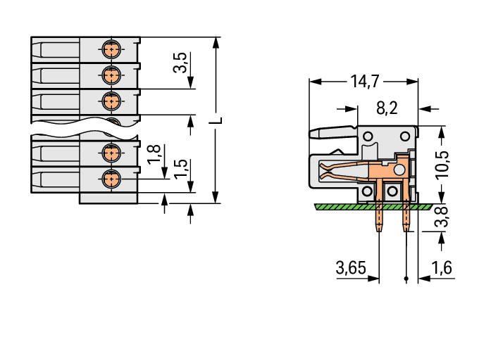

Розетка под пайку THT; 0.9 x 0.9 mm solder pin; угловые; 100% защита от неправильного подсоединения; Шаг контактов 3,5 мм; 12-пол.
THT FEMALE HEADER; 0.9 X 0.9 MM | |||
734-542 Wago | по запросу |
Цвет | light gray |
Connector connection type | for PCBs |
Contact material | Copper alloy |
Contact plating | tin-plated |
Contact type (pluggable connector) | Female connector/socket |
Country of origin | DE |
Габариты: глубина | 14.65 mm / 0.577 inch |
Drilled hole diameter (tolerance) | 1.4(+ 0.1) мм |
Fire load | 0.099 MJ |
GTIN | 4045454120665 |
Height | 14.3 mm / 0.563 inch |
Height from the surface | 10.5 mm / 0.413 inch |
Legend (ratings) | (III / 2) ≙ Overvoltage category III / Pollution degree 2 |
Limit temperature range | -60 … +100 °C |
Material group | I |
Mismating protection | Yes |
Number of Poles | 12 |
Number of levels | 1 |
Number of solder pins per potential | 1 |
PCB contact | THT |
Pin spacing | 3.5 mm (0.138 inch) |
Product Group | 3 (Multi Conn. System) |
Rated current | 10 A |
Rated impulse voltage (II / 2) | 2.5 kV |
Rated impulse voltage (III / 2) | 2.5 kV |
Rated impulse voltage (III / 3) | 2.5 kV |
Rated voltage (II / 2) | 320 В |
Rated voltage (III / 2) | 160 В |
Rated voltage (III / 3) | 160 В |
Solder pin arrangement | over the entire female connector, in line |
Solder pin dimensions | 0.9 x 0.9 mm |
Solder pin length | 3.8 мм |
Total number of connection points | 12 |
Total number of potentials | 12 |
Вес | 6.35 г |
Ширина | 43.5 mm / 1.713 inch |
