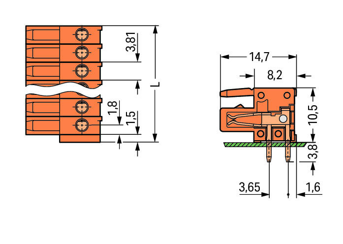

Розетка под пайку THT; 0.9 x 0.9 mm solder pin; угловые; 100% защита от неправильного подсоединения; Шаг контактов 3,81 мм; 2-пол.
Augswan
734-562
Wago
Wago 734-562 Wago 734-562
Цветorange
Connector connection typefor PCBs
Contact materialCopper alloy
Contact platingtin-plated
Contact type (pluggable connector)Female connector/socket
Country of originDE
Габариты: глубина14.65 mm / 0.577 inch
Drilled hole diameter (tolerance)1.4(+ 0.1) мм
Fire load0.025 MJ
Flammability class per UL94V0
GTIN4045454120870
Height14.3 mm / 0.563 inch
Height from the surface10.5 mm / 0.413 inch
Insulating materialPolyamide 66 (PA 66)
Legend (ratings)(III / 2) ≙ Overvoltage category III / Pollution degree 2
Limit temperature range-60 … +100 °C
Material groupI
Mismating protectionYes
Number of Poles2
Number of levels1
Number of solder pins per potential1
PCB contactTHT
Pin spacing3.81 mm (0.15 inch)
Product Group3 (Multi Conn. System)
Rated current10 A
Rated impulse voltage (II / 2)2.5 kV
Rated impulse voltage (III / 2)2.5 kV
Rated impulse voltage (III / 3)2.5 kV
Rated voltage (II / 2)320 В
Rated voltage (III / 2)160 В
Rated voltage (III / 3)160 В
Solder pin arrangementover the entire female connector, in line
Solder pin dimensions0.9 x 0.9 mm
Solder pin length3.8 мм
Total number of connection points2
Total number of potentials2
Вес1.2 г
Ширина9.12 mm / 0.359 inch
