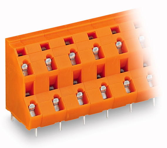

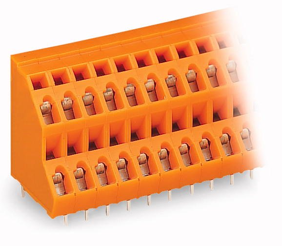

| Parameters / Models | 736-102![]() | 736-103![]() | 736-104![]() | 736-106![]() | 736-107/000-016![]() | 736-108![]() | 736-112![]() | 736-116![]() | 736-124![]() | 736-202![]() | 736-203![]() | 736-204![]() | 736-206![]() | 736-208![]() | 736-212![]() | 736-216![]() | 736-224![]() | 736-302![]() | 736-303![]() | 736-304![]() | 736-306![]() | 736-308![]() | 736-312![]() | 736-316![]() | 736-324![]() | 736-402![]() | 736-403![]() | 736-404![]() | 736-406![]() | 736-408![]() | 736-412![]() | 736-415![]() | 736-416![]() | 736-424![]() | 736-502![]() | 736-503![]() | 736-504![]() | 736-506![]() | 736-508![]() | 736-510![]() | 736-512![]() | 736-516![]() | 736-552![]() | 736-553![]() | 736-554![]() | 736-556![]() | 736-558![]() | 736-562![]() | 736-566![]() | 736-602![]() | 736-603![]() | 736-604![]() | 736-606![]() | 736-608![]() | 736-612![]() | 736-616![]() | 736-652![]() | 736-653![]() | 736-654![]() | 736-656![]() | 736-658![]() | 736-660![]() | 736-662![]() | 736-665![]() | 736-666![]() | 736-702![]() | 736-703![]() | 736-704![]() | 736-706![]() | 736-708![]() | 736-712![]() | 736-752![]() | 736-753![]() | 736-754![]() | 736-756![]() | 736-758![]() | 736-762![]() | 736-802![]() | 736-803![]() | 736-804![]() | 736-806![]() | 736-808![]() | 736-812![]() | 736-852![]() | 736-853![]() | 736-854![]() | 736-856![]() | 736-858![]() | 736-862![]() |
| Actuation type | Operating tool | Operating tool | Operating tool | Operating tool | Operating tool | Operating tool | Operating tool | Operating tool | Operating tool | Operating tool | Operating tool | Operating tool | Operating tool | Operating tool | Operating tool | Operating tool | Operating tool | Operating tool | Operating tool | Operating tool | Operating tool | Operating tool | Operating tool | Operating tool | Operating tool | Operating tool | Operating tool | Operating tool | Operating tool | Operating tool | Operating tool | Operating tool | Operating tool | Operating tool | Operating tool | Operating tool | Operating tool | Operating tool | Operating tool | Operating tool | Operating tool | Operating tool | Operating tool | Operating tool | Operating tool | Operating tool | Operating tool | Operating tool | Operating tool | Operating tool | Operating tool | Operating tool | Operating tool | Operating tool | Operating tool | Operating tool | Operating tool | Operating tool | Operating tool | Operating tool | Operating tool | Operating tool | Operating tool | Operating tool | Operating tool | Operating tool | Operating tool | Operating tool | Operating tool | Operating tool | Operating tool | Operating tool | Operating tool | Operating tool | Operating tool | Operating tool | Operating tool | Operating tool | Operating tool | Operating tool | Operating tool | Operating tool | Operating tool | Operating tool | Operating tool | Operating tool | Operating tool | Operating tool | Operating tool |
| Clamping spring material | Chrome nickel spring steel (CrNi) | Chrome nickel spring steel (CrNi) | Chrome nickel spring steel (CrNi) | Chrome nickel spring steel (CrNi) | Chrome nickel spring steel (CrNi) | Chrome nickel spring steel (CrNi) | Chrome nickel spring steel (CrNi) | Chrome nickel spring steel (CrNi) | Chrome nickel spring steel (CrNi) | Chrome nickel spring steel (CrNi) | Chrome nickel spring steel (CrNi) | Chrome nickel spring steel (CrNi) | Chrome nickel spring steel (CrNi) | Chrome nickel spring steel (CrNi) | Chrome nickel spring steel (CrNi) | Chrome nickel spring steel (CrNi) | Chrome nickel spring steel (CrNi) | Chrome nickel spring steel (CrNi) | Chrome nickel spring steel (CrNi) | Chrome nickel spring steel (CrNi) | Chrome nickel spring steel (CrNi) | Chrome nickel spring steel (CrNi) | Chrome nickel spring steel (CrNi) | Chrome nickel spring steel (CrNi) | Chrome nickel spring steel (CrNi) | Chrome nickel spring steel (CrNi) | Chrome nickel spring steel (CrNi) | Chrome nickel spring steel (CrNi) | Chrome nickel spring steel (CrNi) | Chrome nickel spring steel (CrNi) | Chrome nickel spring steel (CrNi) | Chrome nickel spring steel (CrNi) | Chrome nickel spring steel (CrNi) | Chrome nickel spring steel (CrNi) | Chrome nickel spring steel (CrNi) | Chrome nickel spring steel (CrNi) | Chrome nickel spring steel (CrNi) | Chrome nickel spring steel (CrNi) | Chrome nickel spring steel (CrNi) | Chrome nickel spring steel (CrNi) | Chrome nickel spring steel (CrNi) | Chrome nickel spring steel (CrNi) | Chrome nickel spring steel (CrNi) | Chrome nickel spring steel (CrNi) | Chrome nickel spring steel (CrNi) | Chrome nickel spring steel (CrNi) | Chrome nickel spring steel (CrNi) | Chrome nickel spring steel (CrNi) | Chrome nickel spring steel (CrNi) | Chrome nickel spring steel (CrNi) | Chrome nickel spring steel (CrNi) | Chrome nickel spring steel (CrNi) | Chrome nickel spring steel (CrNi) | Chrome nickel spring steel (CrNi) | Chrome nickel spring steel (CrNi) | Chrome nickel spring steel (CrNi) | Chrome nickel spring steel (CrNi) | Chrome nickel spring steel (CrNi) | Chrome nickel spring steel (CrNi) | Chrome nickel spring steel (CrNi) | Chrome nickel spring steel (CrNi) | Chrome nickel spring steel (CrNi) | Chrome nickel spring steel (CrNi) | Chrome nickel spring steel (CrNi) | Chrome nickel spring steel (CrNi) | Chrome nickel spring steel (CrNi) | Chrome nickel spring steel (CrNi) | Chrome nickel spring steel (CrNi) | Chrome nickel spring steel (CrNi) | Chrome nickel spring steel (CrNi) | Chrome nickel spring steel (CrNi) | Chrome nickel spring steel (CrNi) | Chrome nickel spring steel (CrNi) | Chrome nickel spring steel (CrNi) | Chrome nickel spring steel (CrNi) | Chrome nickel spring steel (CrNi) | Chrome nickel spring steel (CrNi) | Chrome nickel spring steel (CrNi) | Chrome nickel spring steel (CrNi) | Chrome nickel spring steel (CrNi) | Chrome nickel spring steel (CrNi) | Chrome nickel spring steel (CrNi) | Chrome nickel spring steel (CrNi) | Chrome nickel spring steel (CrNi) | Chrome nickel spring steel (CrNi) | Chrome nickel spring steel (CrNi) | Chrome nickel spring steel (CrNi) | Chrome nickel spring steel (CrNi) | Chrome nickel spring steel (CrNi) |
| Цвет | gray | gray | gray | gray | green-yellow, blue, gray | gray | gray | gray | gray | gray | gray | gray | gray | gray | gray | gray | gray | orange | orange | orange | orange | orange | orange | orange | orange | orange | orange | orange | orange | orange | orange | orange | orange | orange | gray | gray | gray | gray | gray | gray | gray | gray | gray | gray | gray | gray | gray | gray | gray | orange | orange | orange | orange | orange | orange | orange | orange | orange | orange | orange | orange | orange | orange | orange | orange | gray | gray | gray | gray | gray | gray | gray | gray | gray | gray | gray | gray | orange | orange | orange | orange | orange | orange | orange | orange | orange | orange | orange | orange |
| Conductor entry angle to the PCB, ° | 45 | 45 | 45 | 45 | 45 | 45 | 45 | 45 | 45 | 45 | 45 | 45 | 45 | 45 | 45 | 45 | 45 | 45 | 45 | 45 | 45 | 45 | 45 | 45 | 45 | 45 | 45 | 45 | 45 | 45 | 45 | 45 | 45 | 45 | 45 | 45 | 45 | 45 | 45 | 45 | 45 | 45 | 45 | 45 | 45 | 45 | 45 | 45 | 45 | 45 | 45 | 45 | 45 | 45 | 45 | 45 | 45 | 45 | 45 | 45 | 45 | 45 | 45 | 45 | 45 | 45 | 45 | 45 | 45 | 45 | 45 | 45 | 45 | 45 | 45 | 45 | 45 | 45 | 45 | 45 | 45 | 45 | 45 | 45 | 45 | 45 | 45 | 45 | 45 |
| Connection technology | CAGE CLAMP® | CAGE CLAMP® | CAGE CLAMP® | CAGE CLAMP® | CAGE CLAMP® | CAGE CLAMP® | CAGE CLAMP® | CAGE CLAMP® | CAGE CLAMP® | CAGE CLAMP® | CAGE CLAMP® | CAGE CLAMP® | CAGE CLAMP® | CAGE CLAMP® | CAGE CLAMP® | CAGE CLAMP® | CAGE CLAMP® | CAGE CLAMP® | CAGE CLAMP® | CAGE CLAMP® | CAGE CLAMP® | CAGE CLAMP® | CAGE CLAMP® | CAGE CLAMP® | CAGE CLAMP® | CAGE CLAMP® | CAGE CLAMP® | CAGE CLAMP® | CAGE CLAMP® | CAGE CLAMP® | CAGE CLAMP® | CAGE CLAMP® | CAGE CLAMP® | CAGE CLAMP® | CAGE CLAMP® | CAGE CLAMP® | CAGE CLAMP® | CAGE CLAMP® | CAGE CLAMP® | CAGE CLAMP® | CAGE CLAMP® | CAGE CLAMP® | CAGE CLAMP® | CAGE CLAMP® | CAGE CLAMP® | CAGE CLAMP® | CAGE CLAMP® | CAGE CLAMP® | CAGE CLAMP® | CAGE CLAMP® | CAGE CLAMP® | CAGE CLAMP® | CAGE CLAMP® | CAGE CLAMP® | CAGE CLAMP® | CAGE CLAMP® | CAGE CLAMP® | CAGE CLAMP® | CAGE CLAMP® | CAGE CLAMP® | CAGE CLAMP® | CAGE CLAMP® | CAGE CLAMP® | CAGE CLAMP® | CAGE CLAMP® | CAGE CLAMP® | CAGE CLAMP® | CAGE CLAMP® | CAGE CLAMP® | CAGE CLAMP® | CAGE CLAMP® | CAGE CLAMP® | CAGE CLAMP® | CAGE CLAMP® | CAGE CLAMP® | CAGE CLAMP® | CAGE CLAMP® | CAGE CLAMP® | CAGE CLAMP® | CAGE CLAMP® | CAGE CLAMP® | CAGE CLAMP® | CAGE CLAMP® | CAGE CLAMP® | CAGE CLAMP® | CAGE CLAMP® | CAGE CLAMP® | CAGE CLAMP® | CAGE CLAMP® |
| Contact material | Electrolytic copper (Ecu) | Electrolytic copper (Ecu) | Electrolytic copper (Ecu) | Electrolytic copper (Ecu) | Electrolytic copper (Ecu) | Electrolytic copper (Ecu) | Electrolytic copper (Ecu) | Electrolytic copper (Ecu) | Electrolytic copper (Ecu) | Electrolytic copper (Ecu) | Electrolytic copper (Ecu) | Electrolytic copper (Ecu) | Electrolytic copper (Ecu) | Electrolytic copper (Ecu) | Electrolytic copper (Ecu) | Electrolytic copper (Ecu) | Electrolytic copper (Ecu) | Electrolytic copper (Ecu) | Electrolytic copper (Ecu) | Electrolytic copper (Ecu) | Electrolytic copper (Ecu) | Electrolytic copper (Ecu) | Electrolytic copper (Ecu) | Electrolytic copper (Ecu) | Electrolytic copper (Ecu) | Electrolytic copper (Ecu) | Electrolytic copper (Ecu) | Electrolytic copper (Ecu) | Electrolytic copper (Ecu) | Electrolytic copper (Ecu) | Electrolytic copper (Ecu) | Electrolytic copper (Ecu) | Electrolytic copper (Ecu) | Electrolytic copper (Ecu) | Electrolytic copper (Ecu) | Electrolytic copper (Ecu) | Electrolytic copper (Ecu) | Electrolytic copper (Ecu) | Electrolytic copper (Ecu) | Electrolytic copper (Ecu) | Electrolytic copper (Ecu) | Electrolytic copper (Ecu) | Electrolytic copper (Ecu) | Electrolytic copper (Ecu) | Electrolytic copper (Ecu) | Electrolytic copper (Ecu) | Electrolytic copper (Ecu) | Electrolytic copper (Ecu) | Electrolytic copper (Ecu) | Electrolytic copper (Ecu) | Electrolytic copper (Ecu) | Electrolytic copper (Ecu) | Electrolytic copper (Ecu) | Electrolytic copper (Ecu) | Electrolytic copper (Ecu) | Electrolytic copper (Ecu) | Electrolytic copper (Ecu) | Electrolytic copper (Ecu) | Electrolytic copper (Ecu) | Electrolytic copper (Ecu) | Electrolytic copper (Ecu) | Electrolytic copper (Ecu) | Electrolytic copper (Ecu) | Electrolytic copper (Ecu) | Electrolytic copper (Ecu) | Electrolytic copper (Ecu) | Electrolytic copper (Ecu) | Electrolytic copper (Ecu) | Electrolytic copper (Ecu) | Electrolytic copper (Ecu) | Electrolytic copper (Ecu) | Electrolytic copper (Ecu) | Electrolytic copper (Ecu) | Electrolytic copper (Ecu) | Electrolytic copper (Ecu) | Electrolytic copper (Ecu) | Electrolytic copper (Ecu) | Electrolytic copper (Ecu) | Electrolytic copper (Ecu) | Electrolytic copper (Ecu) | Electrolytic copper (Ecu) | Electrolytic copper (Ecu) | Electrolytic copper (Ecu) | Electrolytic copper (Ecu) | Electrolytic copper (Ecu) | Electrolytic copper (Ecu) | Electrolytic copper (Ecu) | Electrolytic copper (Ecu) | Electrolytic copper (Ecu) |
| Contact plating | tin-plated | tin-plated | tin-plated | tin-plated | tin-plated | tin-plated | tin-plated | tin-plated | tin-plated | tin-plated | tin-plated | tin-plated | tin-plated | tin-plated | tin-plated | tin-plated | tin-plated | tin-plated | tin-plated | tin-plated | tin-plated | tin-plated | tin-plated | tin-plated | tin-plated | tin-plated | tin-plated | tin-plated | tin-plated | tin-plated | tin-plated | tin-plated | tin-plated | tin-plated | tin-plated | tin-plated | tin-plated | tin-plated | tin-plated | tin-plated | tin-plated | tin-plated | tin-plated | tin-plated | tin-plated | tin-plated | tin-plated | tin-plated | tin-plated | tin-plated | tin-plated | tin-plated | tin-plated | tin-plated | tin-plated | tin-plated | tin-plated | tin-plated | tin-plated | tin-plated | tin-plated | tin-plated | tin-plated | tin-plated | tin-plated | tin-plated | tin-plated | tin-plated | tin-plated | tin-plated | tin-plated | tin-plated | tin-plated | tin-plated | tin-plated | tin-plated | tin-plated | tin-plated | tin-plated | tin-plated | tin-plated | tin-plated | tin-plated | tin-plated | tin-plated | tin-plated | tin-plated | tin-plated | tin-plated |
| Country of origin | PL | PL | PL | PL | PL | PL | PL | PL | PL | PL | PL | PL | PL | PL | PL | PL | PL | PL | PL | PL | PL | PL | PL | PL | PL | PL | PL | PL | PL | PL | PL | PL | PL | PL | PL | PL | PL | PL | PL | PL | PL | PL | PL | PL | PL | PL | PL | PL | PL | PL | PL | PL | PL | PL | PL | PL | PL | PL | PL | PL | PL | PL | PL | PL | PL | PL | PL | PL | PL | PL | PL | PL | PL | PL | PL | PL | PL | PL | PL | PL | PL | PL | PL | PL | PL | PL | PL | PL | PL |
| Габариты: глубина | 21 mm / 0.827 inch | 21 mm / 0.827 inch | 21 mm / 0.827 inch | 21 mm / 0.827 inch | 21 mm / 0.827 inch | 21 mm / 0.827 inch | 21 mm / 0.827 inch | 21 mm / 0.827 inch | 21 mm / 0.827 inch | 21 mm / 0.827 inch | 21 mm / 0.827 inch | 21 mm / 0.827 inch | 21 mm / 0.827 inch | 21 mm / 0.827 inch | 21 mm / 0.827 inch | 21 mm / 0.827 inch | 21 mm / 0.827 inch | 21 mm / 0.827 inch | 21 mm / 0.827 inch | 21 mm / 0.827 inch | 21 mm / 0.827 inch | 21 mm / 0.827 inch | 21 mm / 0.827 inch | 21 mm / 0.827 inch | 21 mm / 0.827 inch | 21 mm / 0.827 inch | 21 mm / 0.827 inch | 21 mm / 0.827 inch | 21 mm / 0.827 inch | 21 mm / 0.827 inch | 21 mm / 0.827 inch | 21 mm / 0.827 inch | 21 mm / 0.827 inch | 21 mm / 0.827 inch | 21 mm / 0.827 inch | 21 mm / 0.827 inch | 21 mm / 0.827 inch | 21 mm / 0.827 inch | 21 mm / 0.827 inch | 21 mm / 0.827 inch | 21 mm / 0.827 inch | 21 mm / 0.827 inch | 21 mm / 0.827 inch | 21 mm / 0.827 inch | 21 mm / 0.827 inch | 21 mm / 0.827 inch | 21 mm / 0.827 inch | 21 mm / 0.827 inch | 21 mm / 0.827 inch | 21 mm / 0.827 inch | 21 mm / 0.827 inch | 21 mm / 0.827 inch | 21 mm / 0.827 inch | 21 mm / 0.827 inch | 21 mm / 0.827 inch | 21 mm / 0.827 inch | 21 mm / 0.827 inch | 21 mm / 0.827 inch | 21 mm / 0.827 inch | 21 mm / 0.827 inch | 21 mm / 0.827 inch | 21 mm / 0.827 inch | 21 mm / 0.827 inch | 21 mm / 0.827 inch | 21 mm / 0.827 inch | 21 mm / 0.827 inch | 21 mm / 0.827 inch | 21 mm / 0.827 inch | 21 mm / 0.827 inch | 21 mm / 0.827 inch | 21 mm / 0.827 inch | 21 mm / 0.827 inch | 21 mm / 0.827 inch | 21 mm / 0.827 inch | 21 mm / 0.827 inch | 21 mm / 0.827 inch | 21 mm / 0.827 inch | 21 mm / 0.827 inch | 21 mm / 0.827 inch | 21 mm / 0.827 inch | 21 mm / 0.827 inch | 21 mm / 0.827 inch | 21 mm / 0.827 inch | 21 mm / 0.827 inch | 21 mm / 0.827 inch | 21 mm / 0.827 inch | 21 mm / 0.827 inch | 21 mm / 0.827 inch | 21 mm / 0.827 inch |
| Drilled hole diameter (tolerance), мм | 1.3(+ 0.1) | 1.3(+ 0.1) | 1.3(+ 0.1) | 1.3(+ 0.1) | 1.3(+ 0.1) | 1.3(+ 0.1) | 1.3(+ 0.1) | 1.3(+ 0.1) | 1.3(+ 0.1) | 1.3(+ 0.1) | 1.3(+ 0.1) | 1.3(+ 0.1) | 1.3(+ 0.1) | 1.3(+ 0.1) | 1.3(+ 0.1) | 1.3(+ 0.1) | 1.3(+ 0.1) | 1.3(+ 0.1) | 1.3(+ 0.1) | 1.3(+ 0.1) | 1.3(+ 0.1) | 1.3(+ 0.1) | 1.3(+ 0.1) | 1.3(+ 0.1) | 1.3(+ 0.1) | 1.3(+ 0.1) | 1.3(+ 0.1) | 1.3(+ 0.1) | 1.3(+ 0.1) | 1.3(+ 0.1) | 1.3(+ 0.1) | 1.3(+ 0.1) | 1.3(+ 0.1) | 1.3(+ 0.1) | 1.3(+ 0.1) | 1.3(+ 0.1) | 1.3(+ 0.1) | 1.3(+ 0.1) | 1.3(+ 0.1) | 1.3(+ 0.1) | 1.3(+ 0.1) | 1.3(+ 0.1) | 1.3(+ 0.1) | 1.3(+ 0.1) | 1.3(+ 0.1) | 1.3(+ 0.1) | 1.3(+ 0.1) | 1.3(+ 0.1) | 1.3(+ 0.1) | 1.3(+ 0.1) | 1.3(+ 0.1) | 1.3(+ 0.1) | 1.3(+ 0.1) | 1.3(+ 0.1) | 1.3(+ 0.1) | 1.3(+ 0.1) | 1.3(+ 0.1) | 1.3(+ 0.1) | 1.3(+ 0.1) | 1.3(+ 0.1) | 1.3(+ 0.1) | 1.3(+ 0.1) | 1.3(+ 0.1) | 1.3(+ 0.1) | 1.3(+ 0.1) | 1.3(+ 0.1) | 1.3(+ 0.1) | 1.3(+ 0.1) | 1.3(+ 0.1) | 1.3(+ 0.1) | 1.3(+ 0.1) | 1.3(+ 0.1) | 1.3(+ 0.1) | 1.3(+ 0.1) | 1.3(+ 0.1) | 1.3(+ 0.1) | 1.3(+ 0.1) | 1.3(+ 0.1) | 1.3(+ 0.1) | 1.3(+ 0.1) | 1.3(+ 0.1) | 1.3(+ 0.1) | 1.3(+ 0.1) | 1.3(+ 0.1) | 1.3(+ 0.1) | 1.3(+ 0.1) | 1.3(+ 0.1) | 1.3(+ 0.1) | 1.3(+ 0.1) |
| Fine-stranded conductor | 0.08 … 2.5 mm² / 28 … 12 AWG | 0.08 … 2.5 mm² / 28 … 12 AWG | 0.08 … 2.5 mm² / 28 … 12 AWG | 0.08 … 2.5 mm² / 28 … 12 AWG | 0.08 … 2.5 mm² / 28 … 12 AWG | 0.08 … 2.5 mm² / 28 … 12 AWG | 0.08 … 2.5 mm² / 28 … 12 AWG | 0.08 … 2.5 mm² / 28 … 12 AWG | 0.08 … 2.5 mm² / 28 … 12 AWG | 0.08 … 2.5 mm² / 28 … 12 AWG | 0.08 … 2.5 mm² / 28 … 12 AWG | 0.08 … 2.5 mm² / 28 … 12 AWG | 0.08 … 2.5 mm² / 28 … 12 AWG | 0.08 … 2.5 mm² / 28 … 12 AWG | 0.08 … 2.5 mm² / 28 … 12 AWG | 0.08 … 2.5 mm² / 28 … 12 AWG | 0.08 … 2.5 mm² / 28 … 12 AWG | 0.08 … 2.5 mm² / 28 … 12 AWG | 0.08 … 2.5 mm² / 28 … 12 AWG | 0.08 … 2.5 mm² / 28 … 12 AWG | 0.08 … 2.5 mm² / 28 … 12 AWG | 0.08 … 2.5 mm² / 28 … 12 AWG | 0.08 … 2.5 mm² / 28 … 12 AWG | 0.08 … 2.5 mm² / 28 … 12 AWG | 0.08 … 2.5 mm² / 28 … 12 AWG | 0.08 … 2.5 mm² / 28 … 12 AWG | 0.08 … 2.5 mm² / 28 … 12 AWG | 0.08 … 2.5 mm² / 28 … 12 AWG | 0.08 … 2.5 mm² / 28 … 12 AWG | 0.08 … 2.5 mm² / 28 … 12 AWG | 0.08 … 2.5 mm² / 28 … 12 AWG | 0.08 … 2.5 mm² / 28 … 12 AWG | 0.08 … 2.5 mm² / 28 … 12 AWG | 0.08 … 2.5 mm² / 28 … 12 AWG | 0.08 … 2.5 mm² / 28 … 12 AWG | 0.08 … 2.5 mm² / 28 … 12 AWG | 0.08 … 2.5 mm² / 28 … 12 AWG | 0.08 … 2.5 mm² / 28 … 12 AWG | 0.08 … 2.5 mm² / 28 … 12 AWG | 0.08 … 2.5 mm² / 28 … 12 AWG | 0.08 … 2.5 mm² / 28 … 12 AWG | 0.08 … 2.5 mm² / 28 … 12 AWG | 0.08 … 2.5 mm² / 28 … 12 AWG | 0.08 … 2.5 mm² / 28 … 12 AWG | 0.08 … 2.5 mm² / 28 … 12 AWG | 0.08 … 2.5 mm² / 28 … 12 AWG | 0.08 … 2.5 mm² / 28 … 12 AWG | 0.08 … 2.5 mm² / 28 … 12 AWG | 0.08 … 2.5 mm² / 28 … 12 AWG | 0.08 … 2.5 mm² / 28 … 12 AWG | 0.08 … 2.5 mm² / 28 … 12 AWG | 0.08 … 2.5 mm² / 28 … 12 AWG | 0.08 … 2.5 mm² / 28 … 12 AWG | 0.08 … 2.5 mm² / 28 … 12 AWG | 0.08 … 2.5 mm² / 28 … 12 AWG | 0.08 … 2.5 mm² / 28 … 12 AWG | 0.08 … 2.5 mm² / 28 … 12 AWG | 0.08 … 2.5 mm² / 28 … 12 AWG | 0.08 … 2.5 mm² / 28 … 12 AWG | 0.08 … 2.5 mm² / 28 … 12 AWG | 0.08 … 2.5 mm² / 28 … 12 AWG | 0.08 … 2.5 mm² / 28 … 12 AWG | 0.08 … 2.5 mm² / 28 … 12 AWG | 0.08 … 2.5 mm² / 28 … 12 AWG | 0.08 … 2.5 mm² / 28 … 12 AWG | 0.08 … 2.5 mm² / 28 … 12 AWG | 0.08 … 2.5 mm² / 28 … 12 AWG | 0.08 … 2.5 mm² / 28 … 12 AWG | 0.08 … 2.5 mm² / 28 … 12 AWG | 0.08 … 2.5 mm² / 28 … 12 AWG | 0.08 … 2.5 mm² / 28 … 12 AWG | 0.08 … 2.5 mm² / 28 … 12 AWG | 0.08 … 2.5 mm² / 28 … 12 AWG | 0.08 … 2.5 mm² / 28 … 12 AWG | 0.08 … 2.5 mm² / 28 … 12 AWG | 0.08 … 2.5 mm² / 28 … 12 AWG | 0.08 … 2.5 mm² / 28 … 12 AWG | 0.08 … 2.5 mm² / 28 … 12 AWG | 0.08 … 2.5 mm² / 28 … 12 AWG | 0.08 … 2.5 mm² / 28 … 12 AWG | 0.08 … 2.5 mm² / 28 … 12 AWG | 0.08 … 2.5 mm² / 28 … 12 AWG | 0.08 … 2.5 mm² / 28 … 12 AWG | 0.08 … 2.5 mm² / 28 … 12 AWG | 0.08 … 2.5 mm² / 28 … 12 AWG | 0.08 … 2.5 mm² / 28 … 12 AWG | 0.08 … 2.5 mm² / 28 … 12 AWG | 0.08 … 2.5 mm² / 28 … 12 AWG | 0.08 … 2.5 mm² / 28 … 12 AWG |
| Fine-stranded conductor with ferrule with plastic collar | 0.25 … 1.5 mm² | 0.25 … 1.5 mm² | 0.25 … 1.5 mm² | 0.25 … 1.5 mm² | 0.25 … 1.5 mm² | 0.25 … 1.5 mm² | 0.25 … 1.5 mm² | 0.25 … 1.5 mm² | 0.25 … 1.5 mm² | 0.25 … 1.5 mm² | 0.25 … 1.5 mm² | 0.25 … 1.5 mm² | 0.25 … 1.5 mm² | 0.25 … 1.5 mm² | 0.25 … 1.5 mm² | 0.25 … 1.5 mm² | 0.25 … 1.5 mm² | 0.25 … 1.5 mm² | 0.25 … 1.5 mm² | 0.25 … 1.5 mm² | 0.25 … 1.5 mm² | 0.25 … 1.5 mm² | 0.25 … 1.5 mm² | 0.25 … 1.5 mm² | 0.25 … 1.5 mm² | 0.25 … 1.5 mm² | 0.25 … 1.5 mm² | 0.25 … 1.5 mm² | 0.25 … 1.5 mm² | 0.25 … 1.5 mm² | 0.25 … 1.5 mm² | 0.25 … 1.5 mm² | 0.25 … 1.5 mm² | 0.25 … 1.5 mm² | 0.25 … 1.5 mm² | 0.25 … 1.5 mm² | 0.25 … 1.5 mm² | 0.25 … 1.5 mm² | 0.25 … 1.5 mm² | 0.25 … 1.5 mm² | 0.25 … 1.5 mm² | 0.25 … 1.5 mm² | 0.25 … 1.5 mm² | 0.25 … 1.5 mm² | 0.25 … 1.5 mm² | 0.25 … 1.5 mm² | 0.25 … 1.5 mm² | 0.25 … 1.5 mm² | 0.25 … 1.5 mm² | 0.25 … 1.5 mm² | 0.25 … 1.5 mm² | 0.25 … 1.5 mm² | 0.25 … 1.5 mm² | 0.25 … 1.5 mm² | 0.25 … 1.5 mm² | 0.25 … 1.5 mm² | 0.25 … 1.5 mm² | 0.25 … 1.5 mm² | 0.25 … 1.5 mm² | 0.25 … 1.5 mm² | 0.25 … 1.5 mm² | 0.25 … 1.5 mm² | 0.25 … 1.5 mm² | 0.25 … 1.5 mm² | 0.25 … 1.5 mm² | 0.25 … 1.5 mm² | 0.25 … 1.5 mm² | 0.25 … 1.5 mm² | 0.25 … 1.5 mm² | 0.25 … 1.5 mm² | 0.25 … 1.5 mm² | 0.25 … 1.5 mm² | 0.25 … 1.5 mm² | 0.25 … 1.5 mm² | 0.25 … 1.5 mm² | 0.25 … 1.5 mm² | 0.25 … 1.5 mm² | 0.25 … 1.5 mm² | 0.25 … 1.5 mm² | 0.25 … 1.5 mm² | 0.25 … 1.5 mm² | 0.25 … 1.5 mm² | 0.25 … 1.5 mm² | 0.25 … 1.5 mm² | 0.25 … 1.5 mm² | 0.25 … 1.5 mm² | 0.25 … 1.5 mm² | 0.25 … 1.5 mm² | 0.25 … 1.5 mm² |
| Fine-stranded conductor with ferrule without plastic collar | 0.25 … 2.5 mm² | 0.25 … 2.5 mm² | 0.25 … 2.5 mm² | 0.25 … 2.5 mm² | 0.25 … 2.5 mm² | 0.25 … 2.5 mm² | 0.25 … 2.5 mm² | 0.25 … 2.5 mm² | 0.25 … 2.5 mm² | 0.25 … 2.5 mm² | 0.25 … 2.5 mm² | 0.25 … 2.5 mm² | 0.25 … 2.5 mm² | 0.25 … 2.5 mm² | 0.25 … 2.5 mm² | 0.25 … 2.5 mm² | 0.25 … 2.5 mm² | 0.25 … 2.5 mm² | 0.25 … 2.5 mm² | 0.25 … 2.5 mm² | 0.25 … 2.5 mm² | 0.25 … 2.5 mm² | 0.25 … 2.5 mm² | 0.25 … 2.5 mm² | 0.25 … 2.5 mm² | 0.25 … 2.5 mm² | 0.25 … 2.5 mm² | 0.25 … 2.5 mm² | 0.25 … 2.5 mm² | 0.25 … 2.5 mm² | 0.25 … 2.5 mm² | 0.25 … 2.5 mm² | 0.25 … 2.5 mm² | 0.25 … 2.5 mm² | 0.25 … 2.5 mm² | 0.25 … 2.5 mm² | 0.25 … 2.5 mm² | 0.25 … 2.5 mm² | 0.25 … 2.5 mm² | 0.25 … 2.5 mm² | 0.25 … 2.5 mm² | 0.25 … 2.5 mm² | 0.25 … 2.5 mm² | 0.25 … 2.5 mm² | 0.25 … 2.5 mm² | 0.25 … 2.5 mm² | 0.25 … 2.5 mm² | 0.25 … 2.5 mm² | 0.25 … 2.5 mm² | 0.25 … 2.5 mm² | 0.25 … 2.5 mm² | 0.25 … 2.5 mm² | 0.25 … 2.5 mm² | 0.25 … 2.5 mm² | 0.25 … 2.5 mm² | 0.25 … 2.5 mm² | 0.25 … 2.5 mm² | 0.25 … 2.5 mm² | 0.25 … 2.5 mm² | 0.25 … 2.5 mm² | 0.25 … 2.5 mm² | 0.25 … 2.5 mm² | 0.25 … 2.5 mm² | 0.25 … 2.5 mm² | 0.25 … 2.5 mm² | 0.25 … 2.5 mm² | 0.25 … 2.5 mm² | 0.25 … 2.5 mm² | 0.25 … 2.5 mm² | 0.25 … 2.5 mm² | 0.25 … 2.5 mm² | 0.25 … 2.5 mm² | 0.25 … 2.5 mm² | 0.25 … 2.5 mm² | 0.25 … 2.5 mm² | 0.25 … 2.5 mm² | 0.25 … 2.5 mm² | 0.25 … 2.5 mm² | 0.25 … 2.5 mm² | 0.25 … 2.5 mm² | 0.25 … 2.5 mm² | 0.25 … 2.5 mm² | 0.25 … 2.5 mm² | 0.25 … 2.5 mm² | 0.25 … 2.5 mm² | 0.25 … 2.5 mm² | 0.25 … 2.5 mm² | 0.25 … 2.5 mm² | 0.25 … 2.5 mm² |
| Fire load, MJ | 0.081 | 0.115 | 0.149 | 0.217 | 0.251 | 0.285 | 0.421 | 0.557 | 0.829 | 0.081 | 0.115 | 0.149 | 0.217 | 0.285 | 0.421 | 0.557 | 0.829 | 0.08 | 0.114 | 0.148 | 0.216 | 0.284 | 0.42 | 0.556 | 0.828 | 0.08 | 0.114 | 0.148 | 0.216 | 0.284 | 0.42 | 0.522 | 0.556 | 0.828 | 0.091 | 0.135 | 0.179 | 0.267 | 0.355 | 0.443 | 0.531 | 0.707 | 0.091 | 0.135 | 0.179 | 0.267 | 0.355 | 0.531 | 0.707 | 0.092 | 0.138 | 0.184 | 0.276 | 0.368 | 0.552 | 0.736 | 0.092 | 0.138 | 0.184 | 0.276 | 0.368 | 0.46 | 0.552 | 0.69 | 0.736 | 0.103 | 0.159 | 0.215 | 0.327 | 0.439 | 0.663 | 0.103 | 0.159 | 0.215 | 0.327 | 0.439 | 0.663 | 0.105 | 0.164 | 0.223 | 0.341 | 0.459 | 0.695 | 0.105 | 0.164 | 0.223 | 0.341 | 0.459 | 0.695 |
| Flammability class per UL94 | V0 | V0 | V0 | V0 | V0 | V0 | V0 | V0 | V0 | V0 | V0 | V0 | V0 | V0 | V0 | V0 | V0 | V0 | V0 | V0 | V0 | V0 | V0 | V0 | V0 | V0 | V0 | V0 | V0 | V0 | V0 | V0 | V0 | V0 | V0 | V0 | V0 | V0 | V0 | V0 | V0 | V0 | V0 | V0 | V0 | V0 | V0 | V0 | V0 | V0 | V0 | V0 | V0 | V0 | V0 | V0 | V0 | V0 | V0 | V0 | V0 | V0 | V0 | V0 | V0 | V0 | V0 | V0 | V0 | V0 | V0 | V0 | V0 | V0 | V0 | V0 | V0 | V0 | V0 | V0 | V0 | V0 | V0 | V0 | V0 | V0 | V0 | V0 | V0 |
| GTIN | 4044918913119 | 4044918913171 | 4044918913218 | 4044918913300 | 4050821517856 | 4044918913447 | 4044918913669 | 4044918913744 | 4044918909051 | 4044918915076 | 4044918915113 | 4044918915168 | 4044918993555 | 4044918915236 | 4044918915304 | 4044918915397 | 4044918910576 | 4044918913973 | 4044918914017 | 4044918914048 | 4044918914086 | 4044918914154 | 4044918914321 | 4044918914390 | 4044918914512 | 4044918915625 | 4044918915687 | 4044918910644 | 4044918915762 | 4044918915793 | 4044918915977 | 4044918916059 | 4044918916073 | 4044918916158 | 4044918909464 | 4044918909488 | 4044918914567 | 4044918914581 | 4044918909532 | 4044918914604 | 4044918914611 | 4044918914659 | 4044918910903 | 4044918916202 | 4044918910927 | 4044918916219 | 4044918910941 | 4044918910965 | 4044918916226 | 4044918914666 | 4044918914673 | 4044918909631 | 4044918909655 | 4044918909662 | 4044918909693 | 4044918914741 | 4044918911023 | 4044918911047 | 4044918916257 | 4044918916271 | 4044918916288 | 4050821564898 | 4044918916295 | 4050821564904 | 4044918911115 | 4044918914758 | 4044918914765 | 4044918909761 | 4044918914789 | 4044918909808 | 4044918909839 | 4044918911139 | 4044918911146 | 4044918911153 | 4044918911160 | 4044918911177 | 4044918911184 | 4044918909860 | 4044918909877 | 4044918914833 | 4044918909891 | 4044918909907 | 4044918909914 | 4044918911221 | 4044918911238 | 4044918911245 | 4044918911252 | 4044918911269 | 4044918911283 |
| Height | 30.5 mm / 1.201 inch | 30.5 mm / 1.201 inch | 30.5 mm / 1.201 inch | 30.5 mm / 1.201 inch | 30.5 mm / 1.201 inch | 30.5 mm / 1.201 inch | 30.5 mm / 1.201 inch | 30.5 mm / 1.201 inch | 30.5 mm / 1.201 inch | 30.5 mm / 1.201 inch | 30.5 mm / 1.201 inch | 30.5 mm / 1.201 inch | 30.5 mm / 1.201 inch | 30.5 mm / 1.201 inch | 30.5 mm / 1.201 inch | 30.5 mm / 1.201 inch | 30.5 mm / 1.201 inch | 30.5 mm / 1.201 inch | 30.5 mm / 1.201 inch | 30.5 mm / 1.201 inch | 30.5 mm / 1.201 inch | 30.5 mm / 1.201 inch | 30.5 mm / 1.201 inch | 30.5 mm / 1.201 inch | 30.5 mm / 1.201 inch | 30.5 mm / 1.201 inch | 30.5 mm / 1.201 inch | 30.5 mm / 1.201 inch | 30.5 mm / 1.201 inch | 30.5 mm / 1.201 inch | 30.5 mm / 1.201 inch | 30.5 mm / 1.201 inch | 30.5 mm / 1.201 inch | 30.5 mm / 1.201 inch | 30.5 mm / 1.201 inch | 30.5 mm / 1.201 inch | 30.5 mm / 1.201 inch | 30.5 mm / 1.201 inch | 30.5 mm / 1.201 inch | 30.5 mm / 1.201 inch | 30.5 mm / 1.201 inch | 30.5 mm / 1.201 inch | 30.5 mm / 1.201 inch | 30.5 mm / 1.201 inch | 30.5 mm / 1.201 inch | 30.5 mm / 1.201 inch | 30.5 mm / 1.201 inch | 30.5 mm / 1.201 inch | 30.5 mm / 1.201 inch | 30.5 mm / 1.201 inch | 30.5 mm / 1.201 inch | 30.5 mm / 1.201 inch | 30.5 mm / 1.201 inch | 30.5 mm / 1.201 inch | 30.5 mm / 1.201 inch | 30.5 mm / 1.201 inch | 30.5 mm / 1.201 inch | 30.5 mm / 1.201 inch | 30.5 mm / 1.201 inch | 30.5 mm / 1.201 inch | 30.5 mm / 1.201 inch | 30.5 mm / 1.201 inch | 30.5 mm / 1.201 inch | 30.5 mm / 1.201 inch | 30.5 mm / 1.201 inch | 30.5 mm / 1.201 inch | 30.5 mm / 1.201 inch | 30.5 mm / 1.201 inch | 30.5 mm / 1.201 inch | 30.5 mm / 1.201 inch | 30.5 mm / 1.201 inch | 30.5 mm / 1.201 inch | 30.5 mm / 1.201 inch | 30.5 mm / 1.201 inch | 30.5 mm / 1.201 inch | 30.5 mm / 1.201 inch | 30.5 mm / 1.201 inch | 30.5 mm / 1.201 inch | 30.5 mm / 1.201 inch | 30.5 mm / 1.201 inch | 30.5 mm / 1.201 inch | 30.5 mm / 1.201 inch | 30.5 mm / 1.201 inch | 30.5 mm / 1.201 inch | 30.5 mm / 1.201 inch | 30.5 mm / 1.201 inch | 30.5 mm / 1.201 inch | 30.5 mm / 1.201 inch | 30.5 mm / 1.201 inch |
| Height from the surface | 26.5 mm / 1.043 inch | 26.5 mm / 1.043 inch | 26.5 mm / 1.043 inch | 26.5 mm / 1.043 inch | 26.5 mm / 1.043 inch | 26.5 mm / 1.043 inch | 26.5 mm / 1.043 inch | 26.5 mm / 1.043 inch | 26.5 mm / 1.043 inch | 26.5 mm / 1.043 inch | 26.5 mm / 1.043 inch | 26.5 mm / 1.043 inch | 26.5 mm / 1.043 inch | 26.5 mm / 1.043 inch | 26.5 mm / 1.043 inch | 26.5 mm / 1.043 inch | 26.5 mm / 1.043 inch | 26.5 mm / 1.043 inch | 26.5 mm / 1.043 inch | 26.5 mm / 1.043 inch | 26.5 mm / 1.043 inch | 26.5 mm / 1.043 inch | 26.5 mm / 1.043 inch | 26.5 mm / 1.043 inch | 26.5 mm / 1.043 inch | 26.5 mm / 1.043 inch | 26.5 mm / 1.043 inch | 26.5 mm / 1.043 inch | 26.5 mm / 1.043 inch | 26.5 mm / 1.043 inch | 26.5 mm / 1.043 inch | 26.5 mm / 1.043 inch | 26.5 mm / 1.043 inch | 26.5 mm / 1.043 inch | 26.5 mm / 1.043 inch | 26.5 mm / 1.043 inch | 26.5 mm / 1.043 inch | 26.5 mm / 1.043 inch | 26.5 mm / 1.043 inch | 26.5 mm / 1.043 inch | 26.5 mm / 1.043 inch | 26.5 mm / 1.043 inch | 26.5 mm / 1.043 inch | 26.5 mm / 1.043 inch | 26.5 mm / 1.043 inch | 26.5 mm / 1.043 inch | 26.5 mm / 1.043 inch | 26.5 mm / 1.043 inch | 26.5 mm / 1.043 inch | 26.5 mm / 1.043 inch | 26.5 mm / 1.043 inch | 26.5 mm / 1.043 inch | 26.5 mm / 1.043 inch | 26.5 mm / 1.043 inch | 26.5 mm / 1.043 inch | 26.5 mm / 1.043 inch | 26.5 mm / 1.043 inch | 26.5 mm / 1.043 inch | 26.5 mm / 1.043 inch | 26.5 mm / 1.043 inch | 26.5 mm / 1.043 inch | 26.5 mm / 1.043 inch | 26.5 mm / 1.043 inch | 26.5 mm / 1.043 inch | 26.5 mm / 1.043 inch | 26.5 mm / 1.043 inch | 26.5 mm / 1.043 inch | 26.5 mm / 1.043 inch | 26.5 mm / 1.043 inch | 26.5 mm / 1.043 inch | 26.5 mm / 1.043 inch | 26.5 mm / 1.043 inch | 26.5 mm / 1.043 inch | 26.5 mm / 1.043 inch | 26.5 mm / 1.043 inch | 26.5 mm / 1.043 inch | 26.5 mm / 1.043 inch | 26.5 mm / 1.043 inch | 26.5 mm / 1.043 inch | 26.5 mm / 1.043 inch | 26.5 mm / 1.043 inch | 26.5 mm / 1.043 inch | 26.5 mm / 1.043 inch | 26.5 mm / 1.043 inch | 26.5 mm / 1.043 inch | 26.5 mm / 1.043 inch | 26.5 mm / 1.043 inch | 26.5 mm / 1.043 inch | 26.5 mm / 1.043 inch |
| Insulating material | Polyamide 66 (PA 66) | Polyamide 66 (PA 66) | Polyamide 66 (PA 66) | Polyamide 66 (PA 66) | Polyamide 66 (PA 66) | Polyamide 66 (PA 66) | Polyamide 66 (PA 66) | Polyamide 66 (PA 66) | Polyamide 66 (PA 66) | Polyamide 66 (PA 66) | Polyamide 66 (PA 66) | Polyamide 66 (PA 66) | Polyamide 66 (PA 66) | Polyamide 66 (PA 66) | Polyamide 66 (PA 66) | Polyamide 66 (PA 66) | Polyamide 66 (PA 66) | Polyamide 66 (PA 66) | Polyamide 66 (PA 66) | Polyamide 66 (PA 66) | Polyamide 66 (PA 66) | Polyamide 66 (PA 66) | Polyamide 66 (PA 66) | Polyamide 66 (PA 66) | Polyamide 66 (PA 66) | Polyamide 66 (PA 66) | Polyamide 66 (PA 66) | Polyamide 66 (PA 66) | Polyamide 66 (PA 66) | Polyamide 66 (PA 66) | Polyamide 66 (PA 66) | Polyamide 66 (PA 66) | Polyamide 66 (PA 66) | Polyamide 66 (PA 66) | Polyamide 66 (PA 66) | Polyamide 66 (PA 66) | Polyamide 66 (PA 66) | Polyamide 66 (PA 66) | Polyamide 66 (PA 66) | Polyamide 66 (PA 66) | Polyamide 66 (PA 66) | Polyamide 66 (PA 66) | Polyamide 66 (PA 66) | Polyamide 66 (PA 66) | Polyamide 66 (PA 66) | Polyamide 66 (PA 66) | Polyamide 66 (PA 66) | Polyamide 66 (PA 66) | Polyamide 66 (PA 66) | Polyamide 66 (PA 66) | Polyamide 66 (PA 66) | Polyamide 66 (PA 66) | Polyamide 66 (PA 66) | Polyamide 66 (PA 66) | Polyamide 66 (PA 66) | Polyamide 66 (PA 66) | Polyamide 66 (PA 66) | Polyamide 66 (PA 66) | Polyamide 66 (PA 66) | Polyamide 66 (PA 66) | Polyamide 66 (PA 66) | Polyamide 66 (PA 66) | Polyamide 66 (PA 66) | Polyamide 66 (PA 66) | Polyamide 66 (PA 66) | Polyamide 66 (PA 66) | Polyamide 66 (PA 66) | Polyamide 66 (PA 66) | Polyamide 66 (PA 66) | Polyamide 66 (PA 66) | Polyamide 66 (PA 66) | Polyamide 66 (PA 66) | Polyamide 66 (PA 66) | Polyamide 66 (PA 66) | Polyamide 66 (PA 66) | Polyamide 66 (PA 66) | Polyamide 66 (PA 66) | Polyamide 66 (PA 66) | Polyamide 66 (PA 66) | Polyamide 66 (PA 66) | Polyamide 66 (PA 66) | Polyamide 66 (PA 66) | Polyamide 66 (PA 66) | Polyamide 66 (PA 66) | Polyamide 66 (PA 66) | Polyamide 66 (PA 66) | Polyamide 66 (PA 66) | Polyamide 66 (PA 66) | Polyamide 66 (PA 66) |
| Legend (ratings) | (III / 2) ≙ Overvoltage category III / Pollution degree 2 | (III / 2) ≙ Overvoltage category III / Pollution degree 2 | (III / 2) ≙ Overvoltage category III / Pollution degree 2 | (III / 2) ≙ Overvoltage category III / Pollution degree 2 | (III / 2) ≙ Overvoltage category III / Pollution degree 2 | (III / 2) ≙ Overvoltage category III / Pollution degree 2 | (III / 2) ≙ Overvoltage category III / Pollution degree 2 | (III / 2) ≙ Overvoltage category III / Pollution degree 2 | (III / 2) ≙ Overvoltage category III / Pollution degree 2 | (III / 2) ≙ Overvoltage category III / Pollution degree 2 | (III / 2) ≙ Overvoltage category III / Pollution degree 2 | (III / 2) ≙ Overvoltage category III / Pollution degree 2 | (III / 2) ≙ Overvoltage category III / Pollution degree 2 | (III / 2) ≙ Overvoltage category III / Pollution degree 2 | (III / 2) ≙ Overvoltage category III / Pollution degree 2 | (III / 2) ≙ Overvoltage category III / Pollution degree 2 | (III / 2) ≙ Overvoltage category III / Pollution degree 2 | (III / 2) ≙ Overvoltage category III / Pollution degree 2 | (III / 2) ≙ Overvoltage category III / Pollution degree 2 | (III / 2) ≙ Overvoltage category III / Pollution degree 2 | (III / 2) ≙ Overvoltage category III / Pollution degree 2 | (III / 2) ≙ Overvoltage category III / Pollution degree 2 | (III / 2) ≙ Overvoltage category III / Pollution degree 2 | (III / 2) ≙ Overvoltage category III / Pollution degree 2 | (III / 2) ≙ Overvoltage category III / Pollution degree 2 | (III / 2) ≙ Overvoltage category III / Pollution degree 2 | (III / 2) ≙ Overvoltage category III / Pollution degree 2 | (III / 2) ≙ Overvoltage category III / Pollution degree 2 | (III / 2) ≙ Overvoltage category III / Pollution degree 2 | (III / 2) ≙ Overvoltage category III / Pollution degree 2 | (III / 2) ≙ Overvoltage category III / Pollution degree 2 | (III / 2) ≙ Overvoltage category III / Pollution degree 2 | (III / 2) ≙ Overvoltage category III / Pollution degree 2 | (III / 2) ≙ Overvoltage category III / Pollution degree 2 | (III / 2) ≙ Overvoltage category III / Pollution degree 2 | (III / 2) ≙ Overvoltage category III / Pollution degree 2 | (III / 2) ≙ Overvoltage category III / Pollution degree 2 | (III / 2) ≙ Overvoltage category III / Pollution degree 2 | (III / 2) ≙ Overvoltage category III / Pollution degree 2 | (III / 2) ≙ Overvoltage category III / Pollution degree 2 | (III / 2) ≙ Overvoltage category III / Pollution degree 2 | (III / 2) ≙ Overvoltage category III / Pollution degree 2 | (III / 2) ≙ Overvoltage category III / Pollution degree 2 | (III / 2) ≙ Overvoltage category III / Pollution degree 2 | (III / 2) ≙ Overvoltage category III / Pollution degree 2 | (III / 2) ≙ Overvoltage category III / Pollution degree 2 | (III / 2) ≙ Overvoltage category III / Pollution degree 2 | (III / 2) ≙ Overvoltage category III / Pollution degree 2 | (III / 2) ≙ Overvoltage category III / Pollution degree 2 | (III / 2) ≙ Overvoltage category III / Pollution degree 2 | (III / 2) ≙ Overvoltage category III / Pollution degree 2 | (III / 2) ≙ Overvoltage category III / Pollution degree 2 | (III / 2) ≙ Overvoltage category III / Pollution degree 2 | (III / 2) ≙ Overvoltage category III / Pollution degree 2 | (III / 2) ≙ Overvoltage category III / Pollution degree 2 | (III / 2) ≙ Overvoltage category III / Pollution degree 2 | (III / 2) ≙ Overvoltage category III / Pollution degree 2 | (III / 2) ≙ Overvoltage category III / Pollution degree 2 | (III / 2) ≙ Overvoltage category III / Pollution degree 2 | (III / 2) ≙ Overvoltage category III / Pollution degree 2 | (III / 2) ≙ Overvoltage category III / Pollution degree 2 | (III / 2) ≙ Overvoltage category III / Pollution degree 2 | (III / 2) ≙ Overvoltage category III / Pollution degree 2 | (III / 2) ≙ Overvoltage category III / Pollution degree 2 | (III / 2) ≙ Overvoltage category III / Pollution degree 2 | (III / 2) ≙ Overvoltage category III / Pollution degree 2 | (III / 2) ≙ Overvoltage category III / Pollution degree 2 | (III / 2) ≙ Overvoltage category III / Pollution degree 2 | (III / 2) ≙ Overvoltage category III / Pollution degree 2 | (III / 2) ≙ Overvoltage category III / Pollution degree 2 | (III / 2) ≙ Overvoltage category III / Pollution degree 2 | (III / 2) ≙ Overvoltage category III / Pollution degree 2 | (III / 2) ≙ Overvoltage category III / Pollution degree 2 | (III / 2) ≙ Overvoltage category III / Pollution degree 2 | (III / 2) ≙ Overvoltage category III / Pollution degree 2 | (III / 2) ≙ Overvoltage category III / Pollution degree 2 | (III / 2) ≙ Overvoltage category III / Pollution degree 2 | (III / 2) ≙ Overvoltage category III / Pollution degree 2 | (III / 2) ≙ Overvoltage category III / Pollution degree 2 | (III / 2) ≙ Overvoltage category III / Pollution degree 2 | (III / 2) ≙ Overvoltage category III / Pollution degree 2 | (III / 2) ≙ Overvoltage category III / Pollution degree 2 | (III / 2) ≙ Overvoltage category III / Pollution degree 2 | (III / 2) ≙ Overvoltage category III / Pollution degree 2 | (III / 2) ≙ Overvoltage category III / Pollution degree 2 | (III / 2) ≙ Overvoltage category III / Pollution degree 2 | (III / 2) ≙ Overvoltage category III / Pollution degree 2 | (III / 2) ≙ Overvoltage category III / Pollution degree 2 | (III / 2) ≙ Overvoltage category III / Pollution degree 2 |
| Limit temperature range | -60 … +105 °C | -60 … +105 °C | -60 … +105 °C | -60 … +105 °C | -60 … +105 °C | -60 … +105 °C | -60 … +105 °C | -60 … +105 °C | -60 … +105 °C | -60 … +105 °C | -60 … +105 °C | -60 … +105 °C | -60 … +105 °C | -60 … +105 °C | -60 … +105 °C | -60 … +105 °C | -60 … +105 °C | -60 … +105 °C | -60 … +105 °C | -60 … +105 °C | -60 … +105 °C | -60 … +105 °C | -60 … +105 °C | -60 … +105 °C | -60 … +105 °C | -60 … +105 °C | -60 … +105 °C | -60 … +105 °C | -60 … +105 °C | -60 … +105 °C | -60 … +105 °C | -60 … +105 °C | -60 … +105 °C | -60 … +105 °C | -60 … +105 °C | -60 … +105 °C | -60 … +105 °C | -60 … +105 °C | -60 … +105 °C | -60 … +105 °C | -60 … +105 °C | -60 … +105 °C | -60 … +105 °C | -60 … +105 °C | -60 … +105 °C | -60 … +105 °C | -60 … +105 °C | -60 … +105 °C | -60 … +105 °C | -60 … +105 °C | -60 … +105 °C | -60 … +105 °C | -60 … +105 °C | -60 … +105 °C | -60 … +105 °C | -60 … +105 °C | -60 … +105 °C | -60 … +105 °C | -60 … +105 °C | -60 … +105 °C | -60 … +105 °C | -60 … +105 °C | -60 … +105 °C | -60 … +105 °C | -60 … +105 °C | -60 … +105 °C | -60 … +105 °C | -60 … +105 °C | -60 … +105 °C | -60 … +105 °C | -60 … +105 °C | -60 … +105 °C | -60 … +105 °C | -60 … +105 °C | -60 … +105 °C | -60 … +105 °C | -60 … +105 °C | -60 … +105 °C | -60 … +105 °C | -60 … +105 °C | -60 … +105 °C | -60 … +105 °C | -60 … +105 °C | -60 … +105 °C | -60 … +105 °C | -60 … +105 °C | -60 … +105 °C | -60 … +105 °C | -60 … +105 °C |
| Material group | I | I | I | I | I | I | I | I | I | I | I | I | I | I | I | I | I | I | I | I | I | I | I | I | I | I | I | I | I | I | I | I | I | I | I | I | I | I | I | I | I | I | I | I | I | I | I | I | I | I | I | I | I | I | I | I | I | I | I | I | I | I | I | I | I | I | I | I | I | I | I | I | I | I | I | I | I | I | I | I | I | I | I | I | I | I | I | I | I |
| Number of Poles | 2 | 3 | 4 | 6 | 7 | 8 | 12 | 16 | 24 | 2 | 3 | 4 | 6 | 8 | 12 | 16 | 24 | 2 | 3 | 4 | 6 | 8 | 12 | 16 | 24 | 2 | 3 | 4 | 6 | 8 | 12 | 15 | 16 | 24 | 2 | 3 | 4 | 6 | 8 | 10 | 12 | 16 | 2 | 3 | 4 | 6 | 8 | 12 | 16 | 2 | 3 | 4 | 6 | 8 | 12 | 16 | 2 | 3 | 4 | 6 | 8 | 10 | 12 | 15 | 16 | 2 | 3 | 4 | 6 | 8 | 12 | 2 | 3 | 4 | 6 | 8 | 12 | 2 | 3 | 4 | 6 | 8 | 12 | 2 | 3 | 4 | 6 | 8 | 12 |
| Number of connection types | 1 | 1 | 1 | 1 | 1 | 1 | 1 | 1 | 1 | 1 | 1 | 1 | 1 | 1 | 1 | 1 | 1 | 1 | 1 | 1 | 1 | 1 | 1 | 1 | 1 | 1 | 1 | 1 | 1 | 1 | 1 | 1 | 1 | 1 | 1 | 1 | 1 | 1 | 1 | 1 | 1 | 1 | 1 | 1 | 1 | 1 | 1 | 1 | 1 | 1 | 1 | 1 | 1 | 1 | 1 | 1 | 1 | 1 | 1 | 1 | 1 | 1 | 1 | 1 | 1 | 1 | 1 | 1 | 1 | 1 | 1 | 1 | 1 | 1 | 1 | 1 | 1 | 1 | 1 | 1 | 1 | 1 | 1 | 1 | 1 | 1 | 1 | 1 | 1 |
| Number of levels | 2 | 2 | 2 | 2 | 2 | 2 | 2 | 2 | 2 | 2 | 2 | 2 | 2 | 2 | 2 | 2 | 2 | 2 | 2 | 2 | 2 | 2 | 2 | 2 | 2 | 2 | 2 | 2 | 2 | 2 | 2 | 2 | 2 | 2 | 2 | 2 | 2 | 2 | 2 | 2 | 2 | 2 | 2 | 2 | 2 | 2 | 2 | 2 | 2 | 2 | 2 | 2 | 2 | 2 | 2 | 2 | 2 | 2 | 2 | 2 | 2 | 2 | 2 | 2 | 2 | 2 | 2 | 2 | 2 | 2 | 2 | 2 | 2 | 2 | 2 | 2 | 2 | 2 | 2 | 2 | 2 | 2 | 2 | 2 | 2 | 2 | 2 | 2 | 2 |
| Number of solder pins per potential | 1 | 1 | 1 | 1 | 1 | 1 | 1 | 1 | 1 | 1 | 1 | 1 | 1 | 1 | 1 | 1 | 1 | 1 | 1 | 1 | 1 | 1 | 1 | 1 | 1 | 1 | 1 | 1 | 1 | 1 | 1 | 1 | 1 | 1 | 1 | 1 | 1 | 1 | 1 | 1 | 1 | 1 | 1 | 1 | 1 | 1 | 1 | 1 | 1 | 1 | 1 | 1 | 1 | 1 | 1 | 1 | 1 | 1 | 1 | 1 | 1 | 1 | 1 | 1 | 1 | 1 | 1 | 1 | 1 | 1 | 1 | 1 | 1 | 1 | 1 | 1 | 1 | 1 | 1 | 1 | 1 | 1 | 1 | 1 | 1 | 1 | 1 | 1 | 1 |
| PCB contact | THT | THT | THT | THT | THT | THT | THT | THT | THT | THT | THT | THT | THT | THT | THT | THT | THT | THT | THT | THT | THT | THT | THT | THT | THT | THT | THT | THT | THT | THT | THT | THT | THT | THT | THT | THT | THT | THT | THT | THT | THT | THT | THT | THT | THT | THT | THT | THT | THT | THT | THT | THT | THT | THT | THT | THT | THT | THT | THT | THT | THT | THT | THT | THT | THT | THT | THT | THT | THT | THT | THT | THT | THT | THT | THT | THT | THT | THT | THT | THT | THT | THT | THT | THT | THT | THT | THT | THT | THT |
| Pin spacing | 5 mm (0.197 inch) | 5 mm (0.197 inch) | 5 mm (0.197 inch) | 5 mm (0.197 inch) | 5 mm (0.197 inch) | 5 mm (0.197 inch) | 5 mm (0.197 inch) | 5 mm (0.197 inch) | 5 mm (0.197 inch) | 5 mm (0.197 inch) | 5 mm (0.197 inch) | 5 mm (0.197 inch) | 5 mm (0.197 inch) | 5 mm (0.197 inch) | 5 mm (0.197 inch) | 5 mm (0.197 inch) | 5 mm (0.197 inch) | 5.08 mm (0.2 inch) | 5.08 mm (0.2 inch) | 5.08 mm (0.2 inch) | 5.08 mm (0.2 inch) | 5.08 mm (0.2 inch) | 5.08 mm (0.2 inch) | 5.08 mm (0.2 inch) | 5.08 mm (0.2 inch) | 5.08 mm (0.2 inch) | 5.08 mm (0.2 inch) | 5.08 mm (0.2 inch) | 5.08 mm (0.2 inch) | 5.08 mm (0.2 inch) | 5.08 mm (0.2 inch) | 5.08 mm (0.2 inch) | 5.08 mm (0.2 inch) | 5.08 mm (0.2 inch) | 7.5 mm (0.295 inch) | 7.5 mm (0.295 inch) | 7.5 mm (0.295 inch) | 7.5 mm (0.295 inch) | 7.5 mm (0.295 inch) | 7.5 mm (0.295 inch) | 7.5 mm (0.295 inch) | 7.5 mm (0.295 inch) | 7.5 mm (0.295 inch) | 7.5 mm (0.295 inch) | 7.5 mm (0.295 inch) | 7.5 mm (0.295 inch) | 7.5 mm (0.295 inch) | 7.5 mm (0.295 inch) | 7.5 mm (0.295 inch) | 7.62 mm (0.3 inch) | 7.62 mm (0.3 inch) | 7.62 mm (0.3 inch) | 7.62 mm (0.3 inch) | 7.62 mm (0.3 inch) | 7.62 mm (0.3 inch) | 7.62 mm (0.3 inch) | 7.62 mm (0.3 inch) | 7.62 mm (0.3 inch) | 7.62 mm (0.3 inch) | 7.62 mm (0.3 inch) | 7.62 mm (0.3 inch) | 7.62 mm (0.3 inch) | 7.62 mm (0.3 inch) | 7.62 mm (0.3 inch) | 7.62 mm (0.3 inch) | 10 mm (0.394 inch) | 10 mm (0.394 inch) | 10 mm (0.394 inch) | 10 mm (0.394 inch) | 10 mm (0.394 inch) | 10 mm (0.394 inch) | 10 mm (0.394 inch) | 10 mm (0.394 inch) | 10 mm (0.394 inch) | 10 mm (0.394 inch) | 10 mm (0.394 inch) | 10 mm (0.394 inch) | 10.16 mm (0.4 inch) | 10.16 mm (0.4 inch) | 10.16 mm (0.4 inch) | 10.16 mm (0.4 inch) | 10.16 mm (0.4 inch) | 10.16 mm (0.4 inch) | 10.16 mm (0.4 inch) | 10.16 mm (0.4 inch) | 10.16 mm (0.4 inch) | 10.16 mm (0.4 inch) | 10.16 mm (0.4 inch) | 10.16 mm (0.4 inch) |
| Product Group | 4 (Printed Circuit) | 4 (Printed Circuit) | 4 (Printed Circuit) | 4 (Printed Circuit) | 4 (Printed Circuit) | 4 (Printed Circuit) | 4 (Printed Circuit) | 4 (Printed Circuit) | 4 (Printed Circuit) | 4 (Printed Circuit) | 4 (Printed Circuit) | 4 (Printed Circuit) | 4 (Printed Circuit) | 4 (Printed Circuit) | 4 (Printed Circuit) | 4 (Printed Circuit) | 4 (Printed Circuit) | 4 (Printed Circuit) | 4 (Printed Circuit) | 4 (Printed Circuit) | 4 (Printed Circuit) | 4 (Printed Circuit) | 4 (Printed Circuit) | 4 (Printed Circuit) | 4 (Printed Circuit) | 4 (Printed Circuit) | 4 (Printed Circuit) | 4 (Printed Circuit) | 4 (Printed Circuit) | 4 (Printed Circuit) | 4 (Printed Circuit) | 4 (Printed Circuit) | 4 (Printed Circuit) | 4 (Printed Circuit) | 4 (Printed Circuit) | 4 (Printed Circuit) | 4 (Printed Circuit) | 4 (Printed Circuit) | 4 (Printed Circuit) | 4 (Printed Circuit) | 4 (Printed Circuit) | 4 (Printed Circuit) | 4 (Printed Circuit) | 4 (Printed Circuit) | 4 (Printed Circuit) | 4 (Printed Circuit) | 4 (Printed Circuit) | 4 (Printed Circuit) | 4 (Printed Circuit) | 4 (Printed Circuit) | 4 (Printed Circuit) | 4 (Printed Circuit) | 4 (Printed Circuit) | 4 (Printed Circuit) | 4 (Printed Circuit) | 4 (Printed Circuit) | 4 (Printed Circuit) | 4 (Printed Circuit) | 4 (Printed Circuit) | 4 (Printed Circuit) | 4 (Printed Circuit) | 4 (Printed Circuit) | 4 (Printed Circuit) | 4 (Printed Circuit) | 4 (Printed Circuit) | 4 (Printed Circuit) | 4 (Printed Circuit) | 4 (Printed Circuit) | 4 (Printed Circuit) | 4 (Printed Circuit) | 4 (Printed Circuit) | 4 (Printed Circuit) | 4 (Printed Circuit) | 4 (Printed Circuit) | 4 (Printed Circuit) | 4 (Printed Circuit) | 4 (Printed Circuit) | 4 (Printed Circuit) | 4 (Printed Circuit) | 4 (Printed Circuit) | 4 (Printed Circuit) | 4 (Printed Circuit) | 4 (Printed Circuit) | 4 (Printed Circuit) | 4 (Printed Circuit) | 4 (Printed Circuit) | 4 (Printed Circuit) | 4 (Printed Circuit) | 4 (Printed Circuit) |
| Rated current, A | 21 | 21 | 21 | 21 | 21 | 21 | 21 | 21 | 21 | 21 | 21 | 21 | 21 | 21 | 21 | 21 | 21 | 21 | 21 | 21 | 21 | 21 | 21 | 21 | 21 | 21 | 21 | 21 | 21 | 21 | 21 | 21 | 21 | 21 | 21 | 21 | 21 | 21 | 21 | 21 | 21 | 21 | 21 | 21 | 21 | 21 | 21 | 21 | 21 | 21 | 21 | 21 | 21 | 21 | 21 | 21 | 21 | 21 | 21 | 21 | 21 | 21 | 21 | 21 | 21 | 21 | 21 | 21 | 21 | 21 | 21 | 21 | 21 | 21 | 21 | 21 | 21 | 21 | 21 | 21 | 21 | 21 | 21 | 21 | 21 | 21 | 21 | 21 | 21 |
| Rated current (2), A | 21 | 21 | 21 | 21 | 21 | 21 | 21 | 21 | 21 | 21 | 21 | 21 | 21 | 21 | 21 | 21 | 21 | 21 | 21 | 21 | 21 | 21 | 21 | 21 | 21 | 21 | 21 | 21 | 21 | 21 | 21 | 21 | 21 | 21 | 21 | 21 | 21 | 21 | 21 | 21 | 21 | 21 | 21 | 21 | 21 | 21 | 21 | 21 | 21 | 21 | 21 | 21 | 21 | 21 | 21 | 21 | 21 | 21 | 21 | 21 | 21 | 21 | 21 | 21 | 21 | 21 | 21 | 21 | 21 | 21 | 21 | 21 | 21 | 21 | 21 | 21 | 21 | 21 | 21 | 21 | 21 | 21 | 21 | 21 | 21 | 21 | 21 | 21 | 21 |
| Rated impulse voltage (II / 2), kV | 4 | 4 | 4 | 4 | 4 | 4 | 4 | 4 | 4 | 4 | 4 | 4 | 4 | 4 | 4 | 4 | 4 | 4 | 4 | 4 | 4 | 4 | 4 | 4 | 4 | 4 | 4 | 4 | 4 | 4 | 4 | 4 | 4 | 4 | 6 | 6 | 6 | 6 | 6 | 6 | 6 | 6 | 6 | 6 | 6 | 6 | 6 | 6 | 6 | 6 | 6 | 6 | 6 | 6 | 6 | 6 | 6 | 6 | 6 | 6 | 6 | 6 | 6 | 6 | 6 | 8 | 8 | 8 | 8 | 8 | 8 | 8 | 8 | 8 | 8 | 8 | 8 | 8 | 8 | 8 | 8 | 8 | 8 | 8 | 8 | 8 | 8 | 8 | 8 |
| Rated impulse voltage (II / 2) 2, kV | 4 | 4 | 4 | 4 | 4 | 4 | 4 | 4 | 4 | 4 | 4 | 4 | 4 | 4 | 4 | 4 | 4 | 4 | 4 | 4 | 4 | 4 | 4 | 4 | 4 | 4 | 4 | 4 | 4 | 4 | 4 | 4 | 4 | 4 | 4 | 4 | 4 | 4 | 4 | 4 | 4 | 4 | 4 | 4 | 4 | 4 | 4 | 4 | 4 | 4 | 4 | 4 | 4 | 4 | 4 | 4 | 4 | 4 | 4 | 4 | 4 | 4 | 4 | 4 | 4 | 4 | 4 | 4 | 4 | 4 | 4 | 4 | 4 | 4 | 4 | 4 | 4 | 4 | 4 | 4 | 4 | 4 | 4 | 4 | 4 | 4 | 4 | 4 | 4 |
| Rated impulse voltage (III / 2), kV | 4 | 4 | 4 | 4 | 4 | 4 | 4 | 4 | 4 | 4 | 4 | 4 | 4 | 4 | 4 | 4 | 4 | 4 | 4 | 4 | 4 | 4 | 4 | 4 | 4 | 4 | 4 | 4 | 4 | 4 | 4 | 4 | 4 | 4 | 6 | 6 | 6 | 6 | 6 | 6 | 6 | 6 | 6 | 6 | 6 | 6 | 6 | 6 | 6 | 6 | 6 | 6 | 6 | 6 | 6 | 6 | 6 | 6 | 6 | 6 | 6 | 6 | 6 | 6 | 6 | 8 | 8 | 8 | 8 | 8 | 8 | 8 | 8 | 8 | 8 | 8 | 8 | 8 | 8 | 8 | 8 | 8 | 8 | 8 | 8 | 8 | 8 | 8 | 8 |
| Rated impulse voltage (III / 2) 2, kV | 4 | 4 | 4 | 4 | 4 | 4 | 4 | 4 | 4 | 4 | 4 | 4 | 4 | 4 | 4 | 4 | 4 | 4 | 4 | 4 | 4 | 4 | 4 | 4 | 4 | 4 | 4 | 4 | 4 | 4 | 4 | 4 | 4 | 4 | 4 | 4 | 4 | 4 | 4 | 4 | 4 | 4 | 4 | 4 | 4 | 4 | 4 | 4 | 4 | 4 | 4 | 4 | 4 | 4 | 4 | 4 | 4 | 4 | 4 | 4 | 4 | 4 | 4 | 4 | 4 | 4 | 4 | 4 | 4 | 4 | 4 | 4 | 4 | 4 | 4 | 4 | 4 | 4 | 4 | 4 | 4 | 4 | 4 | 4 | 4 | 4 | 4 | 4 | 4 |
| Rated impulse voltage (III / 3), kV | 4 | 4 | 4 | 4 | 4 | 4 | 4 | 4 | 4 | 4 | 4 | 4 | 4 | 4 | 4 | 4 | 4 | 4 | 4 | 4 | 4 | 4 | 4 | 4 | 4 | 4 | 4 | 4 | 4 | 4 | 4 | 4 | 4 | 4 | 6 | 6 | 6 | 6 | 6 | 6 | 6 | 6 | 6 | 6 | 6 | 6 | 6 | 6 | 6 | 6 | 6 | 6 | 6 | 6 | 6 | 6 | 6 | 6 | 6 | 6 | 6 | 6 | 6 | 6 | 6 | 8 | 8 | 8 | 8 | 8 | 8 | 8 | 8 | 8 | 8 | 8 | 8 | 8 | 8 | 8 | 8 | 8 | 8 | 8 | 8 | 8 | 8 | 8 | 8 |
| Rated impulse voltage (III / 3) 2, kV | 4 | 4 | 4 | 4 | 4 | 4 | 4 | 4 | 4 | 4 | 4 | 4 | 4 | 4 | 4 | 4 | 4 | 4 | 4 | 4 | 4 | 4 | 4 | 4 | 4 | 4 | 4 | 4 | 4 | 4 | 4 | 4 | 4 | 4 | 4 | 4 | 4 | 4 | 4 | 4 | 4 | 4 | 4 | 4 | 4 | 4 | 4 | 4 | 4 | 4 | 4 | 4 | 4 | 4 | 4 | 4 | 4 | 4 | 4 | 4 | 4 | 4 | 4 | 4 | 4 | 4 | 4 | 4 | 4 | 4 | 4 | 4 | 4 | 4 | 4 | 4 | 4 | 4 | 4 | 4 | 4 | 4 | 4 | 4 | 4 | 4 | 4 | 4 | 4 |
| Rated voltage (II / 2), В | 630 | 630 | 630 | 630 | 630 | 630 | 630 | 630 | 630 | 630 | 630 | 630 | 630 | 630 | 630 | 630 | 630 | 630 | 630 | 630 | 630 | 630 | 630 | 630 | 630 | 630 | 630 | 630 | 630 | 630 | 630 | 630 | 630 | 630 | 1000 | 1000 | 1000 | 1000 | 1000 | 1000 | 1000 | 1000 | 1000 | 1000 | 1000 | 1000 | 1000 | 1000 | 1000 | 1000 | 1000 | 1000 | 1000 | 1000 | 1000 | 1000 | 1000 | 1000 | 1000 | 1000 | 1000 | 1000 | 1000 | 1000 | 1000 | 1000 | 1000 | 1000 | 1000 | 1000 | 1000 | 1000 | 1000 | 1000 | 1000 | 1000 | 1000 | 1000 | 1000 | 1000 | 1000 | 1000 | 1000 | 1000 | 1000 | 1000 | 1000 | 1000 | 1000 |
| Rated voltage (II / 2) 2, В | 630 | 630 | 630 | 630 | 630 | 630 | 630 | 630 | 630 | 630 | 630 | 630 | 630 | 630 | 630 | 630 | 630 | 630 | 630 | 630 | 630 | 630 | 630 | 630 | 630 | 630 | 630 | 630 | 630 | 630 | 630 | 630 | 630 | 630 | 630 | 630 | 630 | 630 | 630 | 630 | 630 | 630 | 630 | 630 | 630 | 630 | 630 | 630 | 630 | 630 | 630 | 630 | 630 | 630 | 630 | 630 | 630 | 630 | 630 | 630 | 630 | 630 | 630 | 630 | 630 | 630 | 630 | 630 | 630 | 630 | 630 | 630 | 630 | 630 | 630 | 630 | 630 | 630 | 630 | 630 | 630 | 630 | 630 | 630 | 630 | 630 | 630 | 630 | 630 |
| Rated voltage (III / 2), В | 320 | 320 | 320 | 320 | 320 | 320 | 320 | 320 | 320 | 320 | 320 | 320 | 320 | 320 | 320 | 320 | 320 | 320 | 320 | 320 | 320 | 320 | 320 | 320 | 320 | 320 | 320 | 320 | 320 | 320 | 320 | 320 | 320 | 320 | 630 | 630 | 630 | 630 | 630 | 630 | 630 | 630 | 630 | 630 | 630 | 630 | 630 | 630 | 630 | 630 | 630 | 630 | 630 | 630 | 630 | 630 | 630 | 630 | 630 | 630 | 630 | 630 | 630 | 630 | 630 | 1000 | 1000 | 1000 | 1000 | 1000 | 1000 | 1000 | 1000 | 1000 | 1000 | 1000 | 1000 | 1000 | 1000 | 1000 | 1000 | 1000 | 1000 | 1000 | 1000 | 1000 | 1000 | 1000 | 1000 |
| Rated voltage (III / 2) 2, В | 320 | 320 | 320 | 320 | 320 | 320 | 320 | 320 | 320 | 320 | 320 | 320 | 320 | 320 | 320 | 320 | 320 | 320 | 320 | 320 | 320 | 320 | 320 | 320 | 320 | 320 | 320 | 320 | 320 | 320 | 320 | 320 | 320 | 320 | 320 | 320 | 320 | 320 | 320 | 320 | 320 | 320 | 320 | 320 | 320 | 320 | 320 | 320 | 320 | 320 | 320 | 320 | 320 | 320 | 320 | 320 | 320 | 320 | 320 | 320 | 320 | 320 | 320 | 320 | 320 | 320 | 320 | 320 | 320 | 320 | 320 | 320 | 320 | 320 | 320 | 320 | 320 | 320 | 320 | 320 | 320 | 320 | 320 | 320 | 320 | 320 | 320 | 320 | 320 |
| Rated voltage (III / 3), В | 250 | 250 | 250 | 250 | 250 | 250 | 250 | 250 | 250 | 250 | 250 | 250 | 250 | 250 | 250 | 250 | 250 | 250 | 250 | 250 | 250 | 250 | 250 | 250 | 250 | 250 | 250 | 250 | 250 | 250 | 250 | 250 | 250 | 250 | 400 | 400 | 400 | 400 | 400 | 400 | 400 | 400 | 400 | 400 | 400 | 400 | 400 | 400 | 400 | 400 | 400 | 400 | 400 | 400 | 400 | 400 | 400 | 400 | 400 | 400 | 400 | 400 | 400 | 400 | 400 | 630 | 630 | 630 | 630 | 630 | 630 | 630 | 630 | 630 | 630 | 630 | 630 | 630 | 630 | 630 | 630 | 630 | 630 | 630 | 630 | 630 | 630 | 630 | 630 |
| Rated voltage (III / 3) 2, В | 320 | 320 | 320 | 320 | 320 | 320 | 320 | 320 | 320 | 320 | 320 | 320 | 320 | 320 | 320 | 320 | 320 | 320 | 320 | 320 | 320 | 320 | 320 | 320 | 320 | 320 | 320 | 320 | 320 | 320 | 320 | 320 | 320 | 320 | 320 | 320 | 320 | 320 | 320 | 320 | 320 | 320 | 320 | 320 | 320 | 320 | 320 | 320 | 320 | 320 | 320 | 320 | 320 | 320 | 320 | 320 | 320 | 320 | 320 | 320 | 320 | 320 | 320 | 320 | 320 | 320 | 320 | 320 | 320 | 320 | 320 | 320 | 320 | 320 | 320 | 320 | 320 | 320 | 320 | 320 | 320 | 320 | 320 | 320 | 320 | 320 | 320 | 320 | 320 |
| Ratings according to 2 | IEC/EN 60664-1 | IEC/EN 60664-1 | IEC/EN 60664-1 | IEC/EN 60664-1 | IEC/EN 60664-1 | IEC/EN 60664-1 | IEC/EN 60664-1 | IEC/EN 60664-1 | IEC/EN 60664-1 | IEC/EN 60664-1 | IEC/EN 60664-1 | IEC/EN 60664-1 | IEC/EN 60664-1 | IEC/EN 60664-1 | IEC/EN 60664-1 | IEC/EN 60664-1 | IEC/EN 60664-1 | IEC/EN 60664-1 | IEC/EN 60664-1 | IEC/EN 60664-1 | IEC/EN 60664-1 | IEC/EN 60664-1 | IEC/EN 60664-1 | IEC/EN 60664-1 | IEC/EN 60664-1 | IEC/EN 60664-1 | IEC/EN 60664-1 | IEC/EN 60664-1 | IEC/EN 60664-1 | IEC/EN 60664-1 | IEC/EN 60664-1 | IEC/EN 60664-1 | IEC/EN 60664-1 | IEC/EN 60664-1 | IEC/EN 60664-1 | IEC/EN 60664-1 | IEC/EN 60664-1 | IEC/EN 60664-1 | IEC/EN 60664-1 | IEC/EN 60664-1 | IEC/EN 60664-1 | IEC/EN 60664-1 | IEC/EN 60664-1 | IEC/EN 60664-1 | IEC/EN 60664-1 | IEC/EN 60664-1 | IEC/EN 60664-1 | IEC/EN 60664-1 | IEC/EN 60664-1 | IEC/EN 60664-1 | IEC/EN 60664-1 | IEC/EN 60664-1 | IEC/EN 60664-1 | IEC/EN 60664-1 | IEC/EN 60664-1 | IEC/EN 60664-1 | IEC/EN 60664-1 | IEC/EN 60664-1 | IEC/EN 60664-1 | IEC/EN 60664-1 | IEC/EN 60664-1 | IEC/EN 60664-1 | IEC/EN 60664-1 | IEC/EN 60664-1 | IEC/EN 60664-1 | IEC/EN 60664-1 | IEC/EN 60664-1 | IEC/EN 60664-1 | IEC/EN 60664-1 | IEC/EN 60664-1 | IEC/EN 60664-1 | IEC/EN 60664-1 | IEC/EN 60664-1 | IEC/EN 60664-1 | IEC/EN 60664-1 | IEC/EN 60664-1 | IEC/EN 60664-1 | IEC/EN 60664-1 | IEC/EN 60664-1 | IEC/EN 60664-1 | IEC/EN 60664-1 | IEC/EN 60664-1 | IEC/EN 60664-1 | IEC/EN 60664-1 | IEC/EN 60664-1 | IEC/EN 60664-1 | IEC/EN 60664-1 | IEC/EN 60664-1 | IEC/EN 60664-1 |
| Ratings note | Between the modules | Between the modules | Between the modules | Between the modules | Between the modules | Between the modules | Between the modules | Between the modules | Between the modules | Between the modules | Between the modules | Between the modules | Between the modules | Between the modules | Between the modules | Between the modules | Between the modules | Between the modules | Between the modules | Between the modules | Between the modules | Between the modules | Between the modules | Between the modules | Between the modules | Between the modules | Between the modules | Between the modules | Between the modules | Between the modules | Between the modules | Between the modules | Between the modules | Between the modules | Between the modules | Between the modules | Between the modules | Between the modules | Between the modules | Between the modules | Between the modules | Between the modules | Between the modules | Between the modules | Between the modules | Between the modules | Between the modules | Between the modules | Between the modules | Between the modules | Between the modules | Between the modules | Between the modules | Between the modules | Between the modules | Between the modules | Between the modules | Between the modules | Between the modules | Between the modules | Between the modules | Between the modules | Between the modules | Between the modules | Between the modules | Between the modules | Between the modules | Between the modules | Between the modules | Between the modules | Between the modules | Between the modules | Between the modules | Between the modules | Between the modules | Between the modules | Between the modules | Between the modules | Between the modules | Between the modules | Between the modules | Between the modules | Between the modules | Between the modules | Between the modules | Between the modules | Between the modules | Between the modules | Between the modules |
| Ratings note 2 | Between the decks | Between the decks | Between the decks | Between the decks | Between the decks | Between the decks | Between the decks | Between the decks | Between the decks | Between the decks | Between the decks | Between the decks | Between the decks | Between the decks | Between the decks | Between the decks | Between the decks | Between the decks | Between the decks | Between the decks | Between the decks | Between the decks | Between the decks | Between the decks | Between the decks | Between the decks | Between the decks | Between the decks | Between the decks | Between the decks | Between the decks | Between the decks | Between the decks | Between the decks | Between the decks | Between the decks | Between the decks | Between the decks | Between the decks | Between the decks | Between the decks | Between the decks | Between the decks | Between the decks | Between the decks | Between the decks | Between the decks | Between the decks | Between the decks | Between the decks | Between the decks | Between the decks | Between the decks | Between the decks | Between the decks | Between the decks | Between the decks | Between the decks | Between the decks | Between the decks | Between the decks | Between the decks | Between the decks | Between the decks | Between the decks | Between the decks | Between the decks | Between the decks | Between the decks | Between the decks | Between the decks | Between the decks | Between the decks | Between the decks | Between the decks | Between the decks | Between the decks | Between the decks | Between the decks | Between the decks | Between the decks | Between the decks | Between the decks | Between the decks | Between the decks | Between the decks | Between the decks | Between the decks | Between the decks |
| Solder pin arrangement | within the terminal block, in line | within the terminal block, in line | within the terminal block, in line | within the terminal block, in line | within the terminal block, in line | within the terminal block, in line | within the terminal block, in line | within the terminal block, in line | within the terminal block, in line | within the terminal block, staggered | within the terminal block, staggered | within the terminal block, staggered | within the terminal block, staggered | within the terminal block, staggered | within the terminal block, staggered | within the terminal block, staggered | within the terminal block, staggered | within the terminal block, in line | within the terminal block, in line | within the terminal block, in line | within the terminal block, in line | within the terminal block, in line | within the terminal block, in line | within the terminal block, in line | within the terminal block, in line | within the terminal block, staggered | within the terminal block, staggered | within the terminal block, staggered | within the terminal block, staggered | within the terminal block, staggered | within the terminal block, staggered | within the terminal block, staggered | within the terminal block, staggered | within the terminal block, staggered | within the terminal block, in line | within the terminal block, in line | within the terminal block, in line | within the terminal block, in line | within the terminal block, in line | within the terminal block, in line | within the terminal block, in line | within the terminal block, in line | within the terminal block, staggered | within the terminal block, staggered | within the terminal block, staggered | within the terminal block, staggered | within the terminal block, staggered | within the terminal block, staggered | within the terminal block, staggered | within the terminal block, in line | within the terminal block, in line | within the terminal block, in line | within the terminal block, in line | within the terminal block, in line | within the terminal block, in line | within the terminal block, in line | within the terminal block, staggered | within the terminal block, staggered | within the terminal block, staggered | within the terminal block, staggered | within the terminal block, staggered | within the terminal block, staggered | within the terminal block, staggered | within the terminal block, staggered | within the terminal block, staggered | within the terminal block, in line | within the terminal block, in line | within the terminal block, in line | within the terminal block, in line | within the terminal block, in line | within the terminal block, in line | within the terminal block, staggered | within the terminal block, staggered | within the terminal block, staggered | within the terminal block, staggered | within the terminal block, staggered | within the terminal block, staggered | within the terminal block, in line | within the terminal block, in line | within the terminal block, in line | within the terminal block, in line | within the terminal block, in line | within the terminal block, in line | within the terminal block, staggered | within the terminal block, staggered | within the terminal block, staggered | within the terminal block, staggered | within the terminal block, staggered | within the terminal block, staggered |
| Solder pin dimensions | 0.7 x 0.7 mm | 0.7 x 0.7 mm | 0.7 x 0.7 mm | 0.7 x 0.7 mm | 0.7 x 0.7 mm | 0.7 x 0.7 mm | 0.7 x 0.7 mm | 0.7 x 0.7 mm | 0.7 x 0.7 mm | 0.7 x 0.7 mm | 0.7 x 0.7 mm | 0.7 x 0.7 mm | 0.7 x 0.7 mm | 0.7 x 0.7 mm | 0.7 x 0.7 mm | 0.7 x 0.7 mm | 0.7 x 0.7 mm | 0.7 x 0.7 mm | 0.7 x 0.7 mm | 0.7 x 0.7 mm | 0.7 x 0.7 mm | 0.7 x 0.7 mm | 0.7 x 0.7 mm | 0.7 x 0.7 mm | 0.7 x 0.7 mm | 0.7 x 0.7 mm | 0.7 x 0.7 mm | 0.7 x 0.7 mm | 0.7 x 0.7 mm | 0.7 x 0.7 mm | 0.7 x 0.7 mm | 0.7 x 0.7 mm | 0.7 x 0.7 mm | 0.7 x 0.7 mm | 0.7 x 0.7 mm | 0.7 x 0.7 mm | 0.7 x 0.7 mm | 0.7 x 0.7 mm | 0.7 x 0.7 mm | 0.7 x 0.7 mm | 0.7 x 0.7 mm | 0.7 x 0.7 mm | 0.7 x 0.7 mm | 0.7 x 0.7 mm | 0.7 x 0.7 mm | 0.7 x 0.7 mm | 0.7 x 0.7 mm | 0.7 x 0.7 mm | 0.7 x 0.7 mm | 0.7 x 0.7 mm | 0.7 x 0.7 mm | 0.7 x 0.7 mm | 0.7 x 0.7 mm | 0.7 x 0.7 mm | 0.7 x 0.7 mm | 0.7 x 0.7 mm | 0.7 x 0.7 mm | 0.7 x 0.7 mm | 0.7 x 0.7 mm | 0.7 x 0.7 mm | 0.7 x 0.7 mm | 0.7 x 0.7 mm | 0.7 x 0.7 mm | 0.7 x 0.7 mm | 0.7 x 0.7 mm | 0.7 x 0.7 mm | 0.7 x 0.7 mm | 0.7 x 0.7 mm | 0.7 x 0.7 mm | 0.7 x 0.7 mm | 0.7 x 0.7 mm | 0.7 x 0.7 mm | 0.7 x 0.7 mm | 0.7 x 0.7 mm | 0.7 x 0.7 mm | 0.7 x 0.7 mm | 0.7 x 0.7 mm | 0.7 x 0.7 mm | 0.7 x 0.7 mm | 0.7 x 0.7 mm | 0.7 x 0.7 mm | 0.7 x 0.7 mm | 0.7 x 0.7 mm | 0.7 x 0.7 mm | 0.7 x 0.7 mm | 0.7 x 0.7 mm | 0.7 x 0.7 mm | 0.7 x 0.7 mm | 0.7 x 0.7 mm |
| Solder pin length, мм | 4 | 4 | 4 | 4 | 4 | 4 | 4 | 4 | 4 | 4 | 4 | 4 | 4 | 4 | 4 | 4 | 4 | 4 | 4 | 4 | 4 | 4 | 4 | 4 | 4 | 4 | 4 | 4 | 4 | 4 | 4 | 4 | 4 | 4 | 4 | 4 | 4 | 4 | 4 | 4 | 4 | 4 | 4 | 4 | 4 | 4 | 4 | 4 | 4 | 4 | 4 | 4 | 4 | 4 | 4 | 4 | 4 | 4 | 4 | 4 | 4 | 4 | 4 | 4 | 4 | 4 | 4 | 4 | 4 | 4 | 4 | 4 | 4 | 4 | 4 | 4 | 4 | 4 | 4 | 4 | 4 | 4 | 4 | 4 | 4 | 4 | 4 | 4 | 4 |
| Solid conductor | 0.08 … 2.5 mm² / 28 … 12 AWG | 0.08 … 2.5 mm² / 28 … 12 AWG | 0.08 … 2.5 mm² / 28 … 12 AWG | 0.08 … 2.5 mm² / 28 … 12 AWG | 0.08 … 2.5 mm² / 28 … 12 AWG | 0.08 … 2.5 mm² / 28 … 12 AWG | 0.08 … 2.5 mm² / 28 … 12 AWG | 0.08 … 2.5 mm² / 28 … 12 AWG | 0.08 … 2.5 mm² / 28 … 12 AWG | 0.08 … 2.5 mm² / 28 … 12 AWG | 0.08 … 2.5 mm² / 28 … 12 AWG | 0.08 … 2.5 mm² / 28 … 12 AWG | 0.08 … 2.5 mm² / 28 … 12 AWG | 0.08 … 2.5 mm² / 28 … 12 AWG | 0.08 … 2.5 mm² / 28 … 12 AWG | 0.08 … 2.5 mm² / 28 … 12 AWG | 0.08 … 2.5 mm² / 28 … 12 AWG | 0.08 … 2.5 mm² / 28 … 12 AWG | 0.08 … 2.5 mm² / 28 … 12 AWG | 0.08 … 2.5 mm² / 28 … 12 AWG | 0.08 … 2.5 mm² / 28 … 12 AWG | 0.08 … 2.5 mm² / 28 … 12 AWG | 0.08 … 2.5 mm² / 28 … 12 AWG | 0.08 … 2.5 mm² / 28 … 12 AWG | 0.08 … 2.5 mm² / 28 … 12 AWG | 0.08 … 2.5 mm² / 28 … 12 AWG | 0.08 … 2.5 mm² / 28 … 12 AWG | 0.08 … 2.5 mm² / 28 … 12 AWG | 0.08 … 2.5 mm² / 28 … 12 AWG | 0.08 … 2.5 mm² / 28 … 12 AWG | 0.08 … 2.5 mm² / 28 … 12 AWG | 0.08 … 2.5 mm² / 28 … 12 AWG | 0.08 … 2.5 mm² / 28 … 12 AWG | 0.08 … 2.5 mm² / 28 … 12 AWG | 0.08 … 2.5 mm² / 28 … 12 AWG | 0.08 … 2.5 mm² / 28 … 12 AWG | 0.08 … 2.5 mm² / 28 … 12 AWG | 0.08 … 2.5 mm² / 28 … 12 AWG | 0.08 … 2.5 mm² / 28 … 12 AWG | 0.08 … 2.5 mm² / 28 … 12 AWG | 0.08 … 2.5 mm² / 28 … 12 AWG | 0.08 … 2.5 mm² / 28 … 12 AWG | 0.08 … 2.5 mm² / 28 … 12 AWG | 0.08 … 2.5 mm² / 28 … 12 AWG | 0.08 … 2.5 mm² / 28 … 12 AWG | 0.08 … 2.5 mm² / 28 … 12 AWG | 0.08 … 2.5 mm² / 28 … 12 AWG | 0.08 … 2.5 mm² / 28 … 12 AWG | 0.08 … 2.5 mm² / 28 … 12 AWG | 0.08 … 2.5 mm² / 28 … 12 AWG | 0.08 … 2.5 mm² / 28 … 12 AWG | 0.08 … 2.5 mm² / 28 … 12 AWG | 0.08 … 2.5 mm² / 28 … 12 AWG | 0.08 … 2.5 mm² / 28 … 12 AWG | 0.08 … 2.5 mm² / 28 … 12 AWG | 0.08 … 2.5 mm² / 28 … 12 AWG | 0.08 … 2.5 mm² / 28 … 12 AWG | 0.08 … 2.5 mm² / 28 … 12 AWG | 0.08 … 2.5 mm² / 28 … 12 AWG | 0.08 … 2.5 mm² / 28 … 12 AWG | 0.08 … 2.5 mm² / 28 … 12 AWG | 0.08 … 2.5 mm² / 28 … 12 AWG | 0.08 … 2.5 mm² / 28 … 12 AWG | 0.08 … 2.5 mm² / 28 … 12 AWG | 0.08 … 2.5 mm² / 28 … 12 AWG | 0.08 … 2.5 mm² / 28 … 12 AWG | 0.08 … 2.5 mm² / 28 … 12 AWG | 0.08 … 2.5 mm² / 28 … 12 AWG | 0.08 … 2.5 mm² / 28 … 12 AWG | 0.08 … 2.5 mm² / 28 … 12 AWG | 0.08 … 2.5 mm² / 28 … 12 AWG | 0.08 … 2.5 mm² / 28 … 12 AWG | 0.08 … 2.5 mm² / 28 … 12 AWG | 0.08 … 2.5 mm² / 28 … 12 AWG | 0.08 … 2.5 mm² / 28 … 12 AWG | 0.08 … 2.5 mm² / 28 … 12 AWG | 0.08 … 2.5 mm² / 28 … 12 AWG | 0.08 … 2.5 mm² / 28 … 12 AWG | 0.08 … 2.5 mm² / 28 … 12 AWG | 0.08 … 2.5 mm² / 28 … 12 AWG | 0.08 … 2.5 mm² / 28 … 12 AWG | 0.08 … 2.5 mm² / 28 … 12 AWG | 0.08 … 2.5 mm² / 28 … 12 AWG | 0.08 … 2.5 mm² / 28 … 12 AWG | 0.08 … 2.5 mm² / 28 … 12 AWG | 0.08 … 2.5 mm² / 28 … 12 AWG | 0.08 … 2.5 mm² / 28 … 12 AWG | 0.08 … 2.5 mm² / 28 … 12 AWG | 0.08 … 2.5 mm² / 28 … 12 AWG |
| Strip length | 5 … 6 mm / 0.2 … 0.24 Inch | 5 … 6 mm / 0.2 … 0.24 Inch | 5 … 6 mm / 0.2 … 0.24 Inch | 5 … 6 mm / 0.2 … 0.24 Inch | 5 … 6 mm / 0.2 … 0.24 Inch | 5 … 6 mm / 0.2 … 0.24 Inch | 5 … 6 mm / 0.2 … 0.24 Inch | 5 … 6 mm / 0.2 … 0.24 Inch | 5 … 6 mm / 0.2 … 0.24 Inch | 5 … 6 mm / 0.2 … 0.24 Inch | 5 … 6 mm / 0.2 … 0.24 Inch | 5 … 6 mm / 0.2 … 0.24 Inch | 5 … 6 mm / 0.2 … 0.24 Inch | 5 … 6 mm / 0.2 … 0.24 Inch | 5 … 6 mm / 0.2 … 0.24 Inch | 5 … 6 mm / 0.2 … 0.24 Inch | 5 … 6 mm / 0.2 … 0.24 Inch | 5 … 6 mm / 0.2 … 0.24 Inch | 5 … 6 mm / 0.2 … 0.24 Inch | 5 … 6 mm / 0.2 … 0.24 Inch | 5 … 6 mm / 0.2 … 0.24 Inch | 5 … 6 mm / 0.2 … 0.24 Inch | 5 … 6 mm / 0.2 … 0.24 Inch | 5 … 6 mm / 0.2 … 0.24 Inch | 5 … 6 mm / 0.2 … 0.24 Inch | 5 … 6 mm / 0.2 … 0.24 Inch | 5 … 6 mm / 0.2 … 0.24 Inch | 5 … 6 mm / 0.2 … 0.24 Inch | 5 … 6 mm / 0.2 … 0.24 Inch | 5 … 6 mm / 0.2 … 0.24 Inch | 5 … 6 mm / 0.2 … 0.24 Inch | 5 … 6 mm / 0.2 … 0.24 Inch | 5 … 6 mm / 0.2 … 0.24 Inch | 5 … 6 mm / 0.2 … 0.24 Inch | 5 … 6 mm / 0.2 … 0.24 Inch | 5 … 6 mm / 0.2 … 0.24 Inch | 5 … 6 mm / 0.2 … 0.24 Inch | 5 … 6 mm / 0.2 … 0.24 Inch | 5 … 6 mm / 0.2 … 0.24 Inch | 5 … 6 mm / 0.2 … 0.24 Inch | 5 … 6 mm / 0.2 … 0.24 Inch | 5 … 6 mm / 0.2 … 0.24 Inch | 5 … 6 mm / 0.2 … 0.24 Inch | 5 … 6 mm / 0.2 … 0.24 Inch | 5 … 6 mm / 0.2 … 0.24 Inch | 5 … 6 mm / 0.2 … 0.24 Inch | 5 … 6 mm / 0.2 … 0.24 Inch | 5 … 6 mm / 0.2 … 0.24 Inch | 5 … 6 mm / 0.2 … 0.24 Inch | 5 … 6 mm / 0.2 … 0.24 Inch | 5 … 6 mm / 0.2 … 0.24 Inch | 5 … 6 mm / 0.2 … 0.24 Inch | 5 … 6 mm / 0.2 … 0.24 Inch | 5 … 6 mm / 0.2 … 0.24 Inch | 5 … 6 mm / 0.2 … 0.24 Inch | 5 … 6 mm / 0.2 … 0.24 Inch | 5 … 6 mm / 0.2 … 0.24 Inch | 5 … 6 mm / 0.2 … 0.24 Inch | 5 … 6 mm / 0.2 … 0.24 Inch | 5 … 6 mm / 0.2 … 0.24 Inch | 5 … 6 mm / 0.2 … 0.24 Inch | 5 … 6 mm / 0.2 … 0.24 Inch | 5 … 6 mm / 0.2 … 0.24 Inch | 5 … 6 mm / 0.2 … 0.24 Inch | 5 … 6 mm / 0.2 … 0.24 Inch | 5 … 6 mm / 0.2 … 0.24 Inch | 5 … 6 mm / 0.2 … 0.24 Inch | 5 … 6 mm / 0.2 … 0.24 Inch | 5 … 6 mm / 0.2 … 0.24 Inch | 5 … 6 mm / 0.2 … 0.24 Inch | 5 … 6 mm / 0.2 … 0.24 Inch | 5 … 6 mm / 0.2 … 0.24 Inch | 5 … 6 mm / 0.2 … 0.24 Inch | 5 … 6 mm / 0.2 … 0.24 Inch | 5 … 6 mm / 0.2 … 0.24 Inch | 5 … 6 mm / 0.2 … 0.24 Inch | 5 … 6 mm / 0.2 … 0.24 Inch | 5 … 6 mm / 0.2 … 0.24 Inch | 5 … 6 mm / 0.2 … 0.24 Inch | 5 … 6 mm / 0.2 … 0.24 Inch | 5 … 6 mm / 0.2 … 0.24 Inch | 5 … 6 mm / 0.2 … 0.24 Inch | 5 … 6 mm / 0.2 … 0.24 Inch | 5 … 6 mm / 0.2 … 0.24 Inch | 5 … 6 mm / 0.2 … 0.24 Inch | 5 … 6 mm / 0.2 … 0.24 Inch | 5 … 6 mm / 0.2 … 0.24 Inch | 5 … 6 mm / 0.2 … 0.24 Inch | 5 … 6 mm / 0.2 … 0.24 Inch |
| Total number of connection points | 4 | 6 | 8 | 12 | 7 | 16 | 24 | 32 | 48 | 4 | 6 | 8 | 12 | 16 | 24 | 32 | 48 | 4 | 6 | 8 | 12 | 16 | 24 | 32 | 48 | 4 | 6 | 8 | 12 | 16 | 24 | 30 | 32 | 48 | 4 | 6 | 8 | 12 | 16 | 20 | 24 | 32 | 4 | 6 | 8 | 12 | 16 | 24 | 32 | 4 | 6 | 8 | 12 | 16 | 24 | 32 | 4 | 6 | 8 | 12 | 16 | 24 | 32 | 4 | 6 | 8 | 12 | 16 | 24 | 4 | 6 | 8 | 12 | 16 | 24 | 4 | 6 | 8 | 12 | 16 | 24 | 4 | 6 | 8 | 12 | 16 | 24 | ||
| Total number of potentials | 4 | 6 | 8 | 12 | 14 | 16 | 24 | 32 | 48 | 4 | 6 | 8 | 12 | 16 | 24 | 32 | 48 | 4 | 6 | 8 | 12 | 16 | 24 | 32 | 48 | 4 | 6 | 8 | 12 | 16 | 24 | 30 | 32 | 48 | 4 | 6 | 8 | 12 | 16 | 20 | 24 | 32 | 4 | 6 | 8 | 12 | 16 | 24 | 32 | 4 | 6 | 8 | 12 | 16 | 24 | 32 | 4 | 6 | 8 | 12 | 16 | 10 | 24 | 15 | 32 | 4 | 6 | 8 | 12 | 16 | 24 | 4 | 6 | 8 | 12 | 16 | 24 | 4 | 6 | 8 | 12 | 16 | 24 | 4 | 6 | 8 | 12 | 16 | 24 |
| Вес, г | 4.949 | 7.218 | 9.487 | 14.025 | 16.286 | 18.563 | 27.639 | 36.715 | 54.867 | 4.967 | 7.245 | 9.523 | 14.079 | 18.635 | 27.747 | 36.859 | 55.083 | 4.951 | 7.228 | 9.505 | 14.059 | 18.613 | 27.721 | 36.829 | 55.045 | 4.969 | 7.255 | 9.541 | 14.113 | 18.685 | 27.829 | 34.687 | 36.973 | 55.261 | 5.274 | 7.868 | 10.462 | 15.65 | 20.838 | 26.026 | 31.214 | 41.59 | 5.292 | 7.895 | 10.498 | 15.704 | 20.91 | 31.322 | 41.734 | 5.352 | 8.003 | 10.708 | 16.064 | 21.42 | 32.132 | 42.844 | 5.37 | 8.057 | 10.744 | 16.118 | 21.492 | 26.866 | 32.24 | 40.301 | 42.988 | 5.684 | 8.688 | 11.692 | 17.7 | 23.708 | 35.724 | 5.702 | 8.715 | 11.728 | 17.754 | 23.78 | 35.832 | 5.668 | 8.662 | 11.656 | 17.644 | 23.632 | 35.608 | 5.686 | 8.689 | 11.692 | 17.698 | 23.704 | 35.716 |
| Ширина | 11 mm / 0.433 inch | 16 mm / 0.63 inch | 21 mm / 0.827 inch | 31 mm / 1.22 inch | 36 mm / 1.417 inch | 41 mm / 1.614 inch | 61 mm / 2.402 inch | 81 mm / 3.189 inch | 121 mm / 4.764 inch | 11 mm / 0.433 inch | 16 mm / 0.63 inch | 21 mm / 0.827 inch | 31 mm / 1.22 inch | 41 mm / 1.614 inch | 61 mm / 2.402 inch | 81 mm / 3.189 inch | 121 mm / 4.764 inch | 11.16 mm / 0.439 inch | 16.24 mm / 0.639 inch | 21.32 mm / 0.839 inch | 31.48 mm / 1.239 inch | 41.64 mm / 1.639 inch | 61.96 mm / 2.439 inch | 82.28 mm / 3.239 inch | 122.92 mm / 4.839 inch | 11.16 mm / 0.439 inch | 16.24 mm / 0.639 inch | 21.32 mm / 0.839 inch | 31.48 mm / 1.239 inch | 41.64 mm / 1.639 inch | 61.96 mm / 2.439 inch | 77.2 mm / 3.039 inch | 82.28 mm / 3.239 inch | 122.92 mm / 4.839 inch | 13.5 mm / 0.531 inch | 21 mm / 0.827 inch | 28.5 mm / 1.122 inch | 43.5 mm / 1.713 inch | 58.5 mm / 2.303 inch | 73.5 mm / 2.894 inch | 88.5 mm / 3.484 inch | 118.5 mm / 4.665 inch | 13.5 mm / 0.531 inch | 21 mm / 0.827 inch | 28.5 mm / 1.122 inch | 43.5 mm / 1.713 inch | 58.5 mm / 2.303 inch | 88.5 mm / 3.484 inch | 118.5 mm / 4.665 inch | 13.62 mm / 0.536 inch | 21.24 mm / 0.836 inch | 28.86 mm / 1.136 inch | 44.1 mm / 1.736 inch | 59.34 mm / 2.336 inch | 89.82 mm / 3.536 inch | 120.3 mm / 4.736 inch | 13.62 mm / 0.536 inch | 21.24 mm / 0.836 inch | 28.86 mm / 1.136 inch | 44.1 mm / 1.736 inch | 59.34 mm / 2.336 inch | 74.66 mm / 2.939 inch | 89.82 mm / 3.536 inch | 112.76 mm / 4.439 inch | 120.3 mm / 4.736 inch | 16 mm / 0.63 inch | 26 mm / 1.024 inch | 36 mm / 1.417 inch | 56 mm / 2.205 inch | 76 mm / 2.992 inch | 116 mm / 4.567 inch | 16 mm / 0.63 inch | 26 mm / 1.024 inch | 36 mm / 1.417 inch | 56 mm / 2.205 inch | 76 mm / 2.992 inch | 116 mm / 4.567 inch | 16.16 mm / 0.636 inch | 26.32 mm / 1.036 inch | 36.48 mm / 1.436 inch | 56.8 mm / 2.236 inch | 77.12 mm / 3.036 inch | 17.76 mm / 0.699 inch | 16.16 mm / 0.636 inch | 26.32 mm / 1.036 inch | 36.48 mm / 1.436 inch | 56.8 mm / 2.236 inch | 77.12 mm / 3.036 inch | 117.76 mm / 4.636 inch |
