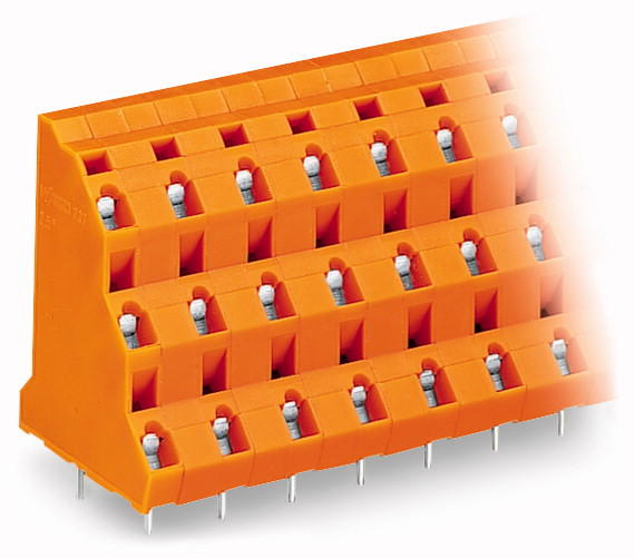

| 737-102, 3 уров. клемма для печатных плат, 3 вывода под пайку, в линию 2X3-конт., шаг 5 мм | |||

| Parameters / Models | 737-102  | 737-103  | 737-104  | 737-106  | 737-108  | 737-112  | 737-116  | 737-124  | 737-202  | 737-203  | 737-204  | 737-206  | 737-208  | 737-212  | 737-216  | 737-224  | 737-302  | 737-303  | 737-304  | 737-306  | 737-308  | 737-312  | 737-316  | 737-324  | 737-402  | 737-403  | 737-404  | 737-406  | 737-408  | 737-412  | 737-416  | 737-424  | 737-502  | 737-503  | 737-504  | 737-505  | 737-506  | 737-508  | 737-512  | 737-516  | 737-552  | 737-553  | 737-554  | 737-556  | 737-558  | 737-562  | 737-566  | 737-602  | 737-603  | 737-604  | 737-606  | 737-608  | 737-612  | 737-616  | 737-652  | 737-653  | 737-654  | 737-656  | 737-658  | 737-662  | 737-666  | 737-702  | 737-703  | 737-704  | 737-706  | 737-708  | 737-712  | 737-752  | 737-753  | 737-754  | 737-756  | 737-758  | 737-762  | 737-802  | 737-803  | 737-804  | 737-806  | 737-808  | 737-812  | 737-852  | 737-853  | 737-854  | 737-856  | 737-858  | 737-862  |
| Actuation type | Operating tool | Operating tool | Operating tool | Operating tool | Operating tool | Operating tool | Operating tool | Operating tool | Operating tool | Operating tool | Operating tool | Operating tool | Operating tool | Operating tool | Operating tool | Operating tool | Operating tool | Operating tool | Operating tool | Operating tool | Operating tool | Operating tool | Operating tool | Operating tool | Operating tool | Operating tool | Operating tool | Operating tool | Operating tool | Operating tool | Operating tool | Operating tool | Operating tool | Operating tool | Operating tool | Operating tool | Operating tool | Operating tool | Operating tool | Operating tool | Operating tool | Operating tool | Operating tool | Operating tool | Operating tool | Operating tool | Operating tool | Operating tool | Operating tool | Operating tool | Operating tool | Operating tool | Operating tool | Operating tool | Operating tool | Operating tool | Operating tool | Operating tool | Operating tool | Operating tool | Operating tool | Operating tool | Operating tool | Operating tool | Operating tool | Operating tool | Operating tool | Operating tool | Operating tool | Operating tool | Operating tool | Operating tool | Operating tool | Operating tool | Operating tool | Operating tool | Operating tool | Operating tool | Operating tool | Operating tool | Operating tool | Operating tool | Operating tool | Operating tool | Operating tool |
| Clamping spring material | Chrome nickel spring steel (CrNi) | Chrome nickel spring steel (CrNi) | Chrome nickel spring steel (CrNi) | Chrome nickel spring steel (CrNi) | Chrome nickel spring steel (CrNi) | Chrome nickel spring steel (CrNi) | Chrome nickel spring steel (CrNi) | Chrome nickel spring steel (CrNi) | Chrome nickel spring steel (CrNi) | Chrome nickel spring steel (CrNi) | Chrome nickel spring steel (CrNi) | Chrome nickel spring steel (CrNi) | Chrome nickel spring steel (CrNi) | Chrome nickel spring steel (CrNi) | Chrome nickel spring steel (CrNi) | Chrome nickel spring steel (CrNi) | Chrome nickel spring steel (CrNi) | Chrome nickel spring steel (CrNi) | Chrome nickel spring steel (CrNi) | Chrome nickel spring steel (CrNi) | Chrome nickel spring steel (CrNi) | Chrome nickel spring steel (CrNi) | Chrome nickel spring steel (CrNi) | Chrome nickel spring steel (CrNi) | Chrome nickel spring steel (CrNi) | Chrome nickel spring steel (CrNi) | Chrome nickel spring steel (CrNi) | Chrome nickel spring steel (CrNi) | Chrome nickel spring steel (CrNi) | Chrome nickel spring steel (CrNi) | Chrome nickel spring steel (CrNi) | Chrome nickel spring steel (CrNi) | Chrome nickel spring steel (CrNi) | Chrome nickel spring steel (CrNi) | Chrome nickel spring steel (CrNi) | Chrome nickel spring steel (CrNi) | Chrome nickel spring steel (CrNi) | Chrome nickel spring steel (CrNi) | Chrome nickel spring steel (CrNi) | Chrome nickel spring steel (CrNi) | Chrome nickel spring steel (CrNi) | Chrome nickel spring steel (CrNi) | Chrome nickel spring steel (CrNi) | Chrome nickel spring steel (CrNi) | Chrome nickel spring steel (CrNi) | Chrome nickel spring steel (CrNi) | Chrome nickel spring steel (CrNi) | Chrome nickel spring steel (CrNi) | Chrome nickel spring steel (CrNi) | Chrome nickel spring steel (CrNi) | Chrome nickel spring steel (CrNi) | Chrome nickel spring steel (CrNi) | Chrome nickel spring steel (CrNi) | Chrome nickel spring steel (CrNi) | Chrome nickel spring steel (CrNi) | Chrome nickel spring steel (CrNi) | Chrome nickel spring steel (CrNi) | Chrome nickel spring steel (CrNi) | Chrome nickel spring steel (CrNi) | Chrome nickel spring steel (CrNi) | Chrome nickel spring steel (CrNi) | Chrome nickel spring steel (CrNi) | Chrome nickel spring steel (CrNi) | Chrome nickel spring steel (CrNi) | Chrome nickel spring steel (CrNi) | Chrome nickel spring steel (CrNi) | Chrome nickel spring steel (CrNi) | Chrome nickel spring steel (CrNi) | Chrome nickel spring steel (CrNi) | Chrome nickel spring steel (CrNi) | Chrome nickel spring steel (CrNi) | Chrome nickel spring steel (CrNi) | Chrome nickel spring steel (CrNi) | Chrome nickel spring steel (CrNi) | Chrome nickel spring steel (CrNi) | Chrome nickel spring steel (CrNi) | Chrome nickel spring steel (CrNi) | Chrome nickel spring steel (CrNi) | Chrome nickel spring steel (CrNi) | Chrome nickel spring steel (CrNi) | Chrome nickel spring steel (CrNi) | Chrome nickel spring steel (CrNi) | Chrome nickel spring steel (CrNi) | Chrome nickel spring steel (CrNi) | Chrome nickel spring steel (CrNi) |
| Цвет | gray | gray | gray | gray | gray | gray | gray | gray | gray | gray | gray | gray | gray | gray | gray | gray | orange | orange | orange | orange | orange | orange | orange | orange | orange | orange | orange | orange | orange | orange | orange | orange | gray | gray | gray | gray | gray | gray | gray | gray | gray | gray | gray | gray | gray | gray | gray | orange | orange | orange | orange | orange | orange | orange | orange | orange | orange | orange | orange | orange | orange | gray | gray | gray | gray | gray | gray | gray | gray | gray | gray | gray | gray | orange | orange | orange | orange | orange | orange | orange | orange | orange | orange | orange | orange |
| Conductor entry angle to the PCB, ° | 45 | 45 | 45 | 45 | 45 | 45 | 45 | 45 | 45 | 45 | 45 | 45 | 45 | 45 | 45 | 45 | 45 | 45 | 45 | 45 | 45 | 45 | 45 | 45 | 45 | 45 | 45 | 45 | 45 | 45 | 45 | 45 | 45 | 45 | 45 | 45 | 45 | 45 | 45 | 45 | 45 | 45 | 45 | 45 | 45 | 45 | 45 | 45 | 45 | 45 | 45 | 45 | 45 | 45 | 45 | 45 | 45 | 45 | 45 | 45 | 45 | 45 | 45 | 45 | 45 | 45 | 45 | 45 | 45 | 45 | 45 | 45 | 45 | 45 | 45 | 45 | 45 | 45 | 45 | 45 | 45 | 45 | 45 | 45 | 45 |
| Connection technology | CAGE CLAMP® | CAGE CLAMP® | CAGE CLAMP® | CAGE CLAMP® | CAGE CLAMP® | CAGE CLAMP® | CAGE CLAMP® | CAGE CLAMP® | CAGE CLAMP® | CAGE CLAMP® | CAGE CLAMP® | CAGE CLAMP® | CAGE CLAMP® | CAGE CLAMP® | CAGE CLAMP® | CAGE CLAMP® | CAGE CLAMP® | CAGE CLAMP® | CAGE CLAMP® | CAGE CLAMP® | CAGE CLAMP® | CAGE CLAMP® | CAGE CLAMP® | CAGE CLAMP® | CAGE CLAMP® | CAGE CLAMP® | CAGE CLAMP® | CAGE CLAMP® | CAGE CLAMP® | CAGE CLAMP® | CAGE CLAMP® | CAGE CLAMP® | CAGE CLAMP® | CAGE CLAMP® | CAGE CLAMP® | CAGE CLAMP® | CAGE CLAMP® | CAGE CLAMP® | CAGE CLAMP® | CAGE CLAMP® | CAGE CLAMP® | CAGE CLAMP® | CAGE CLAMP® | CAGE CLAMP® | CAGE CLAMP® | CAGE CLAMP® | CAGE CLAMP® | CAGE CLAMP® | CAGE CLAMP® | CAGE CLAMP® | CAGE CLAMP® | CAGE CLAMP® | CAGE CLAMP® | CAGE CLAMP® | CAGE CLAMP® | CAGE CLAMP® | CAGE CLAMP® | CAGE CLAMP® | CAGE CLAMP® | CAGE CLAMP® | CAGE CLAMP® | CAGE CLAMP® | CAGE CLAMP® | CAGE CLAMP® | CAGE CLAMP® | CAGE CLAMP® | CAGE CLAMP® | CAGE CLAMP® | CAGE CLAMP® | CAGE CLAMP® | CAGE CLAMP® | CAGE CLAMP® | CAGE CLAMP® | CAGE CLAMP® | CAGE CLAMP® | CAGE CLAMP® | CAGE CLAMP® | CAGE CLAMP® | CAGE CLAMP® | CAGE CLAMP® | CAGE CLAMP® | CAGE CLAMP® | CAGE CLAMP® | CAGE CLAMP® | CAGE CLAMP® |
| Contact material | Electrolytic copper (Ecu) | Electrolytic copper (Ecu) | Electrolytic copper (Ecu) | Electrolytic copper (Ecu) | Electrolytic copper (Ecu) | Electrolytic copper (Ecu) | Electrolytic copper (Ecu) | Electrolytic copper (Ecu) | Electrolytic copper (Ecu) | Electrolytic copper (Ecu) | Electrolytic copper (Ecu) | Electrolytic copper (Ecu) | Electrolytic copper (Ecu) | Electrolytic copper (Ecu) | Electrolytic copper (Ecu) | Electrolytic copper (Ecu) | Electrolytic copper (Ecu) | Electrolytic copper (Ecu) | Electrolytic copper (Ecu) | Electrolytic copper (Ecu) | Electrolytic copper (Ecu) | Electrolytic copper (Ecu) | Electrolytic copper (Ecu) | Electrolytic copper (Ecu) | Electrolytic copper (Ecu) | Electrolytic copper (Ecu) | Electrolytic copper (Ecu) | Electrolytic copper (Ecu) | Electrolytic copper (Ecu) | Electrolytic copper (Ecu) | Electrolytic copper (Ecu) | Electrolytic copper (Ecu) | Electrolytic copper (Ecu) | Electrolytic copper (Ecu) | Electrolytic copper (Ecu) | Electrolytic copper (Ecu) | Electrolytic copper (Ecu) | Electrolytic copper (Ecu) | Electrolytic copper (Ecu) | Electrolytic copper (Ecu) | Electrolytic copper (Ecu) | Electrolytic copper (Ecu) | Electrolytic copper (Ecu) | Electrolytic copper (Ecu) | Electrolytic copper (Ecu) | Electrolytic copper (Ecu) | Electrolytic copper (Ecu) | Electrolytic copper (Ecu) | Electrolytic copper (Ecu) | Electrolytic copper (Ecu) | Electrolytic copper (Ecu) | Electrolytic copper (Ecu) | Electrolytic copper (Ecu) | Electrolytic copper (Ecu) | Electrolytic copper (Ecu) | Electrolytic copper (Ecu) | Electrolytic copper (Ecu) | Electrolytic copper (Ecu) | Electrolytic copper (Ecu) | Electrolytic copper (Ecu) | Electrolytic copper (Ecu) | Electrolytic copper (Ecu) | Electrolytic copper (Ecu) | Electrolytic copper (Ecu) | Electrolytic copper (Ecu) | Electrolytic copper (Ecu) | Electrolytic copper (Ecu) | Electrolytic copper (Ecu) | Electrolytic copper (Ecu) | Electrolytic copper (Ecu) | Electrolytic copper (Ecu) | Electrolytic copper (Ecu) | Electrolytic copper (Ecu) | Electrolytic copper (Ecu) | Electrolytic copper (Ecu) | Electrolytic copper (Ecu) | Electrolytic copper (Ecu) | Electrolytic copper (Ecu) | Electrolytic copper (Ecu) | Electrolytic copper (Ecu) | Electrolytic copper (Ecu) | Electrolytic copper (Ecu) | Electrolytic copper (Ecu) | Electrolytic copper (Ecu) | Electrolytic copper (Ecu) |
| Contact plating | tin-plated | tin-plated | tin-plated | tin-plated | tin-plated | tin-plated | tin-plated | tin-plated | tin-plated | tin-plated | tin-plated | tin-plated | tin-plated | tin-plated | tin-plated | tin-plated | tin-plated | tin-plated | tin-plated | tin-plated | tin-plated | tin-plated | tin-plated | tin-plated | tin-plated | tin-plated | tin-plated | tin-plated | tin-plated | tin-plated | tin-plated | tin-plated | tin-plated | tin-plated | tin-plated | tin-plated | tin-plated | tin-plated | tin-plated | tin-plated | tin-plated | tin-plated | tin-plated | tin-plated | tin-plated | tin-plated | tin-plated | tin-plated | tin-plated | tin-plated | tin-plated | tin-plated | tin-plated | tin-plated | tin-plated | tin-plated | tin-plated | tin-plated | tin-plated | tin-plated | tin-plated | tin-plated | tin-plated | tin-plated | tin-plated | tin-plated | tin-plated | tin-plated | tin-plated | tin-plated | tin-plated | tin-plated | tin-plated | tin-plated | tin-plated | tin-plated | tin-plated | tin-plated | tin-plated | tin-plated | tin-plated | tin-plated | tin-plated | tin-plated | tin-plated |
| Country of origin | PL | PL | PL | PL | PL | PL | PL | PL | PL | PL | PL | PL | PL | PL | PL | PL | PL | PL | PL | PL | PL | PL | PL | PL | PL | PL | PL | PL | PL | PL | PL | PL | PL | PL | PL | PL | PL | PL | PL | PL | PL | PL | PL | PL | PL | PL | PL | PL | PL | PL | PL | PL | PL | PL | PL | PL | PL | PL | PL | PL | PL | PL | PL | PL | PL | PL | PL | PL | PL | PL | PL | PL | PL | PL | PL | PL | PL | PL | PL | PL | PL | PL | PL | PL | PL |
| Габариты: глубина | 31 mm / 1.22 inch | 31 mm / 1.22 inch | 31 mm / 1.22 inch | 31 mm / 1.22 inch | 31 mm / 1.22 inch | 31 mm / 1.22 inch | 31 mm / 1.22 inch | 31 mm / 1.22 inch | 31 mm / 1.22 inch | 31 mm / 1.22 inch | 31 mm / 1.22 inch | 31 mm / 1.22 inch | 31 mm / 1.22 inch | 31 mm / 1.22 inch | 31 mm / 1.22 inch | 31 mm / 1.22 inch | 31 mm / 1.22 inch | 31 mm / 1.22 inch | 31 mm / 1.22 inch | 31 mm / 1.22 inch | 31 mm / 1.22 inch | 31 mm / 1.22 inch | 31 mm / 1.22 inch | 31 mm / 1.22 inch | 31 mm / 1.22 inch | 31 mm / 1.22 inch | 31 mm / 1.22 inch | 31 mm / 1.22 inch | 31 mm / 1.22 inch | 31 mm / 1.22 inch | 31 mm / 1.22 inch | 31 mm / 1.22 inch | 31 mm / 1.22 inch | 31 mm / 1.22 inch | 31 mm / 1.22 inch | 31 mm / 1.22 inch | 31 mm / 1.22 inch | 31 mm / 1.22 inch | 31 mm / 1.22 inch | 31 mm / 1.22 inch | 31 mm / 1.22 inch | 31 mm / 1.22 inch | 31 mm / 1.22 inch | 31 mm / 1.22 inch | 31 mm / 1.22 inch | 31 mm / 1.22 inch | 31 mm / 1.22 inch | 31 mm / 1.22 inch | 31 mm / 1.22 inch | 31 mm / 1.22 inch | 31 mm / 1.22 inch | 31 mm / 1.22 inch | 31 mm / 1.22 inch | 31 mm / 1.22 inch | 31 mm / 1.22 inch | 31 mm / 1.22 inch | 31 mm / 1.22 inch | 31 mm / 1.22 inch | 31 mm / 1.22 inch | 31 mm / 1.22 inch | 31 mm / 1.22 inch | 31 mm / 1.22 inch | 31 mm / 1.22 inch | 31 mm / 1.22 inch | 31 mm / 1.22 inch | 31 mm / 1.22 inch | 31 mm / 1.22 inch | 31 mm / 1.22 inch | 31 mm / 1.22 inch | 31 mm / 1.22 inch | 31 mm / 1.22 inch | 31 mm / 1.22 inch | 31 mm / 1.22 inch | 31 mm / 1.22 inch | 31 mm / 1.22 inch | 31 mm / 1.22 inch | 31 mm / 1.22 inch | 31 mm / 1.22 inch | 31 mm / 1.22 inch | 31 mm / 1.22 inch | 31 mm / 1.22 inch | 31 mm / 1.22 inch | 31 mm / 1.22 inch | 31 mm / 1.22 inch | 31 mm / 1.22 inch |
| Drilled hole diameter (tolerance), мм | 1.3(+ 0.1) | 1.3(+ 0.1) | 1.3(+ 0.1) | 1.3(+ 0.1) | 1.3(+ 0.1) | 1.3(+ 0.1) | 1.3(+ 0.1) | 1.3(+ 0.1) | 1.3(+ 0.1) | 1.3(+ 0.1) | 1.3(+ 0.1) | 1.3(+ 0.1) | 1.3(+ 0.1) | 1.3(+ 0.1) | 1.3(+ 0.1) | 1.3(+ 0.1) | 1.3(+ 0.1) | 1.3(+ 0.1) | 1.3(+ 0.1) | 1.3(+ 0.1) | 1.3(+ 0.1) | 1.3(+ 0.1) | 1.3(+ 0.1) | 1.3(+ 0.1) | 1.3(+ 0.1) | 1.3(+ 0.1) | 1.3(+ 0.1) | 1.3(+ 0.1) | 1.3(+ 0.1) | 1.3(+ 0.1) | 1.3(+ 0.1) | 1.3(+ 0.1) | 1.3(+ 0.1) | 1.3(+ 0.1) | 1.3(+ 0.1) | 1.3(+ 0.1) | 1.3(+ 0.1) | 1.3(+ 0.1) | 1.3(+ 0.1) | 1.3(+ 0.1) | 1.3(+ 0.1) | 1.3(+ 0.1) | 1.3(+ 0.1) | 1.3(+ 0.1) | 1.3(+ 0.1) | 1.3(+ 0.1) | 1.3(+ 0.1) | 1.3(+ 0.1) | 1.3(+ 0.1) | 1.3(+ 0.1) | 1.3(+ 0.1) | 1.3(+ 0.1) | 1.3(+ 0.1) | 1.3(+ 0.1) | 1.3(+ 0.1) | 1.3(+ 0.1) | 1.3(+ 0.1) | 1.3(+ 0.1) | 1.3(+ 0.1) | 1.3(+ 0.1) | 1.3(+ 0.1) | 1.3(+ 0.1) | 1.3(+ 0.1) | 1.3(+ 0.1) | 1.3(+ 0.1) | 1.3(+ 0.1) | 1.3(+ 0.1) | 1.3(+ 0.1) | 1.3(+ 0.1) | 1.3(+ 0.1) | 1.3(+ 0.1) | 1.3(+ 0.1) | 1.3(+ 0.1) | 1.3(+ 0.1) | 1.3(+ 0.1) | 1.3(+ 0.1) | 1.3(+ 0.1) | 1.3(+ 0.1) | 1.3(+ 0.1) | 1.3(+ 0.1) | 1.3(+ 0.1) | 1.3(+ 0.1) | 1.3(+ 0.1) | 1.3(+ 0.1) | 1.3(+ 0.1) |
| Fine-stranded conductor | 0.08 … 2.5 mm² / 28 … 12 AWG | 0.08 … 2.5 mm² / 28 … 12 AWG | 0.08 … 2.5 mm² / 28 … 12 AWG | 0.08 … 2.5 mm² / 28 … 12 AWG | 0.08 … 2.5 mm² / 28 … 12 AWG | 0.08 … 2.5 mm² / 28 … 12 AWG | 0.08 … 2.5 mm² / 28 … 12 AWG | 0.08 … 2.5 mm² / 28 … 12 AWG | 0.08 … 2.5 mm² / 28 … 12 AWG | 0.08 … 2.5 mm² / 28 … 12 AWG | 0.08 … 2.5 mm² / 28 … 12 AWG | 0.08 … 2.5 mm² / 28 … 12 AWG | 0.08 … 2.5 mm² / 28 … 12 AWG | 0.08 … 2.5 mm² / 28 … 12 AWG | 0.08 … 2.5 mm² / 28 … 12 AWG | 0.08 … 2.5 mm² / 28 … 12 AWG | 0.08 … 2.5 mm² / 28 … 12 AWG | 0.08 … 2.5 mm² / 28 … 12 AWG | 0.08 … 2.5 mm² / 28 … 12 AWG | 0.08 … 2.5 mm² / 28 … 12 AWG | 0.08 … 2.5 mm² / 28 … 12 AWG | 0.08 … 2.5 mm² / 28 … 12 AWG | 0.08 … 2.5 mm² / 28 … 12 AWG | 0.08 … 2.5 mm² / 28 … 12 AWG | 0.08 … 2.5 mm² / 28 … 12 AWG | 0.08 … 2.5 mm² / 28 … 12 AWG | 0.08 … 2.5 mm² / 28 … 12 AWG | 0.08 … 2.5 mm² / 28 … 12 AWG | 0.08 … 2.5 mm² / 28 … 12 AWG | 0.08 … 2.5 mm² / 28 … 12 AWG | 0.08 … 2.5 mm² / 28 … 12 AWG | 0.08 … 2.5 mm² / 28 … 12 AWG | 0.08 … 2.5 mm² / 28 … 12 AWG | 0.08 … 2.5 mm² / 28 … 12 AWG | 0.08 … 2.5 mm² / 28 … 12 AWG | 0.08 … 2.5 mm² / 28 … 12 AWG | 0.08 … 2.5 mm² / 28 … 12 AWG | 0.08 … 2.5 mm² / 28 … 12 AWG | 0.08 … 2.5 mm² / 28 … 12 AWG | 0.08 … 2.5 mm² / 28 … 12 AWG | 0.08 … 2.5 mm² / 28 … 12 AWG | 0.08 … 2.5 mm² / 28 … 12 AWG | 0.08 … 2.5 mm² / 28 … 12 AWG | 0.08 … 2.5 mm² / 28 … 12 AWG | 0.08 … 2.5 mm² / 28 … 12 AWG | 0.08 … 2.5 mm² / 28 … 12 AWG | 0.08 … 2.5 mm² / 28 … 12 AWG | 0.08 … 2.5 mm² / 28 … 12 AWG | 0.08 … 2.5 mm² / 28 … 12 AWG | 0.08 … 2.5 mm² / 28 … 12 AWG | 0.08 … 2.5 mm² / 28 … 12 AWG | 0.08 … 2.5 mm² / 28 … 12 AWG | 0.08 … 2.5 mm² / 28 … 12 AWG | 0.08 … 2.5 mm² / 28 … 12 AWG | 0.08 … 2.5 mm² / 28 … 12 AWG | 0.08 … 2.5 mm² / 28 … 12 AWG | 0.08 … 2.5 mm² / 28 … 12 AWG | 0.08 … 2.5 mm² / 28 … 12 AWG | 0.08 … 2.5 mm² / 28 … 12 AWG | 0.08 … 2.5 mm² / 28 … 12 AWG | 0.08 … 2.5 mm² / 28 … 12 AWG | 0.08 … 2.5 mm² / 28 … 12 AWG | 0.08 … 2.5 mm² / 28 … 12 AWG | 0.08 … 2.5 mm² / 28 … 12 AWG | 0.08 … 2.5 mm² / 28 … 12 AWG | 0.08 … 2.5 mm² / 28 … 12 AWG | 0.08 … 2.5 mm² / 28 … 12 AWG | 0.08 … 2.5 mm² / 28 … 12 AWG | 0.08 … 2.5 mm² / 28 … 12 AWG | 0.08 … 2.5 mm² / 28 … 12 AWG | 0.08 … 2.5 mm² / 28 … 12 AWG | 0.08 … 2.5 mm² / 28 … 12 AWG | 0.08 … 2.5 mm² / 28 … 12 AWG | 0.08 … 2.5 mm² / 28 … 12 AWG | 0.08 … 2.5 mm² / 28 … 12 AWG | 0.08 … 2.5 mm² / 28 … 12 AWG | 0.08 … 2.5 mm² / 28 … 12 AWG | 0.08 … 2.5 mm² / 28 … 12 AWG | 0.08 … 2.5 mm² / 28 … 12 AWG | 0.08 … 2.5 mm² / 28 … 12 AWG | 0.08 … 2.5 mm² / 28 … 12 AWG | 0.08 … 2.5 mm² / 28 … 12 AWG | 0.08 … 2.5 mm² / 28 … 12 AWG | 0.08 … 2.5 mm² / 28 … 12 AWG | 0.08 … 2.5 mm² / 28 … 12 AWG |
| Fine-stranded conductor with ferrule with plastic collar | 0.25 … 1.5 mm² | 0.25 … 1.5 mm² | 0.25 … 1.5 mm² | 0.25 … 1.5 mm² | 0.25 … 1.5 mm² | 0.25 … 1.5 mm² | 0.25 … 1.5 mm² | 0.25 … 1.5 mm² | 0.25 … 1.5 mm² | 0.25 … 1.5 mm² | 0.25 … 1.5 mm² | 0.25 … 1.5 mm² | 0.25 … 1.5 mm² | 0.25 … 1.5 mm² | 0.25 … 1.5 mm² | 0.25 … 1.5 mm² | 0.25 … 1.5 mm² | 0.25 … 1.5 mm² | 0.25 … 1.5 mm² | 0.25 … 1.5 mm² | 0.25 … 1.5 mm² | 0.25 … 1.5 mm² | 0.25 … 1.5 mm² | 0.25 … 1.5 mm² | 0.25 … 1.5 mm² | 0.25 … 1.5 mm² | 0.25 … 1.5 mm² | 0.25 … 1.5 mm² | 0.25 … 1.5 mm² | 0.25 … 1.5 mm² | 0.25 … 1.5 mm² | 0.25 … 1.5 mm² | 0.25 … 1.5 mm² | 0.25 … 1.5 mm² | 0.25 … 1.5 mm² | 0.25 … 1.5 mm² | 0.25 … 1.5 mm² | 0.25 … 1.5 mm² | 0.25 … 1.5 mm² | 0.25 … 1.5 mm² | 0.25 … 1.5 mm² | 0.25 … 1.5 mm² | 0.25 … 1.5 mm² | 0.25 … 1.5 mm² | 0.25 … 1.5 mm² | 0.25 … 1.5 mm² | 0.25 … 1.5 mm² | 0.25 … 1.5 mm² | 0.25 … 1.5 mm² | 0.25 … 1.5 mm² | 0.25 … 1.5 mm² | 0.25 … 1.5 mm² | 0.25 … 1.5 mm² | 0.25 … 1.5 mm² | 0.25 … 1.5 mm² | 0.25 … 1.5 mm² | 0.25 … 1.5 mm² | 0.25 … 1.5 mm² | 0.25 … 1.5 mm² | 0.25 … 1.5 mm² | 0.25 … 1.5 mm² | 0.25 … 1.5 mm² | 0.25 … 1.5 mm² | 0.25 … 1.5 mm² | 0.25 … 1.5 mm² | 0.25 … 1.5 mm² | 0.25 … 1.5 mm² | 0.25 … 1.5 mm² | 0.25 … 1.5 mm² | 0.25 … 1.5 mm² | 0.25 … 1.5 mm² | 0.25 … 1.5 mm² | 0.25 … 1.5 mm² | 0.25 … 1.5 mm² | 0.25 … 1.5 mm² | 0.25 … 1.5 mm² | 0.25 … 1.5 mm² | 0.25 … 1.5 mm² | 0.25 … 1.5 mm² | 0.25 … 1.5 mm² | 0.25 … 1.5 mm² | 0.25 … 1.5 mm² | 0.25 … 1.5 mm² | 0.25 … 1.5 mm² | 0.25 … 1.5 mm² |
| Fine-stranded conductor with ferrule without plastic collar | 0.25 … 2.5 mm² | 0.25 … 2.5 mm² | 0.25 … 2.5 mm² | 0.25 … 2.5 mm² | 0.25 … 2.5 mm² | 0.25 … 2.5 mm² | 0.25 … 2.5 mm² | 0.25 … 2.5 mm² | 0.25 … 2.5 mm² | 0.25 … 2.5 mm² | 0.25 … 2.5 mm² | 0.25 … 2.5 mm² | 0.25 … 2.5 mm² | 0.25 … 2.5 mm² | 0.25 … 2.5 mm² | 0.25 … 2.5 mm² | 0.25 … 2.5 mm² | 0.25 … 2.5 mm² | 0.25 … 2.5 mm² | 0.25 … 2.5 mm² | 0.25 … 2.5 mm² | 0.25 … 2.5 mm² | 0.25 … 2.5 mm² | 0.25 … 2.5 mm² | 0.25 … 2.5 mm² | 0.25 … 2.5 mm² | 0.25 … 2.5 mm² | 0.25 … 2.5 mm² | 0.25 … 2.5 mm² | 0.25 … 2.5 mm² | 0.25 … 2.5 mm² | 0.25 … 2.5 mm² | 0.25 … 2.5 mm² | 0.25 … 2.5 mm² | 0.25 … 2.5 mm² | 0.25 … 2.5 mm² | 0.25 … 2.5 mm² | 0.25 … 2.5 mm² | 0.25 … 2.5 mm² | 0.25 … 2.5 mm² | 0.25 … 2.5 mm² | 0.25 … 2.5 mm² | 0.25 … 2.5 mm² | 0.25 … 2.5 mm² | 0.25 … 2.5 mm² | 0.25 … 2.5 mm² | 0.25 … 2.5 mm² | 0.25 … 2.5 mm² | 0.25 … 2.5 mm² | 0.25 … 2.5 mm² | 0.25 … 2.5 mm² | 0.25 … 2.5 mm² | 0.25 … 2.5 mm² | 0.25 … 2.5 mm² | 0.25 … 2.5 mm² | 0.25 … 2.5 mm² | 0.25 … 2.5 mm² | 0.25 … 2.5 mm² | 0.25 … 2.5 mm² | 0.25 … 2.5 mm² | 0.25 … 2.5 mm² | 0.25 … 2.5 mm² | 0.25 … 2.5 mm² | 0.25 … 2.5 mm² | 0.25 … 2.5 mm² | 0.25 … 2.5 mm² | 0.25 … 2.5 mm² | 0.25 … 2.5 mm² | 0.25 … 2.5 mm² | 0.25 … 2.5 mm² | 0.25 … 2.5 mm² | 0.25 … 2.5 mm² | 0.25 … 2.5 mm² | 0.25 … 2.5 mm² | 0.25 … 2.5 mm² | 0.25 … 2.5 mm² | 0.25 … 2.5 mm² | 0.25 … 2.5 mm² | 0.25 … 2.5 mm² | 0.25 … 2.5 mm² | 0.25 … 2.5 mm² | 0.25 … 2.5 mm² | 0.25 … 2.5 mm² | 0.25 … 2.5 mm² | 0.25 … 2.5 mm² |
| Fire load, MJ | 0.14 | 0.199 | 0.258 | 0.376 | 0.494 | 0.73 | 0.966 | 1.438 | 0.14 | 0.199 | 0.258 | 0.376 | 0.494 | 0.73 | 0.966 | 1.438 | 0.141 | 0.199 | 0.257 | 0.373 | 0.489 | 0.721 | 0.953 | 1.417 | 0.141 | 0.199 | 0.257 | 0.373 | 0.489 | 0.721 | 0.953 | 1.417 | 0.159 | 0.237 | 0.315 | 0.471 | 0.627 | 0.939 | 1.251 | 0.159 | 0.237 | 0.315 | 0.471 | 0.627 | 0.939 | 1.251 | 0.16 | 0.237 | 0.314 | 0.468 | 0.622 | 0.93 | 1.238 | 0.16 | 0.237 | 0.314 | 0.468 | 0.622 | 0.93 | 1.238 | 0.177 | 0.273 | 0.369 | 0.561 | 0.753 | 1.137 | 0.177 | 0.273 | 0.369 | 0.561 | 0.753 | 1.233 | 0.182 | 0.281 | 0.38 | 0.578 | 0.776 | 1.172 | 0.182 | 0.281 | 0.38 | 0.578 | 0.776 | 1.172 | |
| Flammability class per UL94 | V0 | V0 | V0 | V0 | V0 | V0 | V0 | V0 | V0 | V0 | V0 | V0 | V0 | V0 | V0 | V0 | V0 | V0 | V0 | V0 | V0 | V0 | V0 | V0 | V0 | V0 | V0 | V0 | V0 | V0 | V0 | V0 | V0 | V0 | V0 | V0 | V0 | V0 | V0 | V0 | V0 | V0 | V0 | V0 | V0 | V0 | V0 | V0 | V0 | V0 | V0 | V0 | V0 | V0 | V0 | V0 | V0 | V0 | V0 | V0 | V0 | V0 | V0 | V0 | V0 | V0 | V0 | V0 | V0 | V0 | V0 | V0 | V0 | V0 | V0 | V0 | V0 | V0 | V0 | V0 | V0 | V0 | V0 | V0 | V0 |
| GTIN | 4045454021566 | 4045454021580 | 4045454021634 | 4045454021689 | 4045454021740 | 4045454021924 | 4045454021979 | 4045454022075 | 4045454019174 | 4045454022723 | 4045454022730 | 4045454022747 | 4045454022754 | 4045454022785 | 4045454022822 | 4045454022921 | 4045454022143 | 4045454018313 | 4045454018337 | 4045454022167 | 4045454022198 | 4045454022259 | 4045454022334 | 4045454018511 | 4045454022952 | 4045454022969 | 4045454022976 | 4045454023010 | 4045454023072 | 4045454023126 | 4045454023300 | 4045454023461 | 4045454018542 | 4045454022440 | 4045454022457 | 4055143494755 | 4045454022464 | 4045454018580 | 4045454018597 | 4045454022471 | 4045454019648 | 4045454019655 | 4045454019662 | 4045454019679 | 4045454019686 | 4045454019693 | 4045454019709 | 4045454018627 | 4045454018634 | 4045454018641 | 4045454018658 | 4045454018665 | 4045454018672 | 4045454022488 | 4045454019730 | 4045454019747 | 4045454019754 | 4045454019761 | 4045454019778 | 4045454019785 | 4045454019792 | 4045454018702 | 4045454022495 | 4045454018726 | 4045454022501 | 4045454022518 | 4045454018757 | 4045454019815 | 4045454019822 | 4045454019839 | 4045454019846 | 4045454019853 | 4045454019860 | 4045454018788 | 4045454018795 | 4045454022525 | 4045454018818 | 4045454018825 | 4045454022532 | 4045454019907 | 4045454019914 | 4045454019921 | 4045454019938 | 4045454019945 | 4045454019952 |
| Height | 44 mm / 1.732 inch | 44 mm / 1.732 inch | 44 mm / 1.732 inch | 44 mm / 1.732 inch | 44 mm / 1.732 inch | 44 mm / 1.732 inch | 44 mm / 1.732 inch | 44 mm / 1.732 inch | 44 mm / 1.732 inch | 44 mm / 1.732 inch | 44 mm / 1.732 inch | 44 mm / 1.732 inch | 44 mm / 1.732 inch | 44 mm / 1.732 inch | 44 mm / 1.732 inch | 44 mm / 1.732 inch | 44 mm / 1.732 inch | 44 mm / 1.732 inch | 44 mm / 1.732 inch | 44 mm / 1.732 inch | 44 mm / 1.732 inch | 44 mm / 1.732 inch | 44 mm / 1.732 inch | 44 mm / 1.732 inch | 44 mm / 1.732 inch | 44 mm / 1.732 inch | 44 mm / 1.732 inch | 44 mm / 1.732 inch | 44 mm / 1.732 inch | 44 mm / 1.732 inch | 44 mm / 1.732 inch | 44 mm / 1.732 inch | 44 mm / 1.732 inch | 44 mm / 1.732 inch | 44 mm / 1.732 inch | 44 mm / 1.732 inch | 44 mm / 1.732 inch | 44 mm / 1.732 inch | 44 mm / 1.732 inch | 44 mm / 1.732 inch | 44 mm / 1.732 inch | 44 mm / 1.732 inch | 44 mm / 1.732 inch | 44 mm / 1.732 inch | 44 mm / 1.732 inch | 44 mm / 1.732 inch | 44 mm / 1.732 inch | 44 mm / 1.732 inch | 44 mm / 1.732 inch | 44 mm / 1.732 inch | 44 mm / 1.732 inch | 44 mm / 1.732 inch | 44 mm / 1.732 inch | 44 mm / 1.732 inch | 44 mm / 1.732 inch | 44 mm / 1.732 inch | 44 mm / 1.732 inch | 44 mm / 1.732 inch | 44 mm / 1.732 inch | 44 mm / 1.732 inch | 44 mm / 1.732 inch | 44 mm / 1.732 inch | 44 mm / 1.732 inch | 44 mm / 1.732 inch | 44 mm / 1.732 inch | 44 mm / 1.732 inch | 44 mm / 1.732 inch | 44 mm / 1.732 inch | 44 mm / 1.732 inch | 44 mm / 1.732 inch | 44 mm / 1.732 inch | 44 mm / 1.732 inch | 44 mm / 1.732 inch | 44 mm / 1.732 inch | 44 mm / 1.732 inch | 44 mm / 1.732 inch | 44 mm / 1.732 inch | 44 mm / 1.732 inch | 44 mm / 1.732 inch | 44 mm / 1.732 inch | 44 mm / 1.732 inch | 44 mm / 1.732 inch | 44 mm / 1.732 inch | 44 mm / 1.732 inch | 44 mm / 1.732 inch |
| Height from the surface | 40 mm / 1.575 inch | 40 mm / 1.575 inch | 40 mm / 1.575 inch | 40 mm / 1.575 inch | 40 mm / 1.575 inch | 40 mm / 1.575 inch | 40 mm / 1.575 inch | 40 mm / 1.575 inch | 40 mm / 1.575 inch | 40 mm / 1.575 inch | 40 mm / 1.575 inch | 40 mm / 1.575 inch | 40 mm / 1.575 inch | 40 mm / 1.575 inch | 40 mm / 1.575 inch | 40 mm / 1.575 inch | 40 mm / 1.575 inch | 40 mm / 1.575 inch | 40 mm / 1.575 inch | 40 mm / 1.575 inch | 40 mm / 1.575 inch | 40 mm / 1.575 inch | 40 mm / 1.575 inch | 40 mm / 1.575 inch | 40 mm / 1.575 inch | 40 mm / 1.575 inch | 40 mm / 1.575 inch | 40 mm / 1.575 inch | 40 mm / 1.575 inch | 40 mm / 1.575 inch | 40 mm / 1.575 inch | 40 mm / 1.575 inch | 40 mm / 1.575 inch | 40 mm / 1.575 inch | 40 mm / 1.575 inch | 40 mm / 1.575 inch | 40 mm / 1.575 inch | 40 mm / 1.575 inch | 40 mm / 1.575 inch | 40 mm / 1.575 inch | 40 mm / 1.575 inch | 40 mm / 1.575 inch | 40 mm / 1.575 inch | 40 mm / 1.575 inch | 40 mm / 1.575 inch | 40 mm / 1.575 inch | 40 mm / 1.575 inch | 40 mm / 1.575 inch | 40 mm / 1.575 inch | 40 mm / 1.575 inch | 40 mm / 1.575 inch | 40 mm / 1.575 inch | 40 mm / 1.575 inch | 40 mm / 1.575 inch | 40 mm / 1.575 inch | 40 mm / 1.575 inch | 40 mm / 1.575 inch | 40 mm / 1.575 inch | 40 mm / 1.575 inch | 40 mm / 1.575 inch | 40 mm / 1.575 inch | 40 mm / 1.575 inch | 40 mm / 1.575 inch | 40 mm / 1.575 inch | 40 mm / 1.575 inch | 40 mm / 1.575 inch | 40 mm / 1.575 inch | 40 mm / 1.575 inch | 40 mm / 1.575 inch | 40 mm / 1.575 inch | 40 mm / 1.575 inch | 40 mm / 1.575 inch | 40 mm / 1.575 inch | 40 mm / 1.575 inch | 40 mm / 1.575 inch | 40 mm / 1.575 inch | 40 mm / 1.575 inch | 40 mm / 1.575 inch | 40 mm / 1.575 inch | 40 mm / 1.575 inch | 40 mm / 1.575 inch | 40 mm / 1.575 inch | 40 mm / 1.575 inch | 40 mm / 1.575 inch | 40 mm / 1.575 inch |
| Insulating material | Polyamide 66 (PA 66) | Polyamide 66 (PA 66) | Polyamide 66 (PA 66) | Polyamide 66 (PA 66) | Polyamide 66 (PA 66) | Polyamide 66 (PA 66) | Polyamide 66 (PA 66) | Polyamide 66 (PA 66) | Polyamide 66 (PA 66) | Polyamide 66 (PA 66) | Polyamide 66 (PA 66) | Polyamide 66 (PA 66) | Polyamide 66 (PA 66) | Polyamide 66 (PA 66) | Polyamide 66 (PA 66) | Polyamide 66 (PA 66) | Polyamide 66 (PA 66) | Polyamide 66 (PA 66) | Polyamide 66 (PA 66) | Polyamide 66 (PA 66) | Polyamide 66 (PA 66) | Polyamide 66 (PA 66) | Polyamide 66 (PA 66) | Polyamide 66 (PA 66) | Polyamide 66 (PA 66) | Polyamide 66 (PA 66) | Polyamide 66 (PA 66) | Polyamide 66 (PA 66) | Polyamide 66 (PA 66) | Polyamide 66 (PA 66) | Polyamide 66 (PA 66) | Polyamide 66 (PA 66) | Polyamide 66 (PA 66) | Polyamide 66 (PA 66) | Polyamide 66 (PA 66) | Polyamide 66 (PA 66) | Polyamide 66 (PA 66) | Polyamide 66 (PA 66) | Polyamide 66 (PA 66) | Polyamide 66 (PA 66) | Polyamide 66 (PA 66) | Polyamide 66 (PA 66) | Polyamide 66 (PA 66) | Polyamide 66 (PA 66) | Polyamide 66 (PA 66) | Polyamide 66 (PA 66) | Polyamide 66 (PA 66) | Polyamide 66 (PA 66) | Polyamide 66 (PA 66) | Polyamide 66 (PA 66) | Polyamide 66 (PA 66) | Polyamide 66 (PA 66) | Polyamide 66 (PA 66) | Polyamide 66 (PA 66) | Polyamide 66 (PA 66) | Polyamide 66 (PA 66) | Polyamide 66 (PA 66) | Polyamide 66 (PA 66) | Polyamide 66 (PA 66) | Polyamide 66 (PA 66) | Polyamide 66 (PA 66) | Polyamide 66 (PA 66) | Polyamide 66 (PA 66) | Polyamide 66 (PA 66) | Polyamide 66 (PA 66) | Polyamide 66 (PA 66) | Polyamide 66 (PA 66) | Polyamide 66 (PA 66) | Polyamide 66 (PA 66) | Polyamide 66 (PA 66) | Polyamide 66 (PA 66) | Polyamide 66 (PA 66) | Polyamide 66 (PA 66) | Polyamide 66 (PA 66) | Polyamide 66 (PA 66) | Polyamide 66 (PA 66) | Polyamide 66 (PA 66) | Polyamide 66 (PA 66) | Polyamide 66 (PA 66) | Polyamide 66 (PA 66) | Polyamide 66 (PA 66) | Polyamide 66 (PA 66) | Polyamide 66 (PA 66) | Polyamide 66 (PA 66) | Polyamide 66 (PA 66) |
| Legend (ratings) | (III / 2) ≙ Overvoltage category III / Pollution degree 2 | (III / 2) ≙ Overvoltage category III / Pollution degree 2 | (III / 2) ≙ Overvoltage category III / Pollution degree 2 | (III / 2) ≙ Overvoltage category III / Pollution degree 2 | (III / 2) ≙ Overvoltage category III / Pollution degree 2 | (III / 2) ≙ Overvoltage category III / Pollution degree 2 | (III / 2) ≙ Overvoltage category III / Pollution degree 2 | (III / 2) ≙ Overvoltage category III / Pollution degree 2 | (III / 2) ≙ Overvoltage category III / Pollution degree 2 | (III / 2) ≙ Overvoltage category III / Pollution degree 2 | (III / 2) ≙ Overvoltage category III / Pollution degree 2 | (III / 2) ≙ Overvoltage category III / Pollution degree 2 | (III / 2) ≙ Overvoltage category III / Pollution degree 2 | (III / 2) ≙ Overvoltage category III / Pollution degree 2 | (III / 2) ≙ Overvoltage category III / Pollution degree 2 | (III / 2) ≙ Overvoltage category III / Pollution degree 2 | (III / 2) ≙ Overvoltage category III / Pollution degree 2 | (III / 2) ≙ Overvoltage category III / Pollution degree 2 | (III / 2) ≙ Overvoltage category III / Pollution degree 2 | (III / 2) ≙ Overvoltage category III / Pollution degree 2 | (III / 2) ≙ Overvoltage category III / Pollution degree 2 | (III / 2) ≙ Overvoltage category III / Pollution degree 2 | (III / 2) ≙ Overvoltage category III / Pollution degree 2 | (III / 2) ≙ Overvoltage category III / Pollution degree 2 | (III / 2) ≙ Overvoltage category III / Pollution degree 2 | (III / 2) ≙ Overvoltage category III / Pollution degree 2 | (III / 2) ≙ Overvoltage category III / Pollution degree 2 | (III / 2) ≙ Overvoltage category III / Pollution degree 2 | (III / 2) ≙ Overvoltage category III / Pollution degree 2 | (III / 2) ≙ Overvoltage category III / Pollution degree 2 | (III / 2) ≙ Overvoltage category III / Pollution degree 2 | (III / 2) ≙ Overvoltage category III / Pollution degree 2 | (III / 2) ≙ Overvoltage category III / Pollution degree 2 | (III / 2) ≙ Overvoltage category III / Pollution degree 2 | (III / 2) ≙ Overvoltage category III / Pollution degree 2 | (III / 2) ≙ Overvoltage category III / Pollution degree 2 | (III / 2) ≙ Overvoltage category III / Pollution degree 2 | (III / 2) ≙ Overvoltage category III / Pollution degree 2 | (III / 2) ≙ Overvoltage category III / Pollution degree 2 | (III / 2) ≙ Overvoltage category III / Pollution degree 2 | (III / 2) ≙ Overvoltage category III / Pollution degree 2 | (III / 2) ≙ Overvoltage category III / Pollution degree 2 | (III / 2) ≙ Overvoltage category III / Pollution degree 2 | (III / 2) ≙ Overvoltage category III / Pollution degree 2 | (III / 2) ≙ Overvoltage category III / Pollution degree 2 | (III / 2) ≙ Overvoltage category III / Pollution degree 2 | (III / 2) ≙ Overvoltage category III / Pollution degree 2 | (III / 2) ≙ Overvoltage category III / Pollution degree 2 | (III / 2) ≙ Overvoltage category III / Pollution degree 2 | (III / 2) ≙ Overvoltage category III / Pollution degree 2 | (III / 2) ≙ Overvoltage category III / Pollution degree 2 | (III / 2) ≙ Overvoltage category III / Pollution degree 2 | (III / 2) ≙ Overvoltage category III / Pollution degree 2 | (III / 2) ≙ Overvoltage category III / Pollution degree 2 | (III / 2) ≙ Overvoltage category III / Pollution degree 2 | (III / 2) ≙ Overvoltage category III / Pollution degree 2 | (III / 2) ≙ Overvoltage category III / Pollution degree 2 | (III / 2) ≙ Overvoltage category III / Pollution degree 2 | (III / 2) ≙ Overvoltage category III / Pollution degree 2 | (III / 2) ≙ Overvoltage category III / Pollution degree 2 | (III / 2) ≙ Overvoltage category III / Pollution degree 2 | (III / 2) ≙ Overvoltage category III / Pollution degree 2 | (III / 2) ≙ Overvoltage category III / Pollution degree 2 | (III / 2) ≙ Overvoltage category III / Pollution degree 2 | (III / 2) ≙ Overvoltage category III / Pollution degree 2 | (III / 2) ≙ Overvoltage category III / Pollution degree 2 | (III / 2) ≙ Overvoltage category III / Pollution degree 2 | (III / 2) ≙ Overvoltage category III / Pollution degree 2 | (III / 2) ≙ Overvoltage category III / Pollution degree 2 | (III / 2) ≙ Overvoltage category III / Pollution degree 2 | (III / 2) ≙ Overvoltage category III / Pollution degree 2 | (III / 2) ≙ Overvoltage category III / Pollution degree 2 | (III / 2) ≙ Overvoltage category III / Pollution degree 2 | (III / 2) ≙ Overvoltage category III / Pollution degree 2 | (III / 2) ≙ Overvoltage category III / Pollution degree 2 | (III / 2) ≙ Overvoltage category III / Pollution degree 2 | (III / 2) ≙ Overvoltage category III / Pollution degree 2 | (III / 2) ≙ Overvoltage category III / Pollution degree 2 | (III / 2) ≙ Overvoltage category III / Pollution degree 2 | (III / 2) ≙ Overvoltage category III / Pollution degree 2 | (III / 2) ≙ Overvoltage category III / Pollution degree 2 | (III / 2) ≙ Overvoltage category III / Pollution degree 2 | (III / 2) ≙ Overvoltage category III / Pollution degree 2 | (III / 2) ≙ Overvoltage category III / Pollution degree 2 | (III / 2) ≙ Overvoltage category III / Pollution degree 2 |
| Limit temperature range | -60 … +105 °C | -60 … +105 °C | -60 … +105 °C | -60 … +105 °C | -60 … +105 °C | -60 … +105 °C | -60 … +105 °C | -60 … +105 °C | -60 … +105 °C | -60 … +105 °C | -60 … +105 °C | -60 … +105 °C | -60 … +105 °C | -60 … +105 °C | -60 … +105 °C | -60 … +105 °C | -60 … +105 °C | -60 … +105 °C | -60 … +105 °C | -60 … +105 °C | -60 … +105 °C | -60 … +105 °C | -60 … +105 °C | -60 … +105 °C | -60 … +105 °C | -60 … +105 °C | -60 … +105 °C | -60 … +105 °C | -60 … +105 °C | -60 … +105 °C | -60 … +105 °C | -60 … +105 °C | -60 … +105 °C | -60 … +105 °C | -60 … +105 °C | -60 … +105 °C | -60 … +105 °C | -60 … +105 °C | -60 … +105 °C | -60 … +105 °C | -60 … +105 °C | -60 … +105 °C | -60 … +105 °C | -60 … +105 °C | -60 … +105 °C | -60 … +105 °C | -60 … +105 °C | -60 … +105 °C | -60 … +105 °C | -60 … +105 °C | -60 … +105 °C | -60 … +105 °C | -60 … +105 °C | -60 … +105 °C | -60 … +105 °C | -60 … +105 °C | -60 … +105 °C | -60 … +105 °C | -60 … +105 °C | -60 … +105 °C | -60 … +105 °C | -60 … +105 °C | -60 … +105 °C | -60 … +105 °C | -60 … +105 °C | -60 … +105 °C | -60 … +105 °C | -60 … +105 °C | -60 … +105 °C | -60 … +105 °C | -60 … +105 °C | -60 … +105 °C | -60 … +105 °C | -60 … +105 °C | -60 … +105 °C | -60 … +105 °C | -60 … +105 °C | -60 … +105 °C | -60 … +105 °C | -60 … +105 °C | -60 … +105 °C | -60 … +105 °C | -60 … +105 °C | -60 … +105 °C | -60 … +105 °C |
| Material group | I | I | I | I | I | I | I | I | I | I | I | I | I | I | I | I | I | I | I | I | I | I | I | I | I | I | I | I | I | I | I | I | I | I | I | I | I | I | I | I | I | I | I | I | I | I | I | I | I | I | I | I | I | I | I | I | I | I | I | I | I | I | I | I | I | I | I | I | I | I | I | I | I | I | I | I | I | I | I | I | I | I | I | I | I |
| Number of Poles | 2 | 3 | 4 | 6 | 8 | 12 | 16 | 24 | 2 | 3 | 4 | 6 | 8 | 12 | 16 | 24 | 2 | 3 | 4 | 6 | 8 | 12 | 16 | 24 | 2 | 3 | 4 | 6 | 8 | 12 | 16 | 24 | 2 | 3 | 4 | 5 | 6 | 8 | 12 | 16 | 2 | 3 | 4 | 6 | 8 | 12 | 16 | 2 | 3 | 4 | 6 | 8 | 12 | 16 | 2 | 3 | 4 | 6 | 8 | 12 | 16 | 2 | 3 | 4 | 6 | 8 | 12 | 2 | 3 | 4 | 6 | 8 | 12 | 2 | 3 | 4 | 6 | 8 | 12 | 2 | 3 | 4 | 6 | 8 | 12 |
| Number of connection types | 1 | 1 | 1 | 1 | 1 | 1 | 1 | 1 | 1 | 1 | 1 | 1 | 1 | 1 | 1 | 1 | 1 | 1 | 1 | 1 | 1 | 1 | 1 | 1 | 1 | 1 | 1 | 1 | 1 | 1 | 1 | 1 | 1 | 1 | 1 | 1 | 1 | 1 | 1 | 1 | 1 | 1 | 1 | 1 | 1 | 1 | 1 | 1 | 1 | 1 | 1 | 1 | 1 | 1 | 1 | 1 | 1 | 1 | 1 | 1 | 1 | 1 | 1 | 1 | 1 | 1 | 1 | 1 | 1 | 1 | 1 | 1 | 1 | 1 | 1 | 1 | 1 | 1 | 1 | 1 | 1 | 1 | 1 | 1 | 1 |
| Number of levels | 3 | 3 | 3 | 3 | 3 | 3 | 3 | 3 | 3 | 3 | 3 | 3 | 3 | 3 | 3 | 3 | 3 | 3 | 3 | 3 | 3 | 3 | 3 | 3 | 3 | 3 | 3 | 3 | 3 | 3 | 3 | 3 | 3 | 3 | 3 | 3 | 3 | 3 | 3 | 3 | 3 | 3 | 3 | 3 | 3 | 3 | 3 | 3 | 3 | 3 | 3 | 3 | 3 | 3 | 3 | 3 | 3 | 3 | 3 | 3 | 3 | 3 | 3 | 3 | 3 | 3 | 3 | 3 | 3 | 3 | 3 | 3 | 3 | 3 | 3 | 3 | 3 | 3 | 3 | 3 | 3 | 3 | 3 | 3 | 3 |
| Number of solder pins per potential | 1 | 1 | 1 | 1 | 1 | 1 | 1 | 1 | 1 | 1 | 1 | 1 | 1 | 1 | 1 | 1 | 1 | 1 | 1 | 1 | 1 | 1 | 1 | 1 | 1 | 1 | 1 | 1 | 1 | 1 | 1 | 1 | 1 | 1 | 1 | 1 | 1 | 1 | 1 | 1 | 1 | 1 | 1 | 1 | 1 | 1 | 1 | 1 | 1 | 1 | 1 | 1 | 1 | 1 | 1 | 1 | 1 | 1 | 1 | 1 | 1 | 1 | 1 | 1 | 1 | 1 | 1 | 1 | 1 | 1 | 1 | 1 | 1 | 1 | 1 | 1 | 1 | 1 | 1 | 1 | 1 | 1 | 1 | 1 | 1 |
| PCB contact | THT | THT | THT | THT | THT | THT | THT | THT | THT | THT | THT | THT | THT | THT | THT | THT | THT | THT | THT | THT | THT | THT | THT | THT | THT | THT | THT | THT | THT | THT | THT | THT | THT | THT | THT | THT | THT | THT | THT | THT | THT | THT | THT | THT | THT | THT | THT | THT | THT | THT | THT | THT | THT | THT | THT | THT | THT | THT | THT | THT | THT | THT | THT | THT | THT | THT | THT | THT | THT | THT | THT | THT | THT | THT | THT | THT | THT | THT | THT | THT | THT | THT | THT | THT | THT |
| Pin spacing | 5 mm (0.197 inch) | 5 mm (0.197 inch) | 5 mm (0.197 inch) | 5 mm (0.197 inch) | 5 mm (0.197 inch) | 5 mm (0.197 inch) | 5 mm (0.197 inch) | 5 mm (0.197 inch) | 5 mm (0.197 inch) | 5 mm (0.197 inch) | 5 mm (0.197 inch) | 5 mm (0.197 inch) | 5 mm (0.197 inch) | 5 mm (0.197 inch) | 5 mm (0.197 inch) | 5 mm (0.197 inch) | 5.08 mm (0.2 inch) | 5.08 mm (0.2 inch) | 5.08 mm (0.2 inch) | 5.08 mm (0.2 inch) | 5.08 mm (0.2 inch) | 5.08 mm (0.2 inch) | 5.08 mm (0.2 inch) | 5.08 mm (0.2 inch) | 5.08 mm (0.2 inch) | 5.08 mm (0.2 inch) | 5.08 mm (0.2 inch) | 5.08 mm (0.2 inch) | 5.08 mm (0.2 inch) | 5.08 mm (0.2 inch) | 5.08 mm (0.2 inch) | 5.08 mm (0.2 inch) | 7.5 mm (0.295 inch) | 7.5 mm (0.295 inch) | 7.5 mm (0.295 inch) | 7.5 mm (0.295 inch) | 7.5 mm (0.295 inch) | 7.5 mm (0.295 inch) | 7.5 mm (0.295 inch) | 7.5 mm (0.295 inch) | 7.5 mm (0.295 inch) | 7.5 mm (0.295 inch) | 7.5 mm (0.295 inch) | 7.5 mm (0.295 inch) | 7.5 mm (0.295 inch) | 7.5 mm (0.295 inch) | 7.5 mm (0.295 inch) | 7.62 mm (0.3 inch) | 7.62 mm (0.3 inch) | 7.62 mm (0.3 inch) | 7.62 mm (0.3 inch) | 7.62 mm (0.3 inch) | 7.62 mm (0.3 inch) | 7.62 mm (0.3 inch) | 7.62 mm (0.3 inch) | 7.62 mm (0.3 inch) | 7.62 mm (0.3 inch) | 7.62 mm (0.3 inch) | 7.62 mm (0.3 inch) | 7.62 mm (0.3 inch) | 7.62 mm (0.3 inch) | 10 mm (0.394 inch) | 10 mm (0.394 inch) | 10 mm (0.394 inch) | 10 mm (0.394 inch) | 10 mm (0.394 inch) | 10 mm (0.394 inch) | 10 mm (0.394 inch) | 10 mm (0.394 inch) | 10 mm (0.394 inch) | 10 mm (0.394 inch) | 10 mm (0.394 inch) | 10 mm (0.394 inch) | 10.16 mm (0.4 inch) | 10.16 mm (0.4 inch) | 10.16 mm (0.4 inch) | 10.16 mm (0.4 inch) | 10.16 mm (0.4 inch) | 10.16 mm (0.4 inch) | 10.16 mm (0.4 inch) | 10.16 mm (0.4 inch) | 10.16 mm (0.4 inch) | 10.16 mm (0.4 inch) | 10.16 mm (0.4 inch) | 10.16 mm (0.4 inch) |
| Product Group | 4 (Printed Circuit) | 4 (Printed Circuit) | 4 (Printed Circuit) | 4 (Printed Circuit) | 4 (Printed Circuit) | 4 (Printed Circuit) | 4 (Printed Circuit) | 4 (Printed Circuit) | 4 (Printed Circuit) | 4 (Printed Circuit) | 4 (Printed Circuit) | 4 (Printed Circuit) | 4 (Printed Circuit) | 4 (Printed Circuit) | 4 (Printed Circuit) | 4 (Printed Circuit) | 4 (Printed Circuit) | 4 (Printed Circuit) | 4 (Printed Circuit) | 4 (Printed Circuit) | 4 (Printed Circuit) | 4 (Printed Circuit) | 4 (Printed Circuit) | 4 (Printed Circuit) | 4 (Printed Circuit) | 4 (Printed Circuit) | 4 (Printed Circuit) | 4 (Printed Circuit) | 4 (Printed Circuit) | 4 (Printed Circuit) | 4 (Printed Circuit) | 4 (Printed Circuit) | 4 (Printed Circuit) | 4 (Printed Circuit) | 4 (Printed Circuit) | 4 (Printed Circuit) | 4 (Printed Circuit) | 4 (Printed Circuit) | 4 (Printed Circuit) | 4 (Printed Circuit) | 4 (Printed Circuit) | 4 (Printed Circuit) | 4 (Printed Circuit) | 4 (Printed Circuit) | 4 (Printed Circuit) | 4 (Printed Circuit) | 4 (Printed Circuit) | 4 (Printed Circuit) | 4 (Printed Circuit) | 4 (Printed Circuit) | 4 (Printed Circuit) | 4 (Printed Circuit) | 4 (Printed Circuit) | 4 (Printed Circuit) | 4 (Printed Circuit) | 4 (Printed Circuit) | 4 (Printed Circuit) | 4 (Printed Circuit) | 4 (Printed Circuit) | 4 (Printed Circuit) | 4 (Printed Circuit) | 4 (Printed Circuit) | 4 (Printed Circuit) | 4 (Printed Circuit) | 4 (Printed Circuit) | 4 (Printed Circuit) | 4 (Printed Circuit) | 4 (Printed Circuit) | 4 (Printed Circuit) | 4 (Printed Circuit) | 4 (Printed Circuit) | 4 (Printed Circuit) | 4 (Printed Circuit) | 4 (Printed Circuit) | 4 (Printed Circuit) | 4 (Printed Circuit) | 4 (Printed Circuit) | 4 (Printed Circuit) | 4 (Printed Circuit) | 4 (Printed Circuit) | 4 (Printed Circuit) | 4 (Printed Circuit) | 4 (Printed Circuit) | 4 (Printed Circuit) | |
| Rated current, A | 21 | 21 | 21 | 21 | 21 | 21 | 21 | 21 | 21 | 21 | 21 | 21 | 21 | 21 | 21 | 21 | 21 | 21 | 21 | 21 | 21 | 21 | 21 | 21 | 21 | 21 | 21 | 21 | 21 | 21 | 21 | 21 | 21 | 21 | 21 | 21 | 21 | 21 | 21 | 21 | 21 | 21 | 21 | 21 | 21 | 21 | 21 | 21 | 21 | 21 | 21 | 21 | 21 | 21 | 21 | 21 | 21 | 21 | 21 | 21 | 21 | 21 | 21 | 21 | 21 | 21 | 21 | 21 | 21 | 21 | 21 | 21 | 21 | 21 | 21 | 21 | 21 | 21 | 21 | 21 | 21 | 21 | 21 | 21 | 21 |
| Rated current (2), A | 21 | 21 | 21 | 21 | 21 | 21 | 21 | 21 | 21 | 21 | 21 | 21 | 21 | 21 | 21 | 21 | 21 | 21 | 21 | 21 | 21 | 21 | 21 | 21 | 21 | 21 | 21 | 21 | 21 | 21 | 21 | 21 | 21 | 21 | 21 | 21 | 21 | 21 | 21 | 21 | 21 | 21 | 21 | 21 | 21 | 21 | 21 | 21 | 21 | 21 | 21 | 21 | 21 | 21 | 21 | 21 | 21 | 21 | 21 | 21 | 21 | 21 | 21 | 21 | 21 | 21 | 21 | 21 | 21 | 21 | 21 | 21 | 21 | 21 | 21 | 21 | 21 | 21 | 21 | 21 | 21 | 21 | 21 | 21 | 21 |
| Rated impulse voltage (II / 2), kV | 4 | 4 | 4 | 4 | 4 | 4 | 4 | 4 | 4 | 4 | 4 | 4 | 4 | 4 | 4 | 4 | 4 | 4 | 4 | 4 | 4 | 4 | 4 | 4 | 4 | 4 | 4 | 4 | 4 | 4 | 4 | 4 | 6 | 6 | 6 | 6 | 6 | 6 | 6 | 6 | 6 | 6 | 6 | 6 | 6 | 6 | 6 | 6 | 6 | 6 | 6 | 6 | 6 | 6 | 6 | 6 | 6 | 6 | 6 | 6 | 6 | 8 | 8 | 8 | 8 | 8 | 8 | 8 | 8 | 8 | 8 | 8 | 8 | 8 | 8 | 8 | 8 | 8 | 8 | 8 | 8 | 8 | 8 | 8 | 8 |
| Rated impulse voltage (II / 2) 2, kV | 4 | 4 | 4 | 4 | 4 | 4 | 4 | 4 | 4 | 4 | 4 | 4 | 4 | 4 | 4 | 4 | 4 | 4 | 4 | 4 | 4 | 4 | 4 | 4 | 4 | 4 | 4 | 4 | 4 | 4 | 4 | 4 | 4 | 4 | 4 | 4 | 4 | 4 | 4 | 4 | 4 | 4 | 4 | 4 | 4 | 4 | 4 | 4 | 4 | 4 | 4 | 4 | 4 | 4 | 4 | 4 | 4 | 4 | 4 | 4 | 4 | 4 | 4 | 4 | 4 | 4 | 4 | 4 | 4 | 4 | 4 | 4 | 4 | 4 | 4 | 4 | 4 | 4 | 4 | 4 | 4 | 4 | 4 | 4 | 4 |
| Rated impulse voltage (III / 2), kV | 4 | 4 | 4 | 4 | 4 | 4 | 4 | 4 | 4 | 4 | 4 | 4 | 4 | 4 | 4 | 4 | 4 | 4 | 4 | 4 | 4 | 4 | 4 | 4 | 4 | 4 | 4 | 4 | 4 | 4 | 4 | 4 | 6 | 6 | 6 | 6 | 6 | 6 | 6 | 6 | 6 | 6 | 6 | 6 | 6 | 6 | 6 | 6 | 6 | 6 | 6 | 6 | 6 | 6 | 6 | 6 | 6 | 6 | 6 | 6 | 6 | 8 | 8 | 8 | 8 | 8 | 8 | 8 | 8 | 8 | 8 | 8 | 8 | 8 | 8 | 8 | 8 | 8 | 8 | 8 | 8 | 8 | 8 | 8 | 8 |
| Rated impulse voltage (III / 2) 2, kV | 4 | 4 | 4 | 4 | 4 | 4 | 4 | 4 | 4 | 4 | 4 | 4 | 4 | 4 | 4 | 4 | 4 | 4 | 4 | 4 | 4 | 4 | 4 | 4 | 4 | 4 | 4 | 4 | 4 | 4 | 4 | 4 | 4 | 4 | 4 | 4 | 4 | 4 | 4 | 4 | 4 | 4 | 4 | 4 | 4 | 4 | 4 | 4 | 4 | 4 | 4 | 4 | 4 | 4 | 4 | 4 | 4 | 4 | 4 | 4 | 4 | 4 | 4 | 4 | 4 | 4 | 4 | 4 | 4 | 4 | 4 | 4 | 4 | 4 | 4 | 4 | 4 | 4 | 4 | 4 | 4 | 4 | 4 | 4 | 4 |
| Rated impulse voltage (III / 3), kV | 4 | 4 | 4 | 4 | 4 | 4 | 4 | 4 | 4 | 4 | 4 | 4 | 4 | 4 | 4 | 4 | 4 | 4 | 4 | 4 | 4 | 4 | 4 | 4 | 4 | 4 | 4 | 4 | 4 | 4 | 4 | 4 | 6 | 6 | 6 | 6 | 6 | 6 | 6 | 6 | 6 | 6 | 6 | 6 | 6 | 6 | 6 | 6 | 6 | 6 | 6 | 6 | 6 | 6 | 6 | 6 | 6 | 6 | 6 | 6 | 6 | 8 | 8 | 8 | 8 | 8 | 8 | 8 | 8 | 8 | 8 | 8 | 8 | 8 | 8 | 8 | 8 | 8 | 8 | 8 | 8 | 8 | 8 | 8 | 8 |
| Rated impulse voltage (III / 3) 2, kV | 4 | 4 | 4 | 4 | 4 | 4 | 4 | 4 | 4 | 4 | 4 | 4 | 4 | 4 | 4 | 4 | 4 | 4 | 4 | 4 | 4 | 4 | 4 | 4 | 4 | 4 | 4 | 4 | 4 | 4 | 4 | 4 | 4 | 4 | 4 | 4 | 4 | 4 | 4 | 4 | 4 | 4 | 4 | 4 | 4 | 4 | 4 | 4 | 4 | 4 | 4 | 4 | 4 | 4 | 4 | 4 | 4 | 4 | 4 | 4 | 4 | 4 | 4 | 4 | 4 | 4 | 4 | 4 | 4 | 4 | 4 | 4 | 4 | 4 | 4 | 4 | 4 | 4 | 4 | 4 | 4 | 4 | 4 | 4 | 4 |
| Rated voltage (II / 2), В | 630 | 630 | 630 | 630 | 630 | 630 | 630 | 630 | 630 | 630 | 630 | 630 | 630 | 630 | 630 | 630 | 630 | 630 | 630 | 630 | 630 | 630 | 630 | 630 | 630 | 630 | 630 | 630 | 630 | 630 | 630 | 630 | 1000 | 1000 | 1000 | 1000 | 1000 | 1000 | 1000 | 1000 | 1000 | 1000 | 1000 | 1000 | 1000 | 1000 | 1000 | 1000 | 1000 | 1000 | 1000 | 1000 | 1000 | 1000 | 1000 | 1000 | 1000 | 1000 | 1000 | 1000 | 1000 | 1000 | 1000 | 1000 | 1000 | 1000 | 1000 | 1000 | 1000 | 1000 | 1000 | 1000 | 1000 | 1000 | 1000 | 1000 | 1000 | 1000 | 1000 | 1000 | 1000 | 1000 | 1000 | 1000 | 1000 |
| Rated voltage (II / 2) 2, В | 630 | 630 | 630 | 630 | 630 | 630 | 630 | 630 | 630 | 630 | 630 | 630 | 630 | 630 | 630 | 630 | 630 | 630 | 630 | 630 | 630 | 630 | 630 | 630 | 630 | 630 | 630 | 630 | 630 | 630 | 630 | 630 | 630 | 630 | 630 | 630 | 630 | 630 | 630 | 630 | 630 | 630 | 630 | 630 | 630 | 630 | 630 | 630 | 630 | 630 | 630 | 630 | 630 | 630 | 630 | 630 | 630 | 630 | 630 | 630 | 630 | 630 | 630 | 630 | 630 | 630 | 630 | 630 | 630 | 630 | 630 | 630 | 630 | 630 | 630 | 630 | 630 | 630 | 630 | 630 | 630 | 630 | 630 | 630 | 630 |
| Rated voltage (III / 2), В | 320 | 320 | 320 | 320 | 320 | 320 | 320 | 320 | 320 | 320 | 320 | 320 | 320 | 320 | 320 | 320 | 320 | 320 | 320 | 320 | 320 | 320 | 320 | 320 | 320 | 320 | 320 | 320 | 320 | 320 | 320 | 320 | 630 | 630 | 630 | 630 | 630 | 630 | 630 | 630 | 630 | 630 | 630 | 630 | 630 | 630 | 630 | 630 | 630 | 630 | 630 | 630 | 630 | 630 | 630 | 630 | 630 | 630 | 630 | 630 | 630 | 1000 | 1000 | 1000 | 1000 | 1000 | 1000 | 1000 | 1000 | 1000 | 1000 | 1000 | 1000 | 1000 | 1000 | 1000 | 1000 | 1000 | 1000 | 1000 | 1000 | 1000 | 1000 | 1000 | 1000 |
| Rated voltage (III / 2) 2, В | 320 | 320 | 320 | 320 | 320 | 320 | 320 | 320 | 320 | 320 | 320 | 320 | 320 | 320 | 320 | 320 | 320 | 320 | 320 | 320 | 320 | 320 | 320 | 320 | 320 | 320 | 320 | 320 | 320 | 320 | 320 | 320 | 320 | 320 | 320 | 320 | 320 | 320 | 320 | 320 | 320 | 320 | 320 | 320 | 320 | 320 | 320 | 320 | 320 | 320 | 320 | 320 | 320 | 320 | 320 | 320 | 320 | 320 | 320 | 320 | 320 | 320 | 320 | 320 | 320 | 320 | 320 | 320 | 320 | 320 | 320 | 320 | 320 | 320 | 320 | 320 | 320 | 320 | 320 | 320 | 320 | 320 | 320 | 320 | 320 |
| Rated voltage (III / 3), В | 250 | 250 | 250 | 250 | 250 | 250 | 250 | 250 | 250 | 250 | 250 | 250 | 250 | 250 | 250 | 250 | 250 | 250 | 250 | 250 | 250 | 250 | 250 | 250 | 250 | 250 | 250 | 250 | 250 | 250 | 250 | 250 | 400 | 400 | 400 | 400 | 400 | 400 | 400 | 400 | 400 | 400 | 400 | 400 | 400 | 400 | 400 | 400 | 400 | 400 | 400 | 400 | 400 | 400 | 400 | 400 | 400 | 400 | 400 | 400 | 400 | 630 | 630 | 630 | 630 | 630 | 630 | 630 | 630 | 630 | 630 | 630 | 630 | 630 | 630 | 630 | 630 | 630 | 630 | 630 | 630 | 630 | 630 | 630 | 630 |
| Rated voltage (III / 3) 2, В | 320 | 320 | 320 | 320 | 320 | 320 | 320 | 320 | 320 | 320 | 320 | 320 | 320 | 320 | 320 | 320 | 320 | 320 | 320 | 320 | 320 | 320 | 320 | 320 | 320 | 320 | 320 | 320 | 320 | 320 | 320 | 320 | 320 | 320 | 320 | 320 | 320 | 320 | 320 | 320 | 320 | 320 | 320 | 320 | 320 | 320 | 320 | 320 | 320 | 320 | 320 | 320 | 320 | 320 | 320 | 320 | 320 | 320 | 320 | 320 | 320 | 320 | 320 | 320 | 320 | 320 | 320 | 320 | 320 | 320 | 320 | 320 | 320 | 320 | 320 | 320 | 320 | 320 | 320 | 320 | 320 | 320 | 320 | 320 | 320 |
| Ratings according to 2 | IEC/EN 60664-1 | IEC/EN 60664-1 | IEC/EN 60664-1 | IEC/EN 60664-1 | IEC/EN 60664-1 | IEC/EN 60664-1 | IEC/EN 60664-1 | IEC/EN 60664-1 | IEC/EN 60664-1 | IEC/EN 60664-1 | IEC/EN 60664-1 | IEC/EN 60664-1 | IEC/EN 60664-1 | IEC/EN 60664-1 | IEC/EN 60664-1 | IEC/EN 60664-1 | IEC/EN 60664-1 | IEC/EN 60664-1 | IEC/EN 60664-1 | IEC/EN 60664-1 | IEC/EN 60664-1 | IEC/EN 60664-1 | IEC/EN 60664-1 | IEC/EN 60664-1 | IEC/EN 60664-1 | IEC/EN 60664-1 | IEC/EN 60664-1 | IEC/EN 60664-1 | IEC/EN 60664-1 | IEC/EN 60664-1 | IEC/EN 60664-1 | IEC/EN 60664-1 | IEC/EN 60664-1 | IEC/EN 60664-1 | IEC/EN 60664-1 | IEC/EN 60664-1 | IEC/EN 60664-1 | IEC/EN 60664-1 | IEC/EN 60664-1 | IEC/EN 60664-1 | IEC/EN 60664-1 | IEC/EN 60664-1 | IEC/EN 60664-1 | IEC/EN 60664-1 | IEC/EN 60664-1 | IEC/EN 60664-1 | IEC/EN 60664-1 | IEC/EN 60664-1 | IEC/EN 60664-1 | IEC/EN 60664-1 | IEC/EN 60664-1 | IEC/EN 60664-1 | IEC/EN 60664-1 | IEC/EN 60664-1 | IEC/EN 60664-1 | IEC/EN 60664-1 | IEC/EN 60664-1 | IEC/EN 60664-1 | IEC/EN 60664-1 | IEC/EN 60664-1 | IEC/EN 60664-1 | IEC/EN 60664-1 | IEC/EN 60664-1 | IEC/EN 60664-1 | IEC/EN 60664-1 | IEC/EN 60664-1 | IEC/EN 60664-1 | IEC/EN 60664-1 | IEC/EN 60664-1 | IEC/EN 60664-1 | IEC/EN 60664-1 | IEC/EN 60664-1 | IEC/EN 60664-1 | IEC/EN 60664-1 | IEC/EN 60664-1 | IEC/EN 60664-1 | IEC/EN 60664-1 | IEC/EN 60664-1 | IEC/EN 60664-1 | IEC/EN 60664-1 | IEC/EN 60664-1 | IEC/EN 60664-1 | IEC/EN 60664-1 | IEC/EN 60664-1 | IEC/EN 60664-1 |
| Ratings note | Between the modules | Between the modules | Between the modules | Between the modules | Between the modules | Between the modules | Between the modules | Between the modules | Between the modules | Between the modules | Between the modules | Between the modules | Between the modules | Between the modules | Between the modules | Between the modules | Between the modules | Between the modules | Between the modules | Between the modules | Between the modules | Between the modules | Between the modules | Between the modules | Between the modules | Between the modules | Between the modules | Between the modules | Between the modules | Between the modules | Between the modules | Between the modules | Between the modules | Between the modules | Between the modules | Between the modules | Between the modules | Between the modules | Between the modules | Between the modules | Between the modules | Between the modules | Between the modules | Between the modules | Between the modules | Between the modules | Between the modules | Between the modules | Between the modules | Between the modules | Between the modules | Between the modules | Between the modules | Between the modules | Between the modules | Between the modules | Between the modules | Between the modules | Between the modules | Between the modules | Between the modules | Between the modules | Between the modules | Between the modules | Between the modules | Between the modules | Between the modules | Between the modules | Between the modules | Between the modules | Between the modules | Between the modules | Between the modules | Between the modules | Between the modules | Between the modules | Between the modules | Between the modules | Between the modules | Between the modules | Between the modules | Between the modules | Between the modules | Between the modules | Between the modules |
| Ratings note 2 | Between the decks | Between the decks | Between the decks | Between the decks | Between the decks | Between the decks | Between the decks | Between the decks | Between the decks | Between the decks | Between the decks | Between the decks | Between the decks | Between the decks | Between the decks | Between the decks | Between the decks | Between the decks | Between the decks | Between the decks | Between the decks | Between the decks | Between the decks | Between the decks | Between the decks | Between the decks | Between the decks | Between the decks | Between the decks | Between the decks | Between the decks | Between the decks | Between the decks | Between the decks | Between the decks | Between the decks | Between the decks | Between the decks | Between the decks | Between the decks | Between the decks | Between the decks | Between the decks | Between the decks | Between the decks | Between the decks | Between the decks | Between the decks | Between the decks | Between the decks | Between the decks | Between the decks | Between the decks | Between the decks | Between the decks | Between the decks | Between the decks | Between the decks | Between the decks | Between the decks | Between the decks | Between the decks | Between the decks | Between the decks | Between the decks | Between the decks | Between the decks | Between the decks | Between the decks | Between the decks | Between the decks | Between the decks | Between the decks | Between the decks | Between the decks | Between the decks | Between the decks | Between the decks | Between the decks | Between the decks | Between the decks | Between the decks | Between the decks | Between the decks | Between the decks |
| Solder pin arrangement | within the terminal block, in line | within the terminal block, in line | within the terminal block, in line | within the terminal block, in line | within the terminal block, in line | within the terminal block, in line | within the terminal block, in line | within the terminal block, in line | within the terminal block, staggered | within the terminal block, staggered | within the terminal block, staggered | within the terminal block, staggered | within the terminal block, staggered | within the terminal block, staggered | within the terminal block, staggered | within the terminal block, staggered | within the terminal block, in line | within the terminal block, in line | within the terminal block, in line | within the terminal block, in line | within the terminal block, in line | within the terminal block, in line | within the terminal block, in line | within the terminal block, in line | within the terminal block, staggered | within the terminal block, staggered | within the terminal block, staggered | within the terminal block, staggered | within the terminal block, staggered | within the terminal block, staggered | within the terminal block, staggered | within the terminal block, staggered | within the terminal block, in line | within the terminal block, in line | within the terminal block, in line | within the terminal block, in line | within the terminal block, in line | within the terminal block, in line | within the terminal block, in line | within the terminal block, in line | within the terminal block, staggered | within the terminal block, staggered | within the terminal block, staggered | within the terminal block, staggered | within the terminal block, staggered | within the terminal block, staggered | within the terminal block, staggered | within the terminal block, in line | within the terminal block, in line | within the terminal block, in line | within the terminal block, in line | within the terminal block, in line | within the terminal block, in line | within the terminal block, in line | within the terminal block, staggered | within the terminal block, staggered | within the terminal block, staggered | within the terminal block, staggered | within the terminal block, staggered | within the terminal block, staggered | within the terminal block, staggered | within the terminal block, in line | within the terminal block, in line | within the terminal block, in line | within the terminal block, in line | within the terminal block, in line | within the terminal block, in line | within the terminal block, staggered | within the terminal block, staggered | within the terminal block, staggered | within the terminal block, staggered | within the terminal block, staggered | within the terminal block, staggered | within the terminal block, in line | within the terminal block, in line | within the terminal block, in line | within the terminal block, in line | within the terminal block, in line | within the terminal block, in line | within the terminal block, staggered | within the terminal block, staggered | within the terminal block, staggered | within the terminal block, staggered | within the terminal block, staggered | within the terminal block, staggered |
| Solder pin dimensions | 0.7 x 0.7 mm | 0.7 x 0.7 mm | 0.7 x 0.7 mm | 0.7 x 0.7 mm | 0.7 x 0.7 mm | 0.7 x 0.7 mm | 0.7 x 0.7 mm | 0.7 x 0.7 mm | 0.7 x 0.7 mm | 0.7 x 0.7 mm | 0.7 x 0.7 mm | 0.7 x 0.7 mm | 0.7 x 0.7 mm | 0.7 x 0.7 mm | 0.7 x 0.7 mm | 0.7 x 0.7 mm | 0.7 x 0.7 mm | 0.7 x 0.7 mm | 0.7 x 0.7 mm | 0.7 x 0.7 mm | 0.7 x 0.7 mm | 0.7 x 0.7 mm | 0.7 x 0.7 mm | 0.7 x 0.7 mm | 0.7 x 0.7 mm | 0.7 x 0.7 mm | 0.7 x 0.7 mm | 0.7 x 0.7 mm | 0.7 x 0.7 mm | 0.7 x 0.7 mm | 0.7 x 0.7 mm | 0.7 x 0.7 mm | 0.7 x 0.7 mm | 0.7 x 0.7 mm | 0.7 x 0.7 mm | 0.7 x 0.7 mm | 0.7 x 0.7 mm | 0.7 x 0.7 mm | 0.7 x 0.7 mm | 0.7 x 0.7 mm | 0.7 x 0.7 mm | 0.7 x 0.7 mm | 0.7 x 0.7 mm | 0.7 x 0.7 mm | 0.7 x 0.7 mm | 0.7 x 0.7 mm | 0.7 x 0.7 mm | 0.7 x 0.7 mm | 0.7 x 0.7 mm | 0.7 x 0.7 mm | 0.7 x 0.7 mm | 0.7 x 0.7 mm | 0.7 x 0.7 mm | 0.7 x 0.7 mm | 0.7 x 0.7 mm | 0.7 x 0.7 mm | 0.7 x 0.7 mm | 0.7 x 0.7 mm | 0.7 x 0.7 mm | 0.7 x 0.7 mm | 0.7 x 0.7 mm | 0.7 x 0.7 mm | 0.7 x 0.7 mm | 0.7 x 0.7 mm | 0.7 x 0.7 mm | 0.7 x 0.7 mm | 0.7 x 0.7 mm | 0.7 x 0.7 mm | 0.7 x 0.7 mm | 0.7 x 0.7 mm | 0.7 x 0.7 mm | 0.7 x 0.7 mm | 0.7 x 0.7 mm | 0.7 x 0.7 mm | 0.7 x 0.7 mm | 0.7 x 0.7 mm | 0.7 x 0.7 mm | 0.7 x 0.7 mm | 0.7 x 0.7 mm | 0.7 x 0.7 mm | 0.7 x 0.7 mm | 0.7 x 0.7 mm | 0.7 x 0.7 mm | 0.7 x 0.7 mm | 0.7 x 0.7 mm |
| Solder pin length, мм | 4 | 4 | 4 | 4 | 4 | 4 | 4 | 4 | 4 | 4 | 4 | 4 | 4 | 4 | 4 | 4 | 4 | 4 | 4 | 4 | 4 | 4 | 4 | 4 | 4 | 4 | 4 | 4 | 4 | 4 | 4 | 4 | 4 | 4 | 4 | 4 | 4 | 4 | 4 | 4 | 4 | 4 | 4 | 4 | 4 | 4 | 4 | 4 | 4 | 4 | 4 | 4 | 4 | 4 | 4 | 4 | 4 | 4 | 4 | 4 | 4 | 4 | 4 | 4 | 4 | 4 | 4 | 4 | 4 | 4 | 4 | 4 | 4 | 4 | 4 | 4 | 4 | 4 | 4 | 4 | 4 | 4 | 4 | 4 | 4 |
| Solid conductor | 0.08 … 2.5 mm² / 28 … 12 AWG | 0.08 … 2.5 mm² / 28 … 12 AWG | 0.08 … 2.5 mm² / 28 … 12 AWG | 0.08 … 2.5 mm² / 28 … 12 AWG | 0.08 … 2.5 mm² / 28 … 12 AWG | 0.08 … 2.5 mm² / 28 … 12 AWG | 0.08 … 2.5 mm² / 28 … 12 AWG | 0.08 … 2.5 mm² / 28 … 12 AWG | 0.08 … 2.5 mm² / 28 … 12 AWG | 0.08 … 2.5 mm² / 28 … 12 AWG | 0.08 … 2.5 mm² / 28 … 12 AWG | 0.08 … 2.5 mm² / 28 … 12 AWG | 0.08 … 2.5 mm² / 28 … 12 AWG | 0.08 … 2.5 mm² / 28 … 12 AWG | 0.08 … 2.5 mm² / 28 … 12 AWG | 0.08 … 2.5 mm² / 28 … 12 AWG | 0.08 … 2.5 mm² / 28 … 12 AWG | 0.08 … 2.5 mm² / 28 … 12 AWG | 0.08 … 2.5 mm² / 28 … 12 AWG | 0.08 … 2.5 mm² / 28 … 12 AWG | 0.08 … 2.5 mm² / 28 … 12 AWG | 0.08 … 2.5 mm² / 28 … 12 AWG | 0.08 … 2.5 mm² / 28 … 12 AWG | 0.08 … 2.5 mm² / 28 … 12 AWG | 0.08 … 2.5 mm² / 28 … 12 AWG | 0.08 … 2.5 mm² / 28 … 12 AWG | 0.08 … 2.5 mm² / 28 … 12 AWG | 0.08 … 2.5 mm² / 28 … 12 AWG | 0.08 … 2.5 mm² / 28 … 12 AWG | 0.08 … 2.5 mm² / 28 … 12 AWG | 0.08 … 2.5 mm² / 28 … 12 AWG | 0.08 … 2.5 mm² / 28 … 12 AWG | 0.08 … 2.5 mm² / 28 … 12 AWG | 0.08 … 2.5 mm² / 28 … 12 AWG | 0.08 … 2.5 mm² / 28 … 12 AWG | 0.08 … 2.5 mm² / 28 … 12 AWG | 0.08 … 2.5 mm² / 28 … 12 AWG | 0.08 … 2.5 mm² / 28 … 12 AWG | 0.08 … 2.5 mm² / 28 … 12 AWG | 0.08 … 2.5 mm² / 28 … 12 AWG | 0.08 … 2.5 mm² / 28 … 12 AWG | 0.08 … 2.5 mm² / 28 … 12 AWG | 0.08 … 2.5 mm² / 28 … 12 AWG | 0.08 … 2.5 mm² / 28 … 12 AWG | 0.08 … 2.5 mm² / 28 … 12 AWG | 0.08 … 2.5 mm² / 28 … 12 AWG | 0.08 … 2.5 mm² / 28 … 12 AWG | 0.08 … 2.5 mm² / 28 … 12 AWG | 0.08 … 2.5 mm² / 28 … 12 AWG | 0.08 … 2.5 mm² / 28 … 12 AWG | 0.08 … 2.5 mm² / 28 … 12 AWG | 0.08 … 2.5 mm² / 28 … 12 AWG | 0.08 … 2.5 mm² / 28 … 12 AWG | 0.08 … 2.5 mm² / 28 … 12 AWG | 0.08 … 2.5 mm² / 28 … 12 AWG | 0.08 … 2.5 mm² / 28 … 12 AWG | 0.08 … 2.5 mm² / 28 … 12 AWG | 0.08 … 2.5 mm² / 28 … 12 AWG | 0.08 … 2.5 mm² / 28 … 12 AWG | 0.08 … 2.5 mm² / 28 … 12 AWG | 0.08 … 2.5 mm² / 28 … 12 AWG | 0.08 … 2.5 mm² / 28 … 12 AWG | 0.08 … 2.5 mm² / 28 … 12 AWG | 0.08 … 2.5 mm² / 28 … 12 AWG | 0.08 … 2.5 mm² / 28 … 12 AWG | 0.08 … 2.5 mm² / 28 … 12 AWG | 0.08 … 2.5 mm² / 28 … 12 AWG | 0.08 … 2.5 mm² / 28 … 12 AWG | 0.08 … 2.5 mm² / 28 … 12 AWG | 0.08 … 2.5 mm² / 28 … 12 AWG | 0.08 … 2.5 mm² / 28 … 12 AWG | 0.08 … 2.5 mm² / 28 … 12 AWG | 0.08 … 2.5 mm² / 28 … 12 AWG | 0.08 … 2.5 mm² / 28 … 12 AWG | 0.08 … 2.5 mm² / 28 … 12 AWG | 0.08 … 2.5 mm² / 28 … 12 AWG | 0.08 … 2.5 mm² / 28 … 12 AWG | 0.08 … 2.5 mm² / 28 … 12 AWG | 0.08 … 2.5 mm² / 28 … 12 AWG | 0.08 … 2.5 mm² / 28 … 12 AWG | 0.08 … 2.5 mm² / 28 … 12 AWG | 0.08 … 2.5 mm² / 28 … 12 AWG | 0.08 … 2.5 mm² / 28 … 12 AWG | 0.08 … 2.5 mm² / 28 … 12 AWG | 0.08 … 2.5 mm² / 28 … 12 AWG |
| Strip length | 5 … 6 mm / 0.2 … 0.24 Inch | 5 … 6 mm / 0.2 … 0.24 Inch | 5 … 6 mm / 0.2 … 0.24 Inch | 5 … 6 mm / 0.2 … 0.24 Inch | 5 … 6 mm / 0.2 … 0.24 Inch | 5 … 6 mm / 0.2 … 0.24 Inch | 5 … 6 mm / 0.2 … 0.24 Inch | 5 … 6 mm / 0.2 … 0.24 Inch | 5 … 6 mm / 0.2 … 0.24 Inch | 5 … 6 mm / 0.2 … 0.24 Inch | 5 … 6 mm / 0.2 … 0.24 Inch | 5 … 6 mm / 0.2 … 0.24 Inch | 5 … 6 mm / 0.2 … 0.24 Inch | 5 … 6 mm / 0.2 … 0.24 Inch | 5 … 6 mm / 0.2 … 0.24 Inch | 5 … 6 mm / 0.2 … 0.24 Inch | 5 … 6 mm / 0.2 … 0.24 Inch | 5 … 6 mm / 0.2 … 0.24 Inch | 5 … 6 mm / 0.2 … 0.24 Inch | 5 … 6 mm / 0.2 … 0.24 Inch | 5 … 6 mm / 0.2 … 0.24 Inch | 5 … 6 mm / 0.2 … 0.24 Inch | 5 … 6 mm / 0.2 … 0.24 Inch | 5 … 6 mm / 0.2 … 0.24 Inch | 5 … 6 mm / 0.2 … 0.24 Inch | 5 … 6 mm / 0.2 … 0.24 Inch | 5 … 6 mm / 0.2 … 0.24 Inch | 5 … 6 mm / 0.2 … 0.24 Inch | 5 … 6 mm / 0.2 … 0.24 Inch | 5 … 6 mm / 0.2 … 0.24 Inch | 5 … 6 mm / 0.2 … 0.24 Inch | 5 … 6 mm / 0.2 … 0.24 Inch | 5 … 6 mm / 0.2 … 0.24 Inch | 5 … 6 mm / 0.2 … 0.24 Inch | 5 … 6 mm / 0.2 … 0.24 Inch | 5 … 6 mm / 0.2 … 0.24 Inch | 5 … 6 mm / 0.2 … 0.24 Inch | 5 … 6 mm / 0.2 … 0.24 Inch | 5 … 6 mm / 0.2 … 0.24 Inch | 5 … 6 mm / 0.2 … 0.24 Inch | 5 … 6 mm / 0.2 … 0.24 Inch | 5 … 6 mm / 0.2 … 0.24 Inch | 5 … 6 mm / 0.2 … 0.24 Inch | 5 … 6 mm / 0.2 … 0.24 Inch | 5 … 6 mm / 0.2 … 0.24 Inch | 5 … 6 mm / 0.2 … 0.24 Inch | 5 … 6 mm / 0.2 … 0.24 Inch | 5 … 6 mm / 0.2 … 0.24 Inch | 5 … 6 mm / 0.2 … 0.24 Inch | 5 … 6 mm / 0.2 … 0.24 Inch | 5 … 6 mm / 0.2 … 0.24 Inch | 5 … 6 mm / 0.2 … 0.24 Inch | 5 … 6 mm / 0.2 … 0.24 Inch | 5 … 6 mm / 0.2 … 0.24 Inch | 5 … 6 mm / 0.2 … 0.24 Inch | 5 … 6 mm / 0.2 … 0.24 Inch | 5 … 6 mm / 0.2 … 0.24 Inch | 5 … 6 mm / 0.2 … 0.24 Inch | 5 … 6 mm / 0.2 … 0.24 Inch | 5 … 6 mm / 0.2 … 0.24 Inch | 5 … 6 mm / 0.2 … 0.24 Inch | 5 … 6 mm / 0.2 … 0.24 Inch | 5 … 6 mm / 0.2 … 0.24 Inch | 5 … 6 mm / 0.2 … 0.24 Inch | 5 … 6 mm / 0.2 … 0.24 Inch | 5 … 6 mm / 0.2 … 0.24 Inch | 5 … 6 mm / 0.2 … 0.24 Inch | 5 … 6 mm / 0.2 … 0.24 Inch | 5 … 6 mm / 0.2 … 0.24 Inch | 5 … 6 mm / 0.2 … 0.24 Inch | 5 … 6 mm / 0.2 … 0.24 Inch | 5 … 6 mm / 0.2 … 0.24 Inch | 5 … 6 mm / 0.2 … 0.24 Inch | 5 … 6 mm / 0.2 … 0.24 Inch | 5 … 6 mm / 0.2 … 0.24 Inch | 5 … 6 mm / 0.2 … 0.24 Inch | 5 … 6 mm / 0.2 … 0.24 Inch | 5 … 6 mm / 0.2 … 0.24 Inch | 5 … 6 mm / 0.2 … 0.24 Inch | 5 … 6 mm / 0.2 … 0.24 Inch | 5 … 6 mm / 0.2 … 0.24 Inch | 5 … 6 mm / 0.2 … 0.24 Inch | 5 … 6 mm / 0.2 … 0.24 Inch | 5 … 6 mm / 0.2 … 0.24 Inch | 5 … 6 mm / 0.2 … 0.24 Inch |
| Total number of connection points | 6 | 9 | 12 | 18 | 24 | 36 | 48 | 72 | 6 | 9 | 12 | 18 | 24 | 36 | 48 | 72 | 6 | 9 | 12 | 18 | 24 | 36 | 48 | 72 | 6 | 9 | 12 | 18 | 24 | 36 | 48 | 72 | 6 | 9 | 12 | 15 | 18 | 24 | 36 | 48 | 6 | 9 | 12 | 18 | 24 | 36 | 48 | 6 | 9 | 12 | 18 | 24 | 36 | 48 | 6 | 9 | 12 | 18 | 24 | 36 | 48 | 6 | 9 | 12 | 18 | 24 | 36 | 6 | 9 | 12 | 18 | 24 | 36 | 6 | 9 | 12 | 18 | 24 | 36 | 6 | 9 | 12 | 18 | 24 | 36 |
| Total number of potentials | 6 | 9 | 12 | 18 | 24 | 36 | 48 | 72 | 6 | 9 | 12 | 18 | 24 | 36 | 48 | 72 | 6 | 9 | 12 | 18 | 24 | 36 | 48 | 72 | 6 | 9 | 12 | 18 | 24 | 36 | 48 | 72 | 6 | 9 | 12 | 15 | 18 | 24 | 36 | 48 | 6 | 9 | 12 | 18 | 24 | 36 | 48 | 6 | 9 | 12 | 18 | 24 | 36 | 48 | 6 | 9 | 12 | 18 | 24 | 36 | 48 | 6 | 9 | 12 | 18 | 24 | 36 | 6 | 9 | 12 | 18 | 24 | 36 | 6 | 9 | 12 | 18 | 24 | 36 | 6 | 9 | 12 | 18 | 24 | 36 |
| Вес, г | 8.967 | 13.089 | 17.211 | 25.455 | 33.699 | 50.187 | 66.675 | 99.651 | 8.985 | 13.116 | 17.247 | 25.509 | 33.771 | 50.295 | 66.819 | 99.867 | 9.004 | 13.09 | 17.176 | 25.348 | 33.52 | 49.864 | 66.208 | 98.896 | 9.022 | 13.117 | 17.212 | 25.402 | 33.592 | 49.972 | 66.352 | 99.112 | 9.589 | 14.333 | 19.077 | 24.036 | 28.565 | 38.053 | 57.029 | 76.005 | 9.607 | 14.36 | 19.113 | 28.619 | 38.125 | 57.137 | 76.149 | 9.63 | 14.342 | 19.054 | 28.478 | 37.902 | 56.75 | 75.598 | 9.648 | 14.369 | 19.09 | 28.532 | 37.974 | 56.858 | 75.742 | 10.2 | 15.555 | 20.91 | 31.62 | 42.33 | 63.75 | 10.218 | 15.582 | 20.946 | 31.674 | 42.402 | 69.222 | 10.287 | 15.656 | 21.025 | 31.763 | 42.501 | 63.977 | 10.305 | 15.683 | 21.061 | 31.817 | 42.573 | 64.085 |
| Ширина | 11 mm / 0.433 inch | 16 mm / 0.63 inch | 21 mm / 0.827 inch | 31 mm / 1.22 inch | 41 mm / 1.614 inch | 61 mm / 2.402 inch | 81 mm / 3.189 inch | 121 mm / 4.764 inch | 11 mm / 0.433 inch | 16 mm / 0.63 inch | 21 mm / 0.827 inch | 31 mm / 1.22 inch | 41 mm / 1.614 inch | 61 mm / 2.402 inch | 81 mm / 3.189 inch | 121 mm / 4.764 inch | 11.16 mm / 0.439 inch | 16.24 mm / 0.639 inch | 21.32 mm / 0.839 inch | 31.48 mm / 1.239 inch | 41.64 mm / 1.639 inch | 61.96 mm / 2.439 inch | 82.28 mm / 3.239 inch | 122.92 mm / 4.839 inch | 11.16 mm / 0.439 inch | 16.24 mm / 0.639 inch | 21.32 mm / 0.839 inch | 31.48 mm / 1.239 inch | 41.64 mm / 1.639 inch | 61.96 mm / 2.439 inch | 82.28 mm / 3.239 inch | 122.92 mm / 4.839 inch | 13.5 mm / 0.531 inch | 21 mm / 0.827 inch | 28.5 mm / 1.122 inch | 36 mm / 1.417 inch | 43.5 mm / 1.713 inch | 58.5 mm / 2.303 inch | 88.5 mm / 3.484 inch | 118.5 mm / 4.665 inch | 13.5 mm / 0.531 inch | 21 mm / 0.827 inch | 28.5 mm / 1.122 inch | 43.5 mm / 1.713 inch | 58.5 mm / 2.303 inch | 88.5 mm / 3.484 inch | 118.5 mm / 4.665 inch | 13.62 mm / 0.536 inch | 21.24 mm / 0.836 inch | 28.86 mm / 1.136 inch | 44.1 mm / 1.736 inch | 59.34 mm / 2.336 inch | 89.82 mm / 3.536 inch | 120.3 mm / 4.736 inch | 13.62 mm / 0.536 inch | 21.24 mm / 0.836 inch | 28.86 mm / 1.136 inch | 44.1 mm / 1.736 inch | 59.34 mm / 2.336 inch | 89.82 mm / 3.536 inch | 120.3 mm / 4.736 inch | 16 mm / 0.63 inch | 26 mm / 1.024 inch | 36 mm / 1.417 inch | 56 mm / 2.205 inch | 76 mm / 2.992 inch | 116 mm / 4.567 inch | 16 mm / 0.63 inch | 26 mm / 1.024 inch | 36 mm / 1.417 inch | 56 mm / 2.205 inch | 76 mm / 2.992 inch | 116 mm / 4.567 inch | 16.16 mm / 0.636 inch | 26.32 mm / 1.036 inch | 36.48 mm / 1.436 inch | 56.8 mm / 2.236 inch | 77.12 mm / 3.036 inch | 117.76 mm / 4.636 inch | 16.16 mm / 0.636 inch | 26.32 mm / 1.036 inch | 36.48 mm / 1.436 inch | 56.8 mm / 2.236 inch | 77.12 mm / 3.036 inch | 117.76 mm / 4.636 inch |
