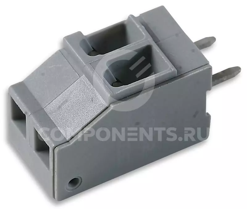

Клеммная колодка для печатной платы; 2,5 мм²; Шаг контактов 5 мм; 2-полюсный; CAGE CLAMP

Actuation typeOperating tool
Clamping spring materialChrome nickel spring steel (CrNi)
Цветlight gray
Connection technologyCAGE CLAMP®
Contact materialElectrolytic copper (Ecu)
Contact platingtin-plated
Country of originPL
Габариты: глубина11.1 mm / 0.437 inch
Drilled hole diameter (tolerance)1.3(+ 0.1) мм
Fine-stranded conductor0.08 … 2.5 mm² / 28 … 12 AWG
Fine-stranded conductor with ferrule with plastic collar0.25 … 1.5 mm²
Fine-stranded conductor with ferrule without plastic collar0.25 … 1.5 mm²
Fire load0.042 MJ
Flammability class per UL94V0
GTIN4055143260145
Height23.3 mm / 0.917 inch
Height from the surface18.2 mm / 0.717 inch
Insulating materialPolyamide 66 (PA 66)
Legend (ratings)(III / 2) ≙ Overvoltage category III / Pollution degree 2
Limit temperature range-60 … +105 °C
Material groupI
Number of Poles2
Number of connection types1
Number of levels1
Number of solder pins per potential1
PCB contactTHT
Pin spacing5 mm (0.197 inch)
Product Group4 (Printed Circuit)
Rated current16 A
Rated impulse voltage (II / 2)4 kV
Rated impulse voltage (III / 2)4 kV
Rated impulse voltage (III / 3)4 kV
Rated voltage (II / 2)630 В
Rated voltage (III / 2)320 В
Rated voltage (III / 3)300 В
Solder pin arrangementover the entire terminal strip, in line
Solder pin dimensions0.8 x 1 mm
Solder pin length5.1 мм
Solid conductor0.08 … 2.5 mm² / 28 … 12 AWG
Strip length6 … 7 mm / 0.24 … 0.28 Inch
Total number of connection points2
Total number of potentials2
Вес2.781 г
Ширина10 mm / 0.394 inch
