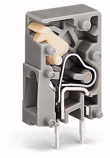

Datasheet Wago 741-904 — Даташит
ПроизводительWago
Серия741
Модель741-904
Стекируемый клеммный блок для печатных плат; Кнопка; 2,5 мм²; Шаг контактов 5 мм; 1-полюсный; CAGE CLAMP
Augswan
741-904
Wago
Actuation typePush-button
Clamping spring materialChrome nickel spring steel (CrNi)
Цветgray
Connection technologyCAGE CLAMP®
Contact materialElectrolytic copper (Ecu)
Contact platingtin-plated
Country of originCH
Габариты: глубина12.8 mm / 0.504 inch
Drilled hole diameter (tolerance)1.1(+ 0.1) мм
Fine-stranded conductor0.08 … 2.5 mm² / 28 … 12 AWG
Fine-stranded conductor with ferrule with plastic collar0.25 … 1.5 mm²
Fine-stranded conductor with ferrule without plastic collar0.25 … 1.5 mm²
Fire load0.021 MJ
Flammability class per UL94V0
GTIN4044918677967
Height22.5 mm / 0.886 inch
Height from the surface18.5 mm / 0.728 inch
Insulating materialPolyamide 66 (PA 66)
Legend (ratings)(III / 2) ≙ Overvoltage category III / Pollution degree 2
Limit temperature range-60 … +105 °C
Material groupI
Number of Poles1
Number of connection types1
Number of levels1
Number of solder pins per potential2
PCB contactTHT
Pin spacing5 mm (0.197 inch)
Product Group4 (Printed Circuit)
Rated current16 A
Rated impulse voltage (II / 2)4 kV
Rated impulse voltage (III / 2)4 kV
Rated impulse voltage (III / 3)4 kV
Rated voltage (II / 2)500 В
Rated voltage (III / 2)250 В
Rated voltage (III / 3)250 В
Solder pin arrangementwithin the terminal block, in line
Solder pin dimensions0.7 x 0.7 mm
Solder pin length4 мм
Solid conductor0.08 … 2.5 mm² / 28 … 12 AWG
Strip length5 … 6 mm / 0.2 … 0.24 Inch
Total number of connection points1
Total number of potentials1
Вес1.261 г
Ширина5 mm / 0.197 inch
