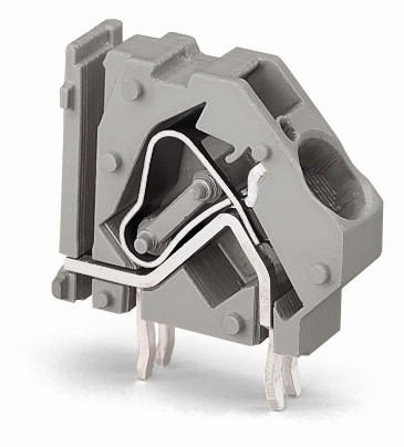

Стекируемый клеммный блок для печатных плат; 16 мм²; Шаг контактов 10 мм; 1-полюсный; CAGE CLAMP; возможность объединения
STACKABLE PCB TERMINAL BLOCK; 16 | |||
| 745-853/006-000 Wago | 458 ₽ | ||
| 745-853/006-000 Wago | по запросу | ||
| Actuation type | Operating tool |
| Clamping spring material | Chrome nickel spring steel (CrNi) |
| Цвет | light gray |
| Conductor entry angle to the PCB | 45 ° |
| Connection technology | CAGE CLAMP® |
| Contact material | Electrolytic copper (Ecu) |
| Contact plating | tin-plated |
| Country of origin | PL |
| Габариты: глубина | 33.4 mm / 1.315 inch |
| Drilled hole diameter (tolerance) | 2.2(+ 0.1) мм |
| Fine-stranded conductor | 0.2 … 16 mm² / 24 … 6 AWG |
| Fine-stranded conductor with ferrule with plastic collar | 0.25 … 10 mm² |
| Fine-stranded conductor with ferrule without plastic collar | 0.25 … 10 mm² |
| Fire load | 0.125 MJ |
| Flammability class per UL94 | V0 |
| GTIN | 4017332750561 |
| Height | 33.5 mm / 1.319 inch |
| Height from the surface | 27 mm / 1.063 inch |
| Insulating material | Polyamide 66 (PA 66) |
| Legend (ratings) | (III / 2) ≙ Overvoltage category III / Pollution degree 2 |
| Limit temperature range | -60 … +105 °C |
| Material group | I |
| Number of Poles | 1 |
| Number of connection types | 1 |
| Number of jumper slots | 1 |
| Number of levels | 1 |
| Number of solder pins per potential | 4 |
| PCB contact | THT |
| Pin spacing | 10 mm (0.394 inch) |
| Product Group | 4 (Printed Circuit) |
| Rated current | 76 A |
| Rated impulse voltage (II / 2) | 4 kV |
| Rated impulse voltage (III / 2) | 4 kV |
| Rated impulse voltage (III / 3) | 4 kV |
| Rated voltage (II / 2) | 630 В |
| Rated voltage (III / 2) | 320 В |
| Rated voltage (III / 3) | 320 В |
| Solder pin arrangement | over the entire terminal strip, in line |
| Solder pin dimensions | 1.2 x 1.6 mm |
| Solder pin length | 6.5 мм |
| Solid conductor | 0.2 … 16 mm² / 24 … 6 AWG |
| Strip length | 12 … 13 mm / 0.47 … 0.51 Inch |
| Total number of connection points | 1 |
| Total number of potentials | 1 |
| Вес | 8.884 г |
| Ширина | 11.5 mm / 0.453 inch |
