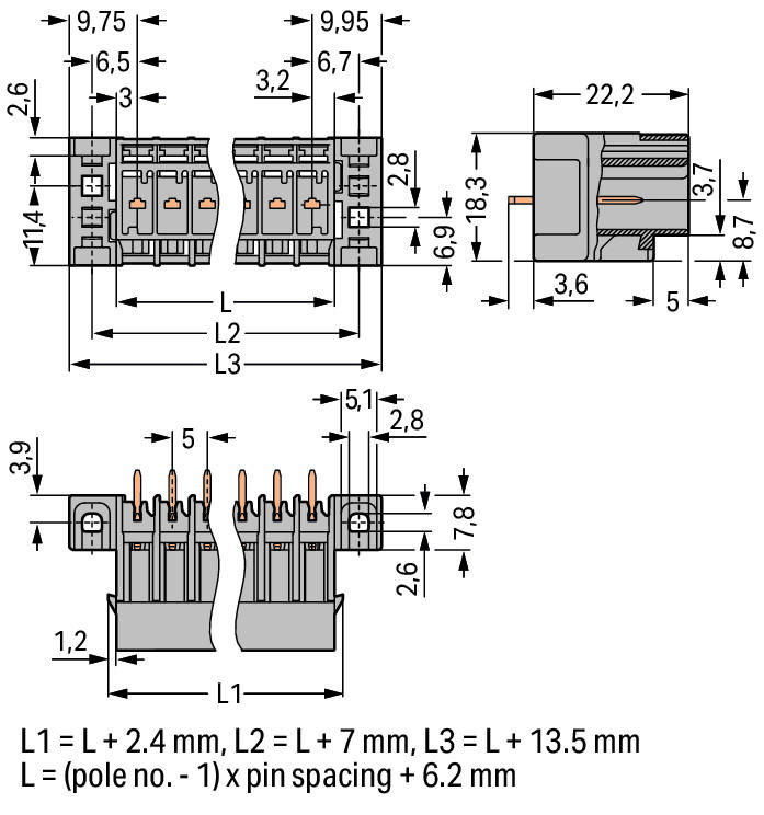

Datasheet Wago 769-641/003-000 — Даташит
Вилка THT; 1.0 x 1.0 mm solder pin; прямые; зажимное кольцо; Шаг контактов 5 мм; 11-пол.
THT MALE HEADER; 1.0 X 1.0 MM SO | |||
| 769-641/003-000 Wago | по запросу | ||
| Actuation type | Operating tool |
| Цвет | gray |
| Connector connection type | for PCBs |
| Contact type (pluggable connector) | Male connector/plug |
| Country of origin | PL |
| Габариты: глубина | 18.3 mm / 0.72 inch |
| Fire load | 0.251 MJ |
| GTIN | 4017332412964 |
| Height from the surface | 22.2 mm / 0.874 inch |
| Insulating material | Polyamide 66 (PA 66) |
| Legend (ratings) | (III / 3) ≙ Overvoltage category III / Pollution degree 3 |
| Mating direction to the PCB | 90 ° |
| Mismating protection | No |
| Mounting type | Mounting flange |
| Number of Poles | 11 |
| Number of levels | 1 |
| PCB contact | THT |
| Pin spacing | 5 mm / 0.197 inch |
| Product Group | 18 (X-COM-System) |
| Rated current | 32 A |
| Rated impulse voltage (III / 2) | 4 kV |
| Rated impulse voltage (III / 3) | 4 kV |
| Rated voltage (III / 2) | 500 В |
| Rated voltage (III / 3) | 250 В |
| Solder pin dimensions | Solder pin 1 x 1 mm |
| Total number of potentials | 11 |
| Вес | 11.639 г |
| Ширина | 69.7 mm / 2.744 inch |
