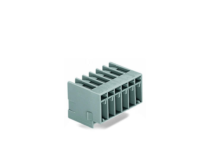

Стифлейсте; mit abgewinkelten Einlötstiften; Steckrichtung Parallel zur Leiterplatte; 1 х 1 мм; Растровая масса 5 мм / 0,197 дюйма; 2-полиг
THT MALE HEADER; 1.0 X 1.0 MM SO | |||
769-662/003-000 Wago | 173 ₽ | ||
769-662/003-000 Wago | по запросу | ||
Actuation type | Operating tool |
Цвет | grau |
Connector connection type | for PCBs |
Contact type (pluggable connector) | Male connector/plug |
Country of origin | DE |
Габариты: глубина | 22.2 mm / 0.874 inch |
Height from the surface | 18.3 mm / 0.72 inch |
Legend (ratings) | (III / 3) ≙ Overvoltage category III / Pollution degree 3 |
Mismating protection | No |
Number of Poles | 2 |
Number of levels | 1 |
PCB contact | THT |
Pin spacing | 5 mm / 0.197 inch |
Product Group | 18 (X-COM-System) |
Rated current | 32 A |
Rated impulse voltage (III / 2) | 4 kV |
Rated impulse voltage (III / 3) | 4 kV |
Rated voltage (III / 2) | 500 В |
Rated voltage (III / 3) | 250 В |
Solder pin dimensions | Solder pin 1 x 1 mm |
Total number of potentials | 2 |
Ширина | 13.6 mm / 0.535 inch |
