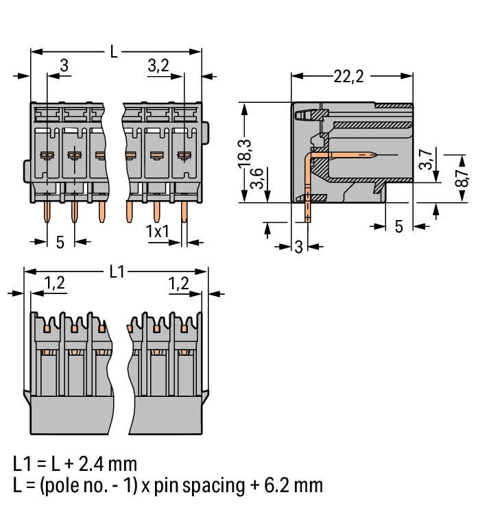

Datasheet Wago 769-667 — Даташит
Вилка THT; 1.0 x 1.0 mm solder pin; угловые; Шаг контактов 5 мм; 7-пол.
THT MALE HEADER; 1.0 X 1.0 MM SO | |||
769-667/003-000 Wago | 408 ₽ | ||
769-667/004-000 Wago | по запросу |
Actuation type | Operating tool |
Цвет | gray |
Connector connection type | for PCBs |
Contact type (pluggable connector) | Male connector/plug |
Country of origin | DE |
Габариты: глубина | 22.2 mm / 0.874 inch |
Fire load | 0.158 MJ |
GTIN | 4044918760416 |
Height from the surface | 18.3 mm / 0.72 inch |
Legend (ratings) | (III / 3) ≙ Overvoltage category III / Pollution degree 3 |
Mismating protection | No |
Number of Poles | 7 |
Number of levels | 1 |
PCB contact | THT |
Pin spacing | 5 mm / 0.197 inch |
Product Group | 18 (X-COM-System) |
Rated current | 32 A |
Rated impulse voltage (III / 2) | 4 kV |
Rated impulse voltage (III / 3) | 4 kV |
Rated voltage (III / 2) | 500 В |
Rated voltage (III / 3) | 250 В |
Solder pin dimensions | Solder pin 1 x 1 mm |
Total number of potentials | 7 |
Вес | 7.801 г |
Ширина | 38.6 mm / 1.52 inch |
