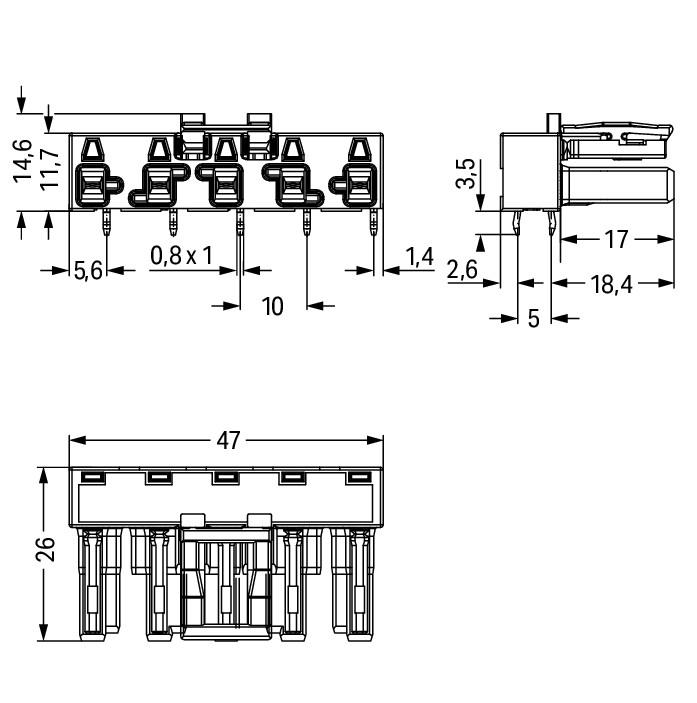

Розетка для печатных плат; угловые; 5-пол.; Код. B
SOCKET FOR PCBS ANGLED 5-POLE, G | |||
770-845/011-000/062-000 Wago | по запросу | ||
Coding | B |
Цвет | gray |
Connector connection type | for PCBs |
Contact material | Copper or copper alloy, surface-treated |
Contact type (pluggable connector) | Female connector/socket |
Country of origin | DE |
Degree of protection | IP20 |
Габариты: глубина | 26 mm / 1.024 inch |
Design | angled |
Drilled hole diameter (tolerance) | 1.5(+ 0.1 ... - 0.1) мм |
Fire load | 0.189 MJ |
GTIN | 4050821553731 |
Height | 18.1 mm / 0.713 inch |
Height from the surface | 14.6 mm / 0.575 inch |
Legend (ratings) | (III / 3) ≙ Overvoltage category III / Pollution degree 3 |
Locking lever | да |
Locking of plug-in connection | locking lever |
Marking | N PE 3 2 1 |
Mating force of a plug-in connection | approx. 20 … 70 N (depending on pole number) |
Number of Poles | 5 |
Number of levels | 1 |
Number of solder pins per potential | 2 |
PCB contact | THT |
Pin spacing | 10 mm (0.394 inch) |
Potential marking | N PE 3 2 1 |
Rated current | 25 A |
Rated impulse voltage (III / 3) | 6 kV |
Rated voltage (III / 3) | 400 В |
Retention force of a plug-in connection | when locked: > 80N |
Solder pin arrangement | 2 in-line solder pins/pole |
Solder pin dimensions | 1 x 0.8 mm |
Solder pin length | 3.5 мм |
Surrounding air (operating) temperature | -35 … 85 °C |
Total number of potentials | 5 |
Unmating force of a plug-in connection | when unlocked: approx. 20 … 70 N (depending on pole number) |
Вес | 10.445 г |
Ширина | 47 mm / 1.85 inch |
