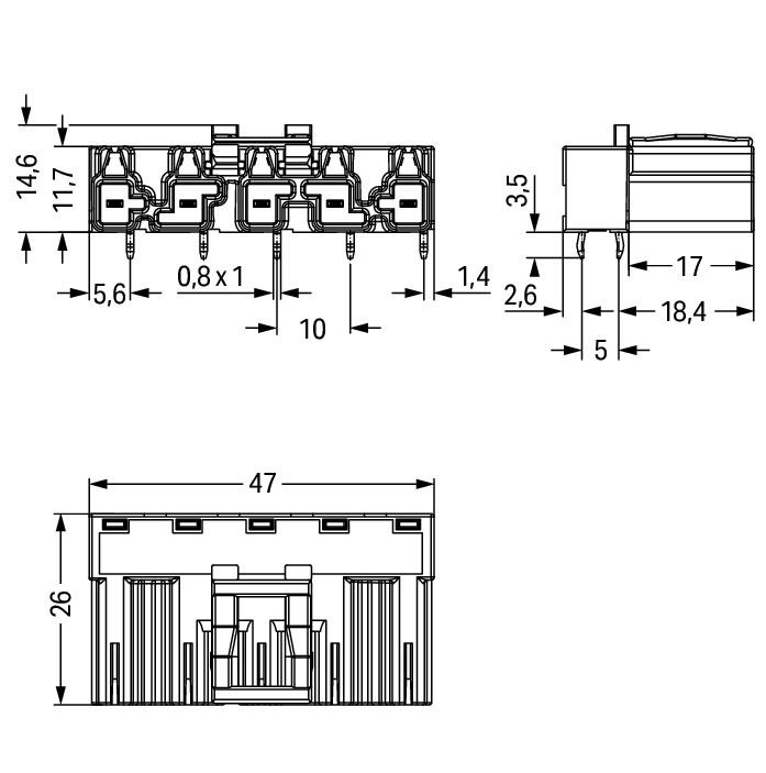

Штекер для печатных плат; угловые; 5-пол.; Код. B
PLUG FOR PCBS ANGLED 5-POLE, GRA | |||
| 770-855/011-000/064-000 Wago | по запросу | ||
| Coding | B |
| Цвет | gray |
| Connector connection type | for PCBs |
| Contact material | Copper or copper alloy, surface-treated |
| Contact type (pluggable connector) | Male connector/plug |
| Country of origin | DE |
| Degree of protection | IP20 |
| Габариты: глубина | 26 mm / 1.024 inch |
| Design | angled |
| Drilled hole diameter (tolerance) | 1.5(+ 0.1 ... - 0.1) мм |
| Fire load | 0.195 MJ |
| Flammability class per UL94 | V0 |
| GTIN | 4050821553816 |
| Height | 18.1 mm / 0.713 inch |
| Height from the surface | 14.6 mm / 0.575 inch |
| Insulating material | Polyamide 66 (PA 66) |
| Legend (ratings) | (III / 3) ≙ Overvoltage category III / Pollution degree 3 |
| Locking lever | да |
| Locking of plug-in connection | locking lever |
| Marking | N ⏚ L 2L 1L |
| Mating force of a plug-in connection | approx. 20 … 70 N (depending on pole number) |
| Number of Poles | 5 |
| Number of levels | 1 |
| Number of solder pins per potential | 2 |
| PCB contact | THT |
| Pin spacing | 10 mm (0.394 inch) |
| Potential marking | N ⏚ L 2L 1L |
| Rated current | 25 A |
| Rated impulse voltage (III / 3) | 6 kV |
| Rated voltage (III / 3) | 400 В |
| Retention force of a plug-in connection | when locked: > 80N |
| Solder pin arrangement | 2 in-line solder pins/pole |
| Solder pin dimensions | 1 x 0.8 mm |
| Solder pin length | 3.5 мм |
| Surrounding air (operating) temperature | -35 … 85 °C |
| Total number of potentials | 5 |
| Unmating force of a plug-in connection | when unlocked: approx. 20 … 70 N (depending on pole number) |
| Вес | 9.497 г |
| Ширина | 47 mm / 1.85 inch |
