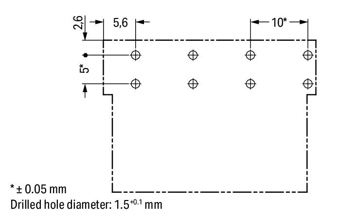

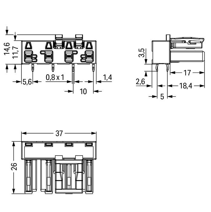

Габариты: глубина | 26 mm / 1.024 inch |
Design | angled |
Drilled hole diameter (tolerance) | 1.5(+ 0.1 ... - 0.1) мм |

Height | 18.1 mm / 0.713 inch |
Height from the surface | 14.6 mm / 0.575 inch |

Pin spacing | 10 mm (0.394 inch) |

Solder pin dimensions | 1 x 0.8 mm |
Solder pin length | 3.5 мм |

Вес | 8.558 г |
Ширина | 37 mm / 1.457 inch |
