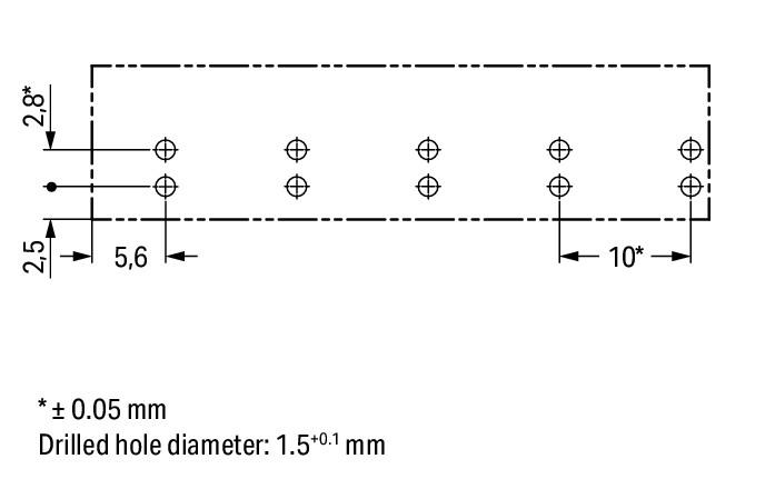

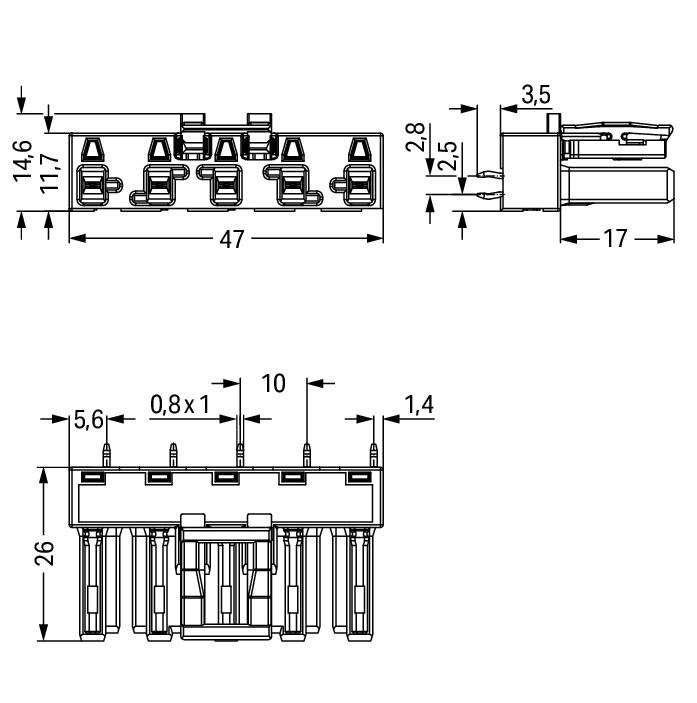

| Габариты: глубина | 14.6 mm / 0.575 inch |
| Design | straight |
| Drilled hole diameter (tolerance) | 1.5(+ 0.1 ... - 0.1) мм |

| Height | 29.5 mm / 1.161 inch |
| Height from the surface | 26 mm / 1.024 inch |

| Number of solder pins per potential | 2 |
| PCB contact | THT |
| Pin spacing | 10 mm (0.394 inch) |

| Solder pin arrangement | 2 in-line solder pins/pole |
| Solder pin dimensions | 1 x 0.8 mm |
| Solder pin length | 3.5 мм |

| Ширина | 47 mm / 1.85 inch |
