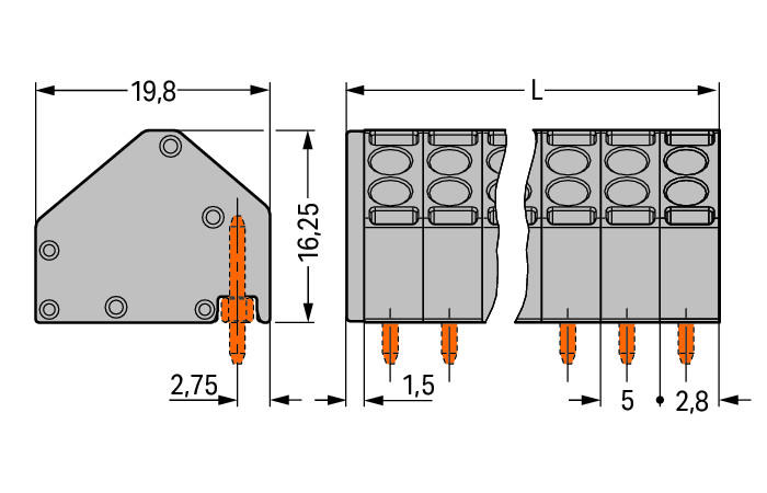

2-проводные клеммы для печатных плат; 1,5; Шаг контактов 5 мм; 7-пол.; Push-in CAGE CLAMP

Габариты: глубина19.8 mm / 0.78 inch
Fine-stranded conductor0.2 … 1.5 mm² / 24 … 16 AWG
Fine-stranded conductor with ferrule with plastic collar0.25 … 1 mm²
Fine-stranded conductor with ferrule without plastic collar0.25 … 1 mm²
Fire load0.176 MJ
Flammability class per UL94V0
GTIN4045454076955
Height16.25 mm / 0.64 inch
Insulating materialPolyamide 66 (PA 66)
Legend (ratings)(III / 2) ≙ Overvoltage category III / Pollution degree 2
Limit temperature range-60 … +105 °C
Material groupI
Mating direction to the PCB90 °
Number of Poles7
Number of connection types1
Number of levels1
PCB contactTHT
Pin spacing5 mm (0.197 inch)
Product Group4 (Printed Circuit)
Rated current10 A
Rated impulse voltage (II / 2)4 kV
Rated impulse voltage (III / 2)4 kV
Rated impulse voltage (III / 3)4 kV
Rated voltage (II / 2)630 В
Rated voltage (III / 2)320 В
Rated voltage (III / 3)250 В
Solder pin diameter1 мм
Solid conductor0.2 … 1.5 mm² / 24 … 16 AWG
Strip length9 … 10 mm / 0.35 … 0.39 Inch
Total number of connection points14
Total number of potentials7
Вес8.883 г
Ширина36.5 mm / 1.437 inch
