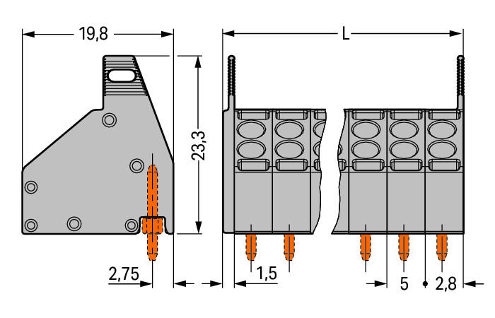

Datasheet Wago 806-205
2-проводные клеммы для печатных плат; 1,5; Шаг контактов 5 мм; 5-пол.; Push-in CAGE CLAMP

Actuation typeOperating tool
Clamping spring materialChrome nickel spring steel (CrNi)
Цветgray
Conductor entry angle to the PCB45 °
Connection technologyPush-in CAGE CLAMP®
Connector connection typefor PCBs
Contact materialCopper alloy
Contact platingtin-plated
Contact type (pluggable connector)Female connector/socket
Country of originPL
Габариты: глубина19.8 mm / 0.78 inch
Fine-stranded conductor0.2 … 1.5 mm² / 24 … 16 AWG
Fine-stranded conductor with ferrule with plastic collar0.25 … 1 mm²
Fine-stranded conductor with ferrule without plastic collar0.25 … 1 mm²
Fire load0.131 MJ
Flammability class per UL94V0
GTIN4045454077105
Height23.3 mm / 0.917 inch
Insulating materialPolyamide 66 (PA 66)
Legend (ratings)(III / 2) ≙ Overvoltage category III / Pollution degree 2
Limit temperature range-60 … +105 °C
Material groupI
Mating direction to the PCB90 °
Number of Poles5
Number of connection types1
Number of levels1
PCB contactTHT
Pin spacing5 mm (0.197 inch)
Product Group4 (Printed Circuit)
Rated current10 A
Rated impulse voltage (II / 2)4 kV
Rated impulse voltage (III / 2)4 kV
Rated impulse voltage (III / 3)4 kV
Rated voltage (II / 2)630 В
Rated voltage (III / 2)320 В
Rated voltage (III / 3)250 В
Solder pin diameter1 мм
Solid conductor0.2 … 1.5 mm² / 24 … 16 AWG
Strip length9 … 10 mm / 0.35 … 0.39 Inch
Total number of connection points10
Total number of potentials5
Вес6.519 г
Ширина26.5 mm / 1.043 inch
