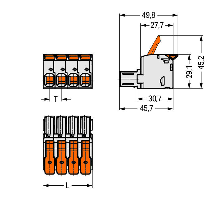

Datasheet Wago 832-1102 — Даташит
1-проводниковая розетка; 100% защита от неправильного подсоединения; Нажимной рычаг; Посеребренные контакты; 16 мм²; Шаг контактов 10,16 мм; 2-пол.
![]() 15 предложений от 5 поставщиков Вставные Клеммные Колодки | |||
832-1102/037-000 Wago | 644 ₽ | ||
832-1102 | от 1 189 ₽ | ||
832-1102 Wago | от 1 489 ₽ | ||
832-1102/322-000 Wago | по запросу |
Actuation type | Push-button |
Clamping spring material | Chrome nickel spring steel (CrNi) |
Цвет | light gray |
Connection technology | Push-in CAGE CLAMP® |
Connector connection type | for conductors |
Contact material | Electrolytic copper (Ecu) |
Contact plating | silver-plated |
Contact type (pluggable connector) | Female connector/socket |
Country of origin | DE |
Габариты: глубина | 49.8 mm / 1.961 inch |
Fine-stranded conductor | 0.75 … 25 mm² / 18 … 4 AWG |
Fine-stranded conductor with ferrule with plastic collar | 0.75 … 16 mm² |
Fine-stranded conductor with ferrule without plastic collar | 0.75 … 16 mm² |
GTIN | 4055143736602 |
Height | 29.1 mm / 1.146 inch |
Insulating material | Polybutylene terephthalate (PBT) |
Legend (ratings) | (III / 2) ≙ Overvoltage category III / Pollution degree 2 |
Limit temperature range | -60 … +120 °C |
Material group | I |
Material of the additional spring for socket contact | Chrome nickel spring steel (CrNi) |
Mismating protection | Yes |
Number of Poles | 2 |
Number of connection types | 1 |
Number of levels | 1 |
Packaging type | BOX |
Pin spacing | 10.16 mm (0.4 inch) |
Rated current | 76 A |
Rated impulse voltage (II / 2) | 8 kV |
Rated impulse voltage (III / 2) | 8 kV |
Rated impulse voltage (III / 3) | 8 kV |
Rated voltage (II / 2) | 1000 В |
Rated voltage (III / 2) | 1000 В |
Rated voltage (III / 3) | 1000 В |
Solid conductor | 0.75 … 16 mm² / 18 … 4 AWG |
Strip length | 18 … 20 mm / 0.71 … 0.79 Inch |
Total number of connection points | 2 |
Total number of potentials | 2 |
Вес | 27.552 г |
Ширина | 21.62 mm / 0.851 inch |
Серия: 832 (31)
