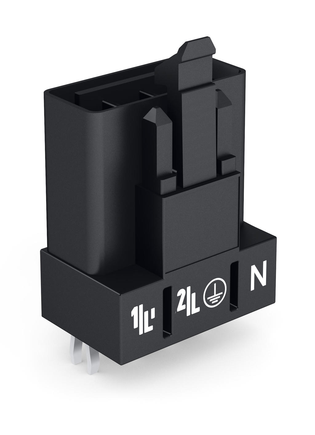

Заглушка для печатных плат; прямой; 4-полюсный; Код. А
PLUG FOR PCBS STRAIGHT 4-POLE | |||
| 890-814 Wago | по запросу | ||
| 890-814/011-000 Wago | по запросу | ||
| Coding | A |
| Цвет | black |
| Connector connection type | for PCBs |
| Contact material | Copper or copper alloy, surface-treated |
| Contact type (pluggable connector) | Male connector/plug |
| Country of origin | DE |
| Degree of protection | IP20 |
| Габариты: глубина | 12.2 mm / 0.48 inch |
| Design | straight |
| Drilled hole diameter (tolerance) | 1.3(+ 0.1 ... - 0.1) мм |
| Fire load | 0.078 MJ |
| Flammability class per UL94 | V0 |
| GTIN | 4050821695516 |
| Ground function | with preceding GND contact |
| Height | 31.9 mm / 1.256 inch |
| Height from the surface | 28.4 mm / 1.118 inch |
| Insulating material | Polyamide 66 (PA 66) |
| Legend (ratings) | (III / 3) ≙ Overvoltage category III / Pollution degree 3 |
| Locking lever | да |
| Locking of plug-in connection | locking lever |
| Marking | N ⏚ 2|L 1|L' |
| Mating direction to the PCB | 90 ° |
| Mating force of a plug-in connection | approx. 20 … 70 N (depending on pole number) |
| Mismating protection | Yes |
| Number of Poles | 4 |
| Number of levels | 1 |
| Number of solder pins per potential | 2 |
| PCB contact | THT |
| Pin spacing | 4.4 mm (0.173 inch) |
| Potential marking | N ⏚ 2/L 1/L' |
| Product Group | 20 (WINSTA) |
| Rated current | 16 A |
| Rated impulse voltage (III / 3) | 4 kV |
| Rated voltage (III / 3) | 250 В |
| Retention force of a plug-in connection | when locked: > 80N |
| Solder pin arrangement | 2 in-line solder pins/pole |
| Solder pin dimensions | 1 x 0.8 mm |
| Solder pin length | 3.5 мм |
| Surrounding air (operating) temperature | -35 … 85 °C |
| Total number of potentials | 4 |
| Unmating force of a plug-in connection | when unlocked: approx. 20 … 70 N (depending on pole number) |
| Вес | 4.006 г |
| Ширина | 19.2 mm / 0.756 inch |
