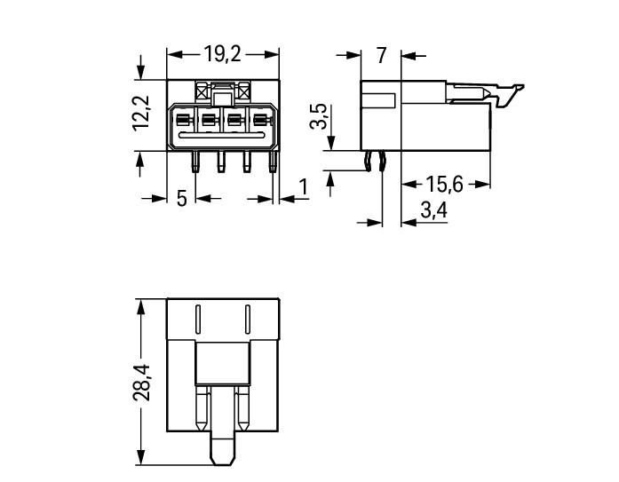

Вилка для печатных плат; угловая; 4-полюсная; Код A
PLUG FOR PCBS ANGLED 4-POLE, BLA | |||
890-814/011-000 Wago | по запросу | ||
Coding | A |
Цвет | black |
Connector connection type | for PCBs |
Contact material | Copper or copper alloy, surface-treated |
Contact type (pluggable connector) | Male connector/plug |
Country of origin | DE |
Degree of protection | IP20 |
Габариты: глубина | 28.4 mm / 1.118 inch |
Design | angled |

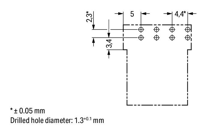

Drilled hole diameter (tolerance) | 1.3(+ 0.1 ... - 0.1) мм |
Fire load | 0.078 MJ |
GTIN | 4050821695707 |
Ground function | with preceding GND contact |
Height | 15.7 mm / 0.618 inch |
Height from the surface | 12.2 mm / 0.48 inch |
Legend (ratings) | (III / 3) ≙ Overvoltage category III / Pollution degree 3 |
Locking lever | да |
Locking of plug-in connection | locking lever |
Marking | N ⏚ 2|L 1|L' |
Mating force of a plug-in connection | approx. 20 … 70 N (depending on pole number) |
Mismating protection | Yes |
Number of Poles | 4 |
Number of levels | 1 |
Number of solder pins per potential | 2 |
PCB contact | THT |
Pin spacing | 4.4 mm (0.173 inch) |
Potential marking | N ⏚ 2/L 1/L' |
Rated current | 16 A |
Rated impulse voltage (III / 3) | 4 kV |
Rated voltage (III / 3) | 250 В |
Retention force of a plug-in connection | when locked: > 80N |
Solder pin arrangement | 2 in-line solder pins/pole |
Solder pin dimensions | 1 x 0.8 mm |
Solder pin length | 3.5 мм |
Surrounding air (operating) temperature | -35 … 85 °C |
Total number of potentials | 4 |
Unmating force of a plug-in connection | when unlocked: approx. 20 … 70 N (depending on pole number) |
Вес | 4.166 г |
Ширина | 19.2 mm / 0.756 inch |
