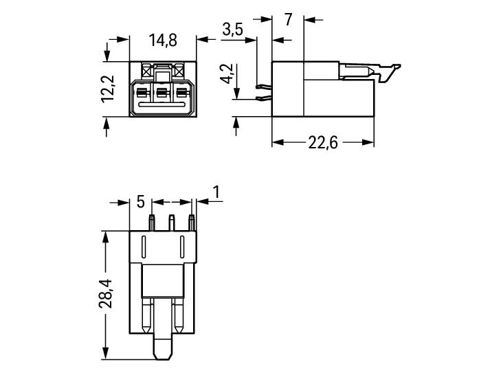

Datasheet Wago 890-833 — Даташит
ПроизводительWago
Серия890
Модель890-833
Штекер; - для печатных плат; 3-пол.; Кодирование А
Augswan
890-833
Wago
Wago 890-833 Wago 890-833
CodingA
Цветwhite
Connector connection typefor PCBs
Contact materialCopper or copper alloy, surface-treated
Contact type (pluggable connector)Male connector/plug
Country of originDE
Degree of protectionIP20
Габариты: глубина12.2 mm / 0.48 inch
Designstraight
Drilled hole diameter (tolerance)1.3(+ 0.1 ... - 0.1) мм
Fire load0.065 MJ
Flammability class per UL94V0
GTIN4050821695585
Ground functionwith preceding GND contact
Height31.9 mm / 1.256 inch
Height from the surface28.4 mm / 1.118 inch
Insulating materialPolyamide 66 (PA 66)
Legend (ratings)(III / 3) ≙ Overvoltage category III / Pollution degree 3
Locking leverда
Locking of plug-in connectionlocking lever
MarkingL ⏚ N
Mating direction to the PCB90 °
Mating force of a plug-in connectionapprox. 20 … 70 N (depending on pole number)
Mismating protectionYes
Number of Poles3
Number of levels1
Number of solder pins per potential2
PCB contactTHT
Pin spacing4.4 mm (0.173 inch)
Potential markingL ⏚ N
Product Group20 (WINSTA)
Rated current16 A
Rated impulse voltage (III / 3)4 kV
Rated voltage (III / 3)250 В
Retention force of a plug-in connectionwhen locked: > 80N
Solder pin arrangement2 in-line solder pins/pole
Solder pin dimensions1 x 0.8 mm
Solder pin length3.5 мм
Surrounding air (operating) temperature-35 … 85 °C
Total number of potentials3
Unmating force of a plug-in connectionwhen unlocked: approx. 20 … 70 N (depending on pole number)
Вес3.2 г
Ширина14.8 mm / 0.583 inch
