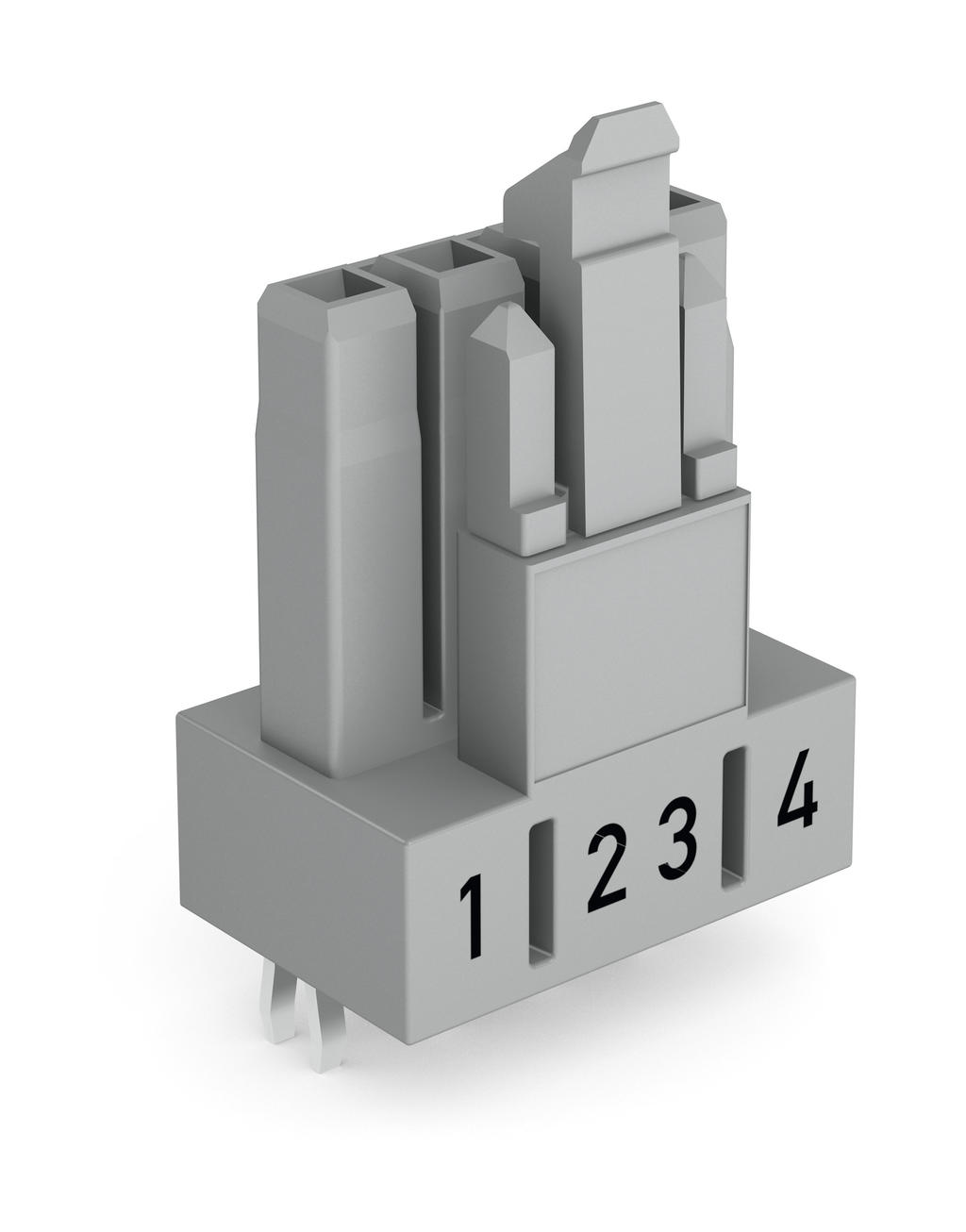

Гнездо для печатных плат; прямое; 4-полюсное; Код B
890844
от 2 233 ₽
Augswan
890-844/011-000
Wago
Wago 890-844 Wago 890-844
CodingB
Цветgray
Connector connection typefor PCBs
Contact materialCopper or copper alloy, surface-treated
Contact type (pluggable connector)Female connector/socket
Country of originDE
Degree of protectionIP20
Габариты: глубина12.2 mm / 0.48 inch
Designstraight
Drilled hole diameter (tolerance)1.3(+ 0.1 ... - 0.1) мм
Fire load0.073 MJ
Flammability class per UL94V0
GTIN4050821695639
Height31.9 mm / 1.256 inch
Height from the surface28.4 mm / 1.118 inch
Insulating materialPolyamide 66 (PA 66)
Legend (ratings)(III / 3) ≙ Overvoltage category III / Pollution degree 3
Locking leverда
Locking of plug-in connectionlocking lever
Marking1 2 3 4
Mating direction to the PCB90 °
Mating force of a plug-in connectionapprox. 20 … 70 N (depending on pole number)
Number of Poles4
Number of levels1
Number of solder pins per potential2
PCB contactTHT
Pin spacing4.4 mm (0.173 inch)
Potential marking1 2 3 4
Product Group20 (WINSTA)
Rated current16 A
Rated impulse voltage (III / 3)4 kV
Rated voltage (III / 3)250 В
Retention force of a plug-in connectionwhen locked: > 80N
Solder pin arrangement2 in-line solder pins/pole
Solder pin dimensions1 x 0.8 mm
Solder pin length3.5 мм
Surrounding air (operating) temperature-35 … 85 °C
Total number of potentials4
Unmating force of a plug-in connectionwhen unlocked: approx. 20 … 70 N (depending on pole number)
Вес4.33 г
Ширина19.2 mm / 0.756 inch
