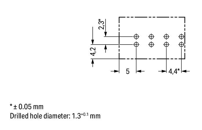

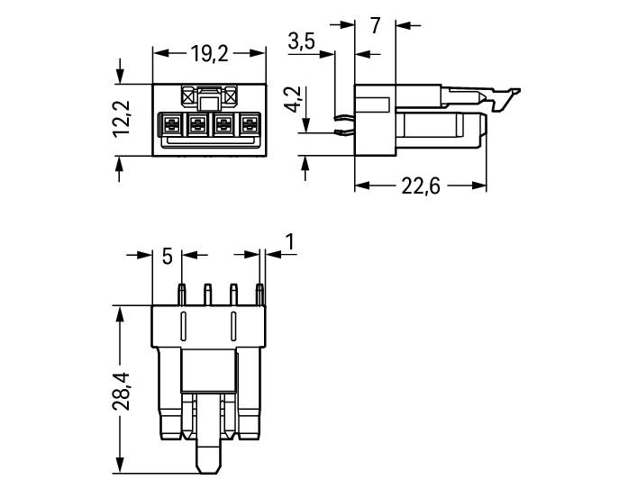

Габариты: глубина | 12.2 mm / 0.48 inch |
Design | straight |
Drilled hole diameter (tolerance) | 1.3(+ 0.1 ... - 0.1) мм |

Height | 31.9 mm / 1.256 inch |
Height from the surface | 28.4 mm / 1.118 inch |

PCB contact | THT |
Pin spacing | 4.4 mm (0.173 inch) |

Solder pin arrangement | 2 in-line solder pins/pole |
Solder pin dimensions | 1 x 0.8 mm |
Solder pin length | 3.5 мм |

Вес | 4.33 г |
Ширина | 19.2 mm / 0.756 inch |
