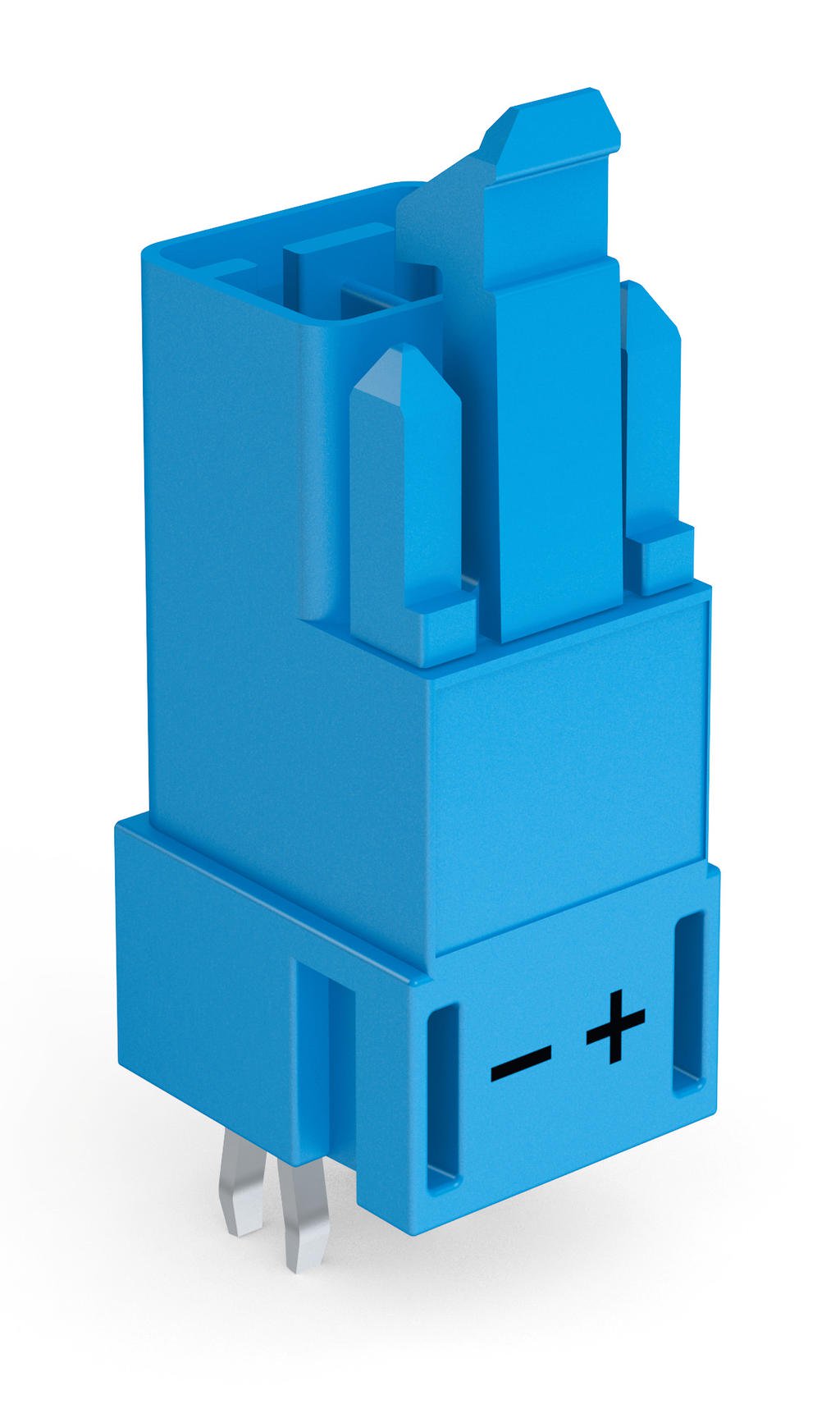

Штекер; - для печатных плат; 2 вывода / контакта под пайку; Кодирование I
PLUG FOR PCBS ANGLED 2-POLE, BLU | |||
890-3112 Wago | 523 ₽ | ||
890-3112/011-000 Wago | по запросу |
Coding | I |
Цвет | blue |
Connector connection type | for PCBs |
Contact material | Copper or copper alloy, surface-treated |
Contact type (pluggable connector) | Male connector/plug |
Country of origin | DE |
Degree of protection | IP20 |

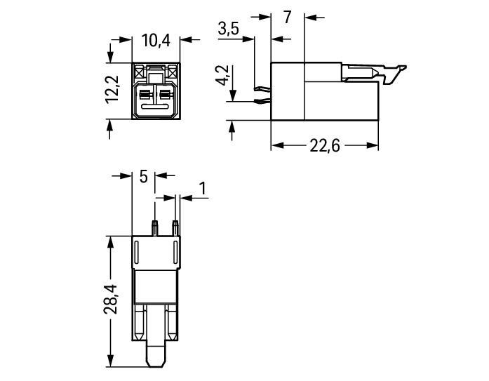

Габариты: глубина | 12.2 mm / 0.48 inch |
Design | straight |
Drilled hole diameter (tolerance) | 1.3(+ 0.1 ... - 0.1) мм |
GTIN | 4055143272575 |
Height | 31.9 mm / 1.256 inch |
Height from the surface | 28.4 mm / 1.118 inch |
Legend (ratings) | (III / 3) ≙ Overvoltage category III / Pollution degree 3 |
Locking lever | да |
Locking of plug-in connection | locking lever |
Marking | + - |
Mating direction to the PCB | 90 ° |
Mating force of a plug-in connection | approx. 20 … 70 N (depending on pole number) |
Mismating protection | Yes |
Number of Poles | 2 |
Number of levels | 1 |
Number of solder pins per potential | 2 |
PCB contact | THT |
Pin spacing | 4.4 mm (0.173 inch) |
Potential marking | + - |
Rated current | 16 A |
Rated impulse voltage (III / 3) | 4 kV |
Rated voltage (III / 3) | 250 В |
Retention force of a plug-in connection | when locked: > 80N |
Solder pin arrangement | 2 in-line solder pins/pole |
Solder pin dimensions | 1 x 0.8 mm |
Solder pin length | 3.5 мм |
Surrounding air (operating) temperature | -35 … 85 °C |
Total number of potentials | 2 |
Unmating force of a plug-in connection | when unlocked: approx. 20 … 70 N (depending on pole number) |
Вес | 2.362 г |
Ширина | 10.4 mm / 0.41 inch |
