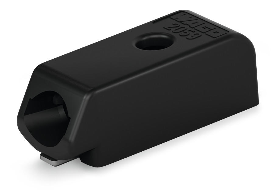

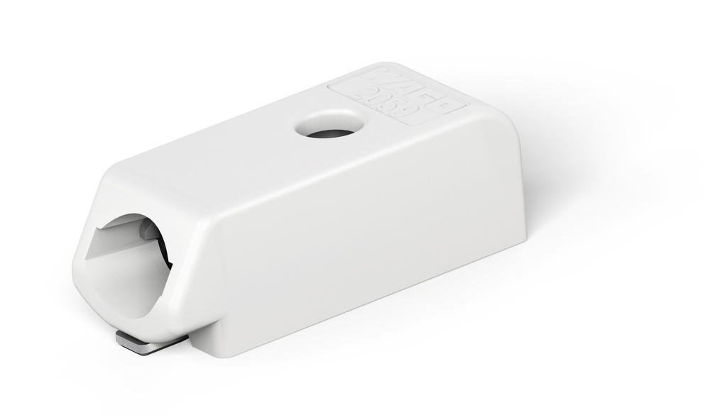

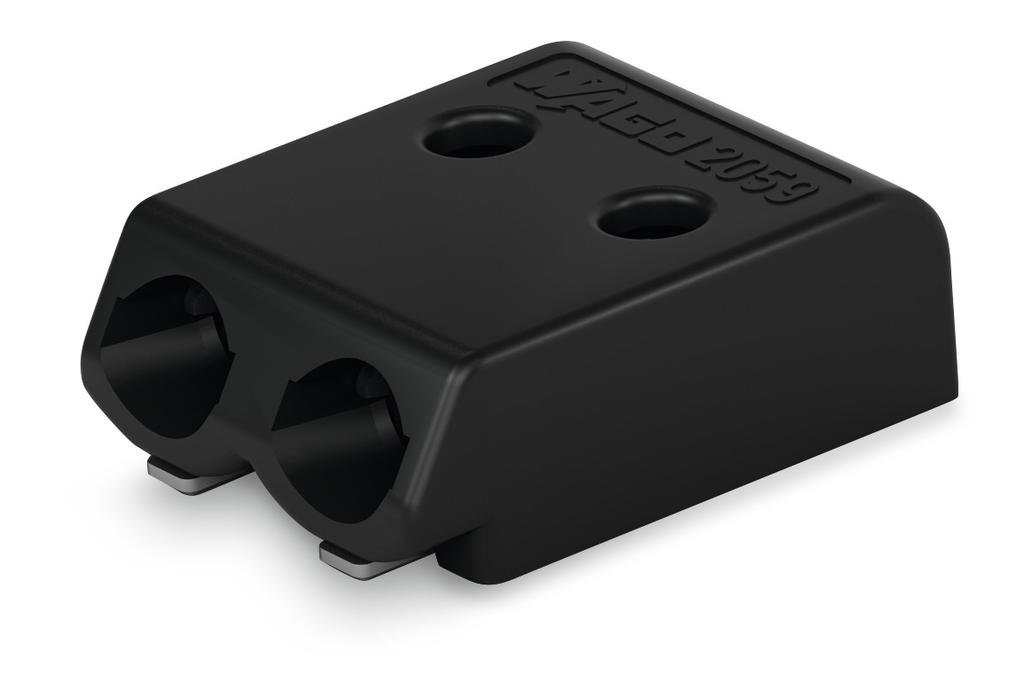

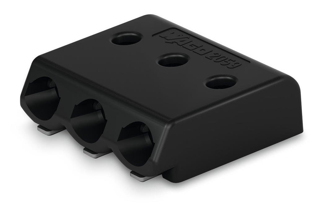

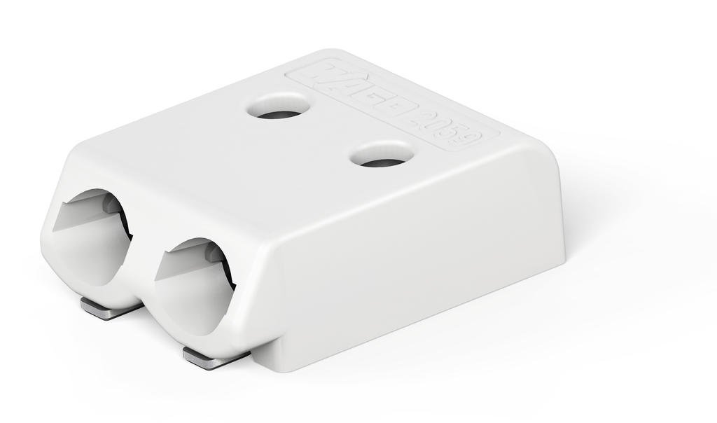

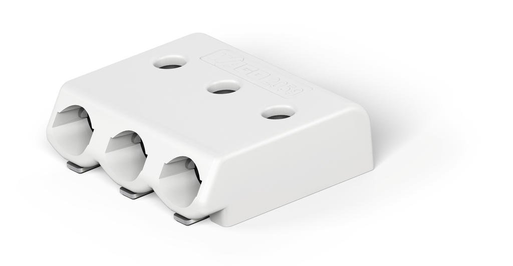

Parameters / Models | 2059-301/998-403![]() | 2059-302/998-403![]() | 2059-303/998-403![]() | 2059-321/998-403![]() | 2059-322/998-403![]() | 2059-323/998-403![]() |
Actuation type | Operating tool | Operating tool | Operating tool | Operating tool | Operating tool | Operating tool |
Цвет | white | white | white | black | black | black |
Connection technology | PUSH WIRE® | PUSH WIRE® | PUSH WIRE® | PUSH WIRE® | PUSH WIRE® | PUSH WIRE® |
Contact material | Copper alloy | Copper alloy | Copper alloy | Copper alloy | Copper alloy | Copper alloy |
Contact plating | tin-plated | tin-plated | tin-plated | tin-plated | tin-plated | tin-plated |
Country of origin | CH | CH | CH | CH | CH | CH |
Габариты: глубина | 7.9 mm / 0.311 inch | 7.9 mm / 0.311 inch | 7.9 mm / 0.311 inch | 7.9 mm / 0.311 inch | 7.9 mm / 0.311 inch | 7.9 mm / 0.311 inch |
Flammability class per UL94 | V0 | V0 | V0 | V0 | V0 | V0 |
GTIN | 4055143082679 | 4055143082686 | 4055143082693 | 4055143476584 | 4055143476560 | 4055143476515 |
Height | 2.7 mm / 0.106 inch | 2.7 mm / 0.106 inch | 2.7 mm / 0.106 inch | 2.7 mm / 0.106 inch | 2.7 mm / 0.106 inch | 2.7 mm / 0.106 inch |
Insulating material | Polyphtalamide (PPA GF) | Polyphtalamide (PPA GF) | Polyphtalamide (PPA GF) | Polyphtalamide (PPA GF) | Polyphtalamide (PPA GF) | Polyphtalamide (PPA GF) |
Legend (ratings) | (III / 2) ≙ Overvoltage category III / Pollution degree 2 | (III / 2) ≙ Overvoltage category III / Pollution degree 2 | (III / 2) ≙ Overvoltage category III / Pollution degree 2 | (III / 2) ≙ Overvoltage category III / Pollution degree 2 | (III / 2) ≙ Overvoltage category III / Pollution degree 2 | (III / 2) ≙ Overvoltage category III / Pollution degree 2 |
Limit temperature range | -60 … +105 °C | -60 … +105 °C | -60 … +105 °C | -60 … +105 °C | -60 … +105 °C | -60 … +105 °C |
Material group | I | I | I | I | I | I |
Number of Poles | 1 | 2 | 3 | 1 | 2 | 3 |
Number of connection types | 1 | 1 | 1 | 1 | 1 | 1 |
Number of levels | 1 | 1 | 1 | 1 | 1 | 1 |
PCB contact | SMD | SMD | SMD | SMD | SMD | SMD |
Pin spacing | 3 mm (0.118 inch) | 3 mm (0.118 inch) | 3 mm (0.118 inch) | 3 mm (0.118 inch) | 3 mm (0.118 inch) | 3 mm (0.118 inch) |
Product Group | 33 (Printed Circuit) | 33 (Printed Circuit) | 33 (Printed Circuit) | |||
Rated current, A | 3 | 3 | 3 | 3 | 3 | 3 |
Rated impulse voltage (II / 2), kV | 2.5 | 2.5 | 2.5 | 2.5 | 2.5 | 2.5 |
Rated impulse voltage (III / 2), kV | 2.5 | 2.5 | 2.5 | 2.5 | 2.5 | 2.5 |
Rated impulse voltage (III / 3), kV | 2.5 | 2.5 | 2.5 | 2.5 | 2.5 | 2.5 |
Rated voltage (II / 2), В | 320 | 320 | 320 | 320 | 320 | 320 |
Rated voltage (III / 2), В | 160 | 160 | 160 | 160 | 160 | 160 |
Rated voltage (III / 3), В | 63 | 63 | 63 | 63 | 63 | 63 |
Reel diameter of tape-and-reel packaging, мм | 330 | 330 | 330 | 330 | 330 | 330 |
Solid conductor | 0.14 … 0.34 mm² / 26 … 22 AWG | 0.14 … 0.34 mm² / 26 … 22 AWG | 0.14 … 0.34 mm² / 26 … 22 AWG | 0.14 … 0.34 mm² / 26 … 22 AWG | 0.14 … 0.34 mm² / 26 … 22 AWG | 0.14 … 0.34 mm² / 26 … 22 AWG |
Solid conductor (2) | 0.5 mm² / 20 AWG | 0.5 mm² / 20 AWG | 0.5 mm² / 20 AWG | 0.5 mm² / 20 AWG | 0.5 mm² / 20 AWG | 0.5 mm² / 20 AWG |
Strip length | 4 … 5.5 mm / 0.16 … 0.22 Inch | 4 … 5.5 mm / 0.16 … 0.22 Inch | 4 … 5.5 mm / 0.16 … 0.22 Inch | 4 … 5.5 mm / 0.16 … 0.22 Inch | 4 … 5.5 mm / 0.16 … 0.22 Inch | 4 … 5.5 mm / 0.16 … 0.22 Inch |
Strip length (2) | 6 … 7.5 mm / 0.24 … 0.3 Inch | 6 … 7.5 mm / 0.24 … 0.3 Inch | 6 … 7.5 mm / 0.24 … 0.3 Inch | 6 … 7.5 mm / 0.24 … 0.3 Inch | 6 … 7.5 mm / 0.24 … 0.3 Inch | 6 … 7.5 mm / 0.24 … 0.3 Inch |
Tape width, мм | 16 | 16 | 16 | 16 | 16 | 16 |
Total number of connection points | 1 | 2 | 3 | 1 | 2 | 3 |
Total number of potentials | 1 | 2 | 3 | 1 | 2 | 3 |
Вес, г | 0.079 | 0.162 | 0.244 | 0.079 | 0.168 | 0.247 |
Ширина | 2.9 mm / 0.114 inch | 5.9 mm / 0.232 inch | 8.9 mm / 0.35 inch | 2.9 mm / 0.114 inch | 5.9 mm / 0.232 inch | 8.9 mm / 0.35 inch |
