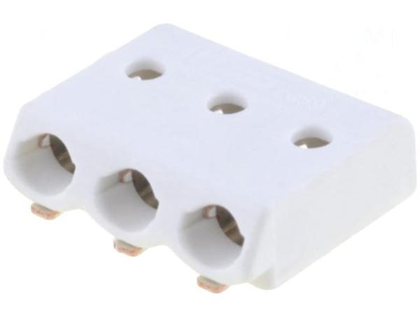

| Actuation type | Operating tool |
| Цвет | white |
| Connection technology | PUSH WIRE® |
| Contact material | Copper alloy |
| Contact plating | tin-plated |
| Country of origin | CH |
| Габариты: глубина | 7.9 mm / 0.311 inch |
| Flammability class per UL94 | V0 |
| GTIN | 4055143082693 |
| Height | 2.7 mm / 0.106 inch |
| Insulating material | Polyphtalamide (PPA GF) |
| Legend (ratings) | (III / 2) ≙ Overvoltage category III / Pollution degree 2 |
| Limit temperature range | -60 … +105 °C |
| Material group | I |
| Number of Poles | 3 |
| Number of connection types | 1 |
| Number of levels | 1 |
| PCB contact | SMD |
| Pin spacing | 3 mm (0.118 inch) |
| Product Group | 33 (Printed Circuit) |
| Rated current | 3 A |
| Rated impulse voltage (II / 2) | 2.5 kV |
| Rated impulse voltage (III / 2) | 2.5 kV |
| Rated impulse voltage (III / 3) | 2.5 kV |
| Rated voltage (II / 2) | 320 В |
| Rated voltage (III / 2) | 160 В |
| Rated voltage (III / 3) | 63 В |
| Reel diameter of tape-and-reel packaging | 330 мм |
| Solid conductor | 0.14 … 0.34 mm² / 26 … 22 AWG |
| Solid conductor (2) | 0.5 mm² / 20 AWG |
| Strip length | 4 … 5.5 mm / 0.16 … 0.22 Inch |
| Strip length (2) | 6 … 7.5 mm / 0.24 … 0.3 Inch |
| Tape width | 16 мм |
| Total number of connection points | 3 |
| Total number of potentials | 3 |
| Вес | 0.244 г |
| Ширина | 8.9 mm / 0.35 inch |
