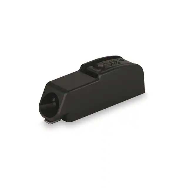

Datasheet Wago 2060-471/998-404 — Даташит
Клеммная колодка SMD PCB; Кнопка; 0,75 мм²; Шаг контактов 4 мм; 1-полюсный; Зажим Push-in CAGE CLAMP; в упаковке в виде ленты и катушки
![]() 30 предложений от 7 поставщиков Разъем: самозажимная клемма; 2060; 4мм; Кол-во полюс: 1; луженые | |||
2060-471/998-404 Wago | 22 ₽ | ||
2060-471/998-404 Wago | 66 ₽ | ||
2060-471/998-404 Wago | от 83 ₽ | ||
Actuation type | Push-button |
Цвет | black |
Connection technology | Push-in CAGE CLAMP® |
Contact material | Copper alloy |
Contact plating | tin-plated |
Country of origin | CH |
Габариты: глубина | 13.1 mm / 0.516 inch |
Fine-stranded conductor | 0.2 … 0.75 mm² / 24 … 18 AWG |
Fine-stranded conductor with ferrule with plastic collar | 0.25 … 0.34 mm² |
Fine-stranded conductor with ferrule without plastic collar | 0.25 … 0.34 mm² |
GTIN | 4055143251198 |
Height | 4.5 mm / 0.177 inch |
Insulating material | Polyphtalamide (PPA GF) |
Legend (ratings) | (III / 2) ≙ Overvoltage category III / Pollution degree 2 |
Limit temperature range | -60 … +105 °C |
Material group | I |
Number of Poles | 1 |
Number of connection types | 1 |
Number of levels | 1 |
PCB contact | SMD |
Packaging type | BOX |
Pin spacing | 4 mm (0.157 inch) |
Rated current | 9 A |
Rated impulse voltage (II / 2) | 2.5 kV |
Rated impulse voltage (III / 2) | 2.5 kV |
Rated impulse voltage (III / 3) | 2.5 kV |
Rated voltage (II / 2) | 320 В |
Rated voltage (III / 2) | 160 В |
Rated voltage (III / 3) | 63 В |
Reel diameter of tape-and-reel packaging | 330 мм |
Solid conductor | 0.2 … 0.75 mm² / 24 … 18 AWG |
Strip length | 7 … 9 mm / 0.28 … 0.35 Inch |
Tape width | 24 мм |
Total number of connection points | 1 |
Total number of potentials | 1 |
Вес | 0.25 г |
Ширина | 3.9 mm / 0.154 inch |
