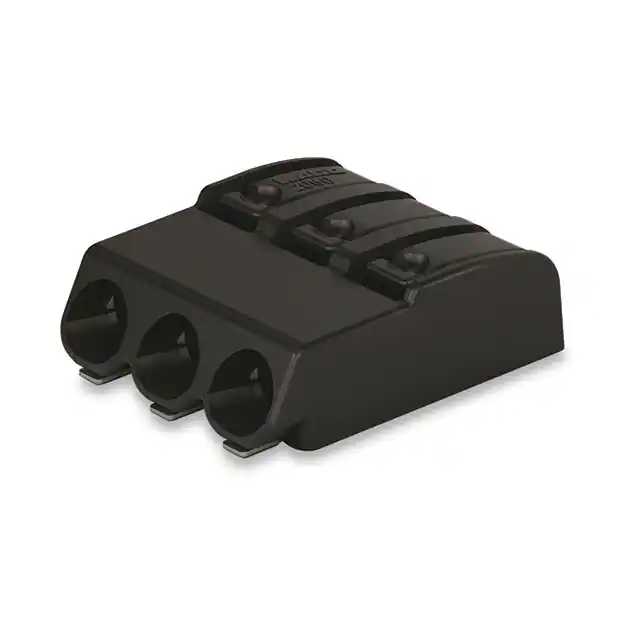

Клеммная колодка SMD PCB; Кнопка; 0,75 мм²; Шаг контактов 4 мм; 3-полюсный; Зажим Push-in CAGE CLAMP; в упаковке в виде ленты и катушки

| Actuation type | Push-button |
| Цвет | black |
| Connection technology | Push-in CAGE CLAMP® |
| Contact material | Copper alloy |
| Contact plating | tin-plated |
| Country of origin | CH |
| Габариты: глубина | 13.1 mm / 0.516 inch |
| Fine-stranded conductor | 0.2 … 0.75 mm² / 24 … 18 AWG |
| Fine-stranded conductor with ferrule with plastic collar | 0.25 … 0.34 mm² |
| Fine-stranded conductor with ferrule without plastic collar | 0.25 … 0.34 mm² |
| Flammability class per UL94 | V0 |
| GTIN | 4055143251174 |
| Height | 4.5 mm / 0.177 inch |
| Insulating material | Polyphtalamide (PPA GF) |
| Legend (ratings) | (III / 2) ≙ Overvoltage category III / Pollution degree 2 |
| Limit temperature range | -60 … +105 °C |
| Material group | I |
| Number of Poles | 3 |
| Number of connection types | 1 |
| Number of levels | 1 |
| PCB contact | SMD |
| Packaging type | BOX |
| Pin spacing | 4 mm (0.157 inch) |
| Rated current | 9 A |
| Rated impulse voltage (II / 2) | 2.5 kV |
| Rated impulse voltage (III / 2) | 2.5 kV |
| Rated impulse voltage (III / 3) | 2.5 kV |
| Rated voltage (II / 2) | 320 В |
| Rated voltage (III / 2) | 160 В |
| Rated voltage (III / 3) | 63 В |
| Reel diameter of tape-and-reel packaging | 330 мм |
| Solid conductor | 0.2 … 0.75 mm² / 24 … 18 AWG |
| Strip length | 7 … 9 mm / 0.28 … 0.35 Inch |
| Tape width | 24 мм |
| Total number of connection points | 3 |
| Total number of potentials | 3 |
| Вес | 0.769 г |
| Ширина | 11.9 mm / 0.469 inch |
