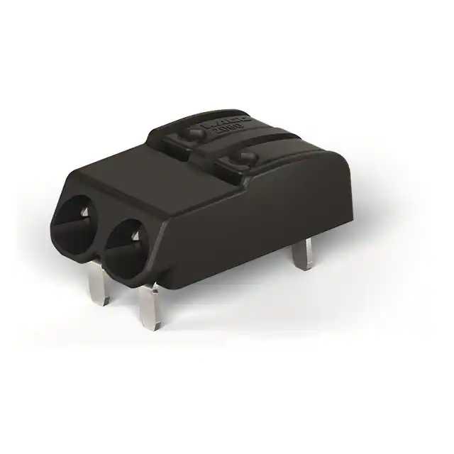

Клеммная колодка THR PCB; Кнопка; 0,75 мм²; Шаг контактов 4 мм; 2-полюсный; Зажим Push-in CAGE CLAMP; в упаковке в виде ленты и катушки

Actuation type | Push-button |
Цвет | black |
Connection technology | Push-in CAGE CLAMP® |
Contact material | Copper alloy |
Contact plating | tin-plated |
Country of origin | CH |
Габариты: глубина | 12.7 mm / 0.5 inch |
Fine-stranded conductor | 0.2 … 0.75 mm² / 24 … 18 AWG |
Fine-stranded conductor with ferrule with plastic collar | 0.25 … 0.34 mm² |
Fine-stranded conductor with ferrule without plastic collar | 0.25 … 0.34 mm² |
GTIN | 4055143331210 |
Height | 6.9 mm / 0.272 inch |
Height from the surface | 4.5 mm / 0.177 inch |
Insulating material | Polyphtalamide (PPA GF) |
Legend (ratings) | (III / 2) ≙ Overvoltage category III / Pollution degree 2 |
Limit temperature range | -60 … +105 °C |
Material group | I |
Number of Poles | 2 |
Number of connection types | 1 |
Number of levels | 1 |
Number of solder pins per potential | 2 |
PCB contact | THR |
Packaging type | BOX |
Pin spacing | 4 mm (0.157 inch) |
Plated through-hole diameter (THR) | 1.5 (+ 0.1) мм |
Rated current | 9 A |
Rated impulse voltage (II / 2) | 2.5 kV |
Rated impulse voltage (III / 2) | 2.5 kV |
Rated impulse voltage (III / 3) | 2.5 kV |
Rated voltage (II / 2) | 320 В |
Rated voltage (III / 2) | 160 В |
Rated voltage (III / 3) | 63 В |
Reel diameter of tape-and-reel packaging | 330 мм |
Solder pin arrangement | over the entire terminal strip, in line |
Solder pin dimensions | 1.2 x 0.75 mm |
Solder pin length | 2.4 мм |
Solid conductor | 0.2 … 0.75 mm² / 24 … 18 AWG |
Strip length | 6 … 7 mm / 0.24 … 0.28 Inch |
Tape width | 24 мм |
Total number of connection points | 2 |
Total number of potentials | 2 |
Вес | 0.518 г |
Ширина | 7.9 mm / 0.311 inch |
