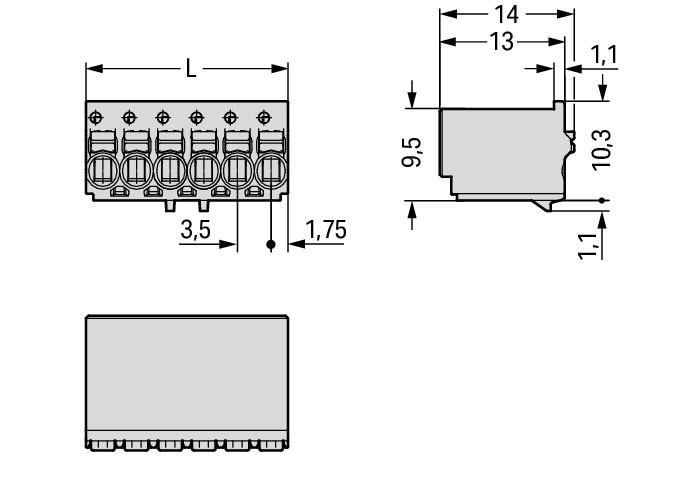

1-проводниковая розетка; 1,5; Шаг контактов 3,5 мм; 5-пол.
1-CONDUCTOR FEMALE PLUG; 1.5 MM; | |||
2091-1125 Wago | 624 ₽ | ||
2091-1125 Wago | по запросу |
Actuation type | Push-button |
Clamping spring material | Chrome nickel spring steel (CrNi) |
Цвет | light gray |
Connection technology | Push-in CAGE CLAMP® |
Connector connection type | for conductors |
Contact material | Electrolytic copper (Ecu) |
Contact plating | tin-plated |
Contact type (pluggable connector) | Female connector/socket |
Country of origin | DE |
Габариты: глубина | 11.4 mm / 0.449 inch |
Fine-stranded conductor | 0.2 … 1.5 mm² / 24 … 14 AWG |
Fine-stranded conductor with ferrule with plastic collar | 0.25 … 0.75 mm² |
Fine-stranded conductor with ferrule without plastic collar | 0.25 … 1.5 mm² |
Fire load | 0.053 MJ |
GTIN | 4050821160786 |
Height | 14 mm / 0.551 inch |
Insulating material | Polyphtalamide (PPA GF) |
Legend (ratings) | (III / 2) ≙ Overvoltage category III / Pollution degree 2 |
Limit temperature range | -60 … +100 °C |
Material group | I |
Mismating protection | No |
Number of Poles | 5 |
Number of connection types | 1 |
Number of levels | 1 |
Pin spacing | 3.5 mm (0.138 inch) |
Product Group | 26 (picoMAX) |
Rated current | 10 A |
Rated impulse voltage (II / 2) | 2.5 kV |
Rated impulse voltage (III / 2) | 2.5 kV |
Rated impulse voltage (III / 3) | 2.5 kV |
Rated voltage (II / 2) | 320 В |
Rated voltage (III / 2) | 160 В |
Rated voltage (III / 3) | 160 В |
Solid conductor | 0.2 … 1.5 mm² / 24 … 14 AWG |
Strip length | 8 … 9 mm / 0.31 … 0.35 Inch |
Total number of connection points | 5 |
Total number of potentials | 5 |
Вес | 2.187 г |
Ширина | 17.5 mm / 0.689 inch |
