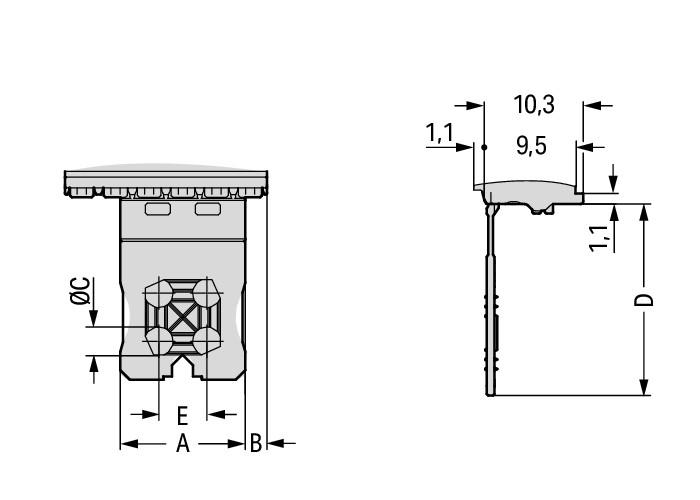

1-conductor THT female header; Вывод под пайку 1 мм Ø; прямые; Зажимная планка; 1,5; Шаг контактов 3,5 мм; 6-пол.
1-CONDUCTOR THT FEMALE HEADER1.0 MM SOLDER PIN STRAIGHT, LIGHT GRAY
Augswan
2091-1156/000-5000
Wago
Maybo
2091-1156/000-1000
Wago
Wago 2091-1156 Wago 2091-1156
Actuation typePush-button
Clamping spring materialChrome nickel spring steel (CrNi)
Цветlight gray
Conductor entry angle to the PCB90 °
Connection technologyPush-in CAGE CLAMP®
Connector connection typefor PCBs
Contact materialElectrolytic copper (Ecu)
Contact platingtin-plated
Contact type (pluggable connector)Female connector/socket
Country of originDE
Габариты: глубина11.4 mm / 0.449 inch
Drilled hole diameter (tolerance)1.2(+ 0.1) мм
Fine-stranded conductor0.2 … 1.5 mm² / 24 … 14 AWG
Fine-stranded conductor with ferrule with plastic collar0.25 … 0.75 mm²
Fine-stranded conductor with ferrule without plastic collar0.25 … 1.5 mm²
Fire load0.069 MJ
Flammability class per UL94V0
GTIN4050821162360
Height33 mm / 1.299 inch
Insulating materialPolyphtalamide (PPA GF)
Legend (ratings)(III / 2) ≙ Overvoltage category III / Pollution degree 2
Limit temperature range-60 … +100 °C
Material groupI
Mating direction to the PCB90 °
Mismating protectionNo
Number of Poles6
Number of connection types1
Number of levels1
PCB contactTHT
Pin spacing3.5 mm (0.138 inch)
Product Group26 (picoMAX)
Rated current10 A
Rated impulse voltage (II / 2)2.5 kV
Rated impulse voltage (III / 2)2.5 kV
Rated impulse voltage (III / 3)2.5 kV
Rated voltage (II / 2)320 В
Rated voltage (III / 2)160 В
Rated voltage (III / 3)160 В
Solder pin diameter1 мм
Solder pin length3.6 мм
Solid conductor0.2 … 1.5 mm² / 24 … 14 AWG
Strip length8 … 9 mm / 0.31 … 0.35 Inch
Total number of connection points6
Total number of potentials6
Вес3.377 г
Ширина21 mm / 0.827 inch
