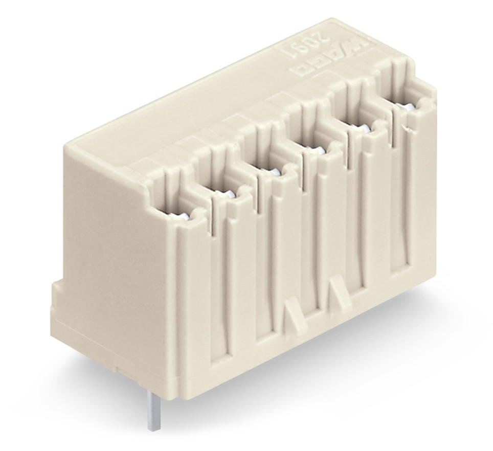

Datasheet Wago 2091-1306/200-000 — Даташит
Розетка под пайку THT; 0.4 x 0.9 mm solder pin; прямые; Шаг контактов 3,5 мм; 6-пол.
2091-1306 Wago | по запросу |
Цвет | light gray |
Connector connection type | for PCBs |
Contact material | Copper alloy |
Contact plating | tin-plated |
Contact type (pluggable connector) | Female connector/socket |
Country of origin | DE |

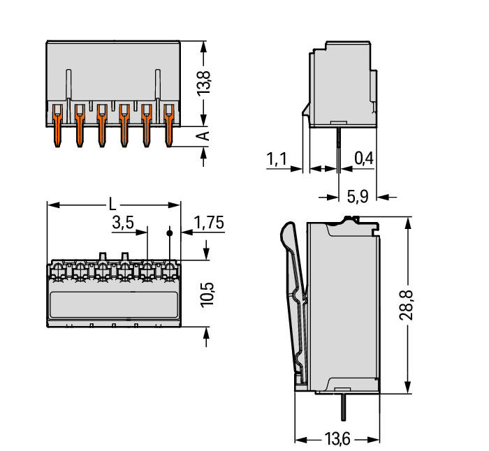

Габариты: глубина | 11.6 mm / 0.457 inch |
Fire load | 0.075 MJ |
GTIN | 4050821395959 |
Height | 16.2 mm / 0.638 inch |
Height from the surface | 13.8 mm / 0.543 inch |
Insulating material | Polyphtalamide (PPA GF) |
Legend (ratings) | (III / 2) ≙ Overvoltage category III / Pollution degree 2 |
Limit temperature range | -60 … +100 °C |
Material group | I |
Mating direction to the PCB | 90 ° |
Mismating protection | No |
Number of Poles | 6 |
Number of levels | 1 |
PCB contact | THR |
Pin spacing | 3.5 mm (0.138 inch) |
Plated through-hole diameter (THR) | 1.2 (+ 0.1) мм |
Rated current | 10 A |
Rated impulse voltage (II / 2) | 2.5 kV |
Rated impulse voltage (III / 2) | 2.5 kV |
Rated impulse voltage (III / 3) | 2.5 kV |
Rated voltage (II / 2) | 320 В |
Rated voltage (III / 2) | 160 В |
Rated voltage (III / 3) | 160 В |
Solder pin dimensions | 0.4 x 0.9 mm |
Solder pin length | 2.4 мм |
Total number of potentials | 6 |
Вес | 3.07 г |
Ширина | 21 mm / 0.827 inch |
