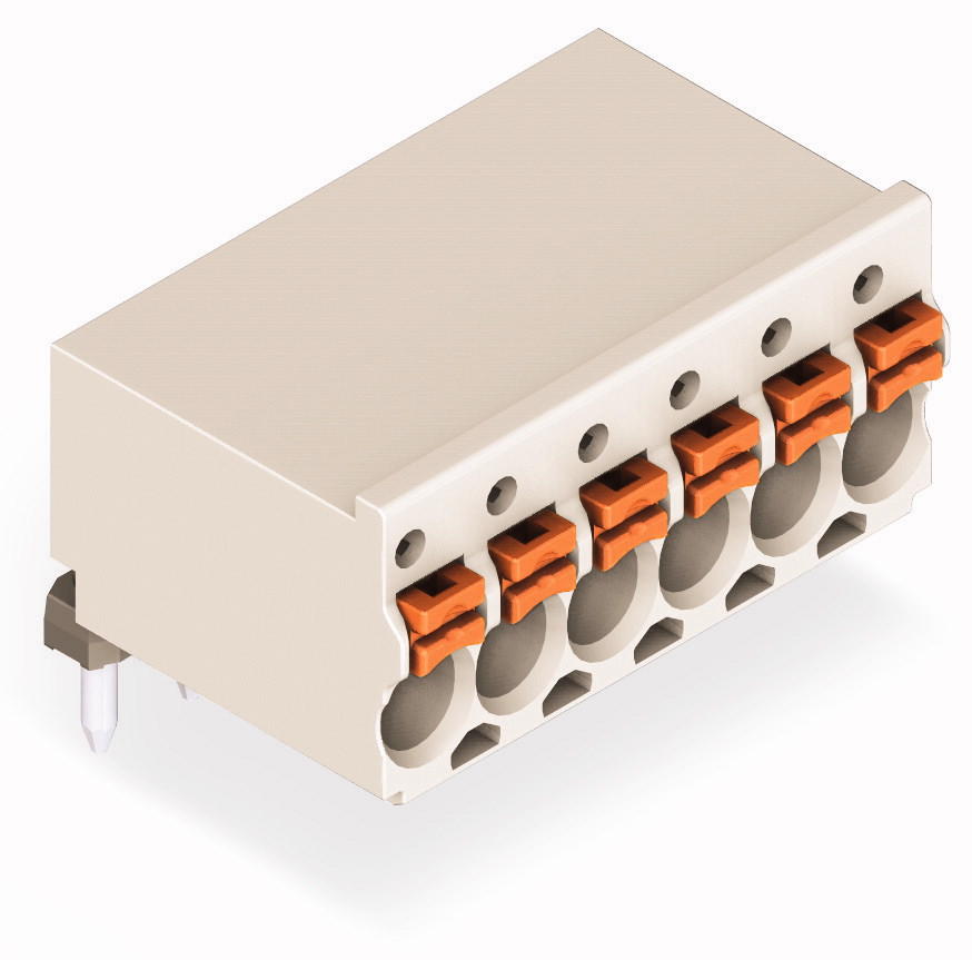

1-conductor THT female header; Вывод под пайку 1 мм Ø; угловые; 1,5; Шаг контактов 3,5 мм; 4-пол.
1-CONDUCTOR THT FEMALE HEADER1.0 MM SOLDER PIN ANGLED, LIGHT GRAY | |||
2091-1374/000-5000 Wago | по запросу | ||
2091-1374/000-1000 Wago | по запросу |
Actuation type | Push-button |
Clamping spring material | Chrome nickel spring steel (CrNi) |
Цвет | light gray |
Connection technology | Push-in CAGE CLAMP® |
Connector connection type | for PCBs |
Contact material | Electrolytic copper (Ecu) |
Contact plating | tin-plated |
Contact type (pluggable connector) | Female connector/socket |
Country of origin | DE |
Габариты: глубина | 14 mm / 0.551 inch |
Drilled hole diameter (tolerance) | 1.2(+ 0.1) мм |
Fine-stranded conductor | 0.2 … 1.5 mm² / 24 … 14 AWG |
Fine-stranded conductor with ferrule with plastic collar | 0.25 … 0.75 mm² |
Fine-stranded conductor with ferrule without plastic collar | 0.25 … 1.5 mm² |
Fire load | 0.046 MJ |
GTIN | 4050821162889 |
Height | 11.4 mm / 0.449 inch |
Insulating material | Polyphtalamide (PPA GF) |
Legend (ratings) | (III / 2) ≙ Overvoltage category III / Pollution degree 2 |
Limit temperature range | -60 … +100 °C |
Material group | I |
Mismating protection | No |
Number of Poles | 4 |
Number of connection types | 1 |
Number of levels | 1 |
PCB contact | THT |
Pin spacing | 3.5 mm (0.138 inch) |
Product Group | 26 (picoMAX) |
Rated current | 10 A |
Rated impulse voltage (II / 2) | 2.5 kV |
Rated impulse voltage (III / 2) | 2.5 kV |
Rated impulse voltage (III / 3) | 2.5 kV |
Rated voltage (II / 2) | 320 В |
Rated voltage (III / 2) | 160 В |
Rated voltage (III / 3) | 160 В |
Solder pin diameter | 1 мм |
Solder pin length | 3.6 мм |
Solid conductor | 0.2 … 1.5 mm² / 24 … 14 AWG |
Strip length | 8 … 9 mm / 0.31 … 0.35 Inch |
Total number of connection points | 4 |
Total number of potentials | 4 |
Вес | 2.261 г |
Ширина | 14 mm / 0.551 inch |
