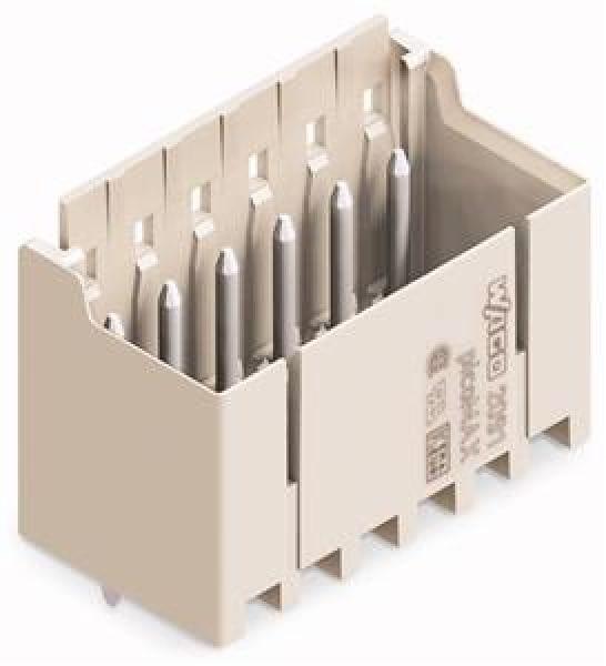

Вилка THT; Вывод под пайку 1 мм Ø; прямые; Шаг контактов 3,5 мм; 6-пол.
![]() 17 предложений от 7 поставщиков Клеммная колодка, разъем, 3,5 мм, 6 контактов, 10 А, 160 В, сквозное отверстие вертикально | |||
2091-1406 | от 205 ₽ | ||
2091-1406 Wago | 246 ₽ | ||
2091-1406 Wago | по запросу | ||
2091-1406/200-000 Wago | по запросу |
Цвет | light gray |
Connector connection type | for PCBs |
Contact material | Electrolytic copper (Ecu) |
Contact plating | tin-plated |
Contact type (pluggable connector) | Male connector/plug |
Country of origin | DE |
Габариты: глубина | 12.4 mm / 0.488 inch |
Drilled hole diameter (tolerance) | 1.2(+ 0.1) мм |
Fire load | 0.044 MJ |
GTIN | 4050821161035 |
Height | 21.1 mm / 0.831 inch |
Height from the surface | 17.5 mm / 0.689 inch |
Insulating material | Polyphtalamide (PPA GF) |
Legend (ratings) | (III / 2) ≙ Overvoltage category III / Pollution degree 2 |
Limit temperature range | -60 … +100 °C |
Locking of plug-in connection | Male locking latch |
Material group | I |
Mating direction to the PCB | 90 ° |
Mismating protection | No |
Number of Poles | 6 |
Number of levels | 1 |
PCB contact | THT |
Pin spacing | 3.5 mm (0.138 inch) |
Product Group | 26 (picoMAX) |
Rated current | 10 A |
Rated impulse voltage (II / 2) | 2.5 kV |
Rated impulse voltage (III / 2) | 2.5 kV |
Rated impulse voltage (III / 3) | 2.5 kV |
Rated voltage (II / 2) | 320 В |
Rated voltage (III / 2) | 160 В |
Rated voltage (III / 3) | 160 В |
Solder pin diameter | 1 мм |
Solder pin length | 3.6 мм |
Total number of potentials | 6 |
Вес | 2.1 г |
Ширина | 23 mm / 0.906 inch |
