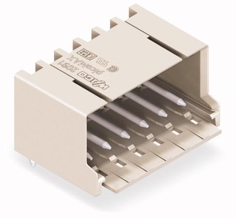

Datasheet Wago 2091-1427/200-000 — Даташит
Вилка под пайку THR; Вывод под пайку 1 мм Ø; угловые; Шаг контактов 3,5 мм; 7-пол.
THR MALE HEADER; 1.0 MM SOLDER | |||
2091-1427/200-000 Wago | по запросу |
Цвет | light gray |
Connector connection type | for PCBs |
Contact material | Electrolytic copper (Ecu) |
Contact plating | tin-plated |
Contact type (pluggable connector) | Male connector/plug |
Country of origin | DE |

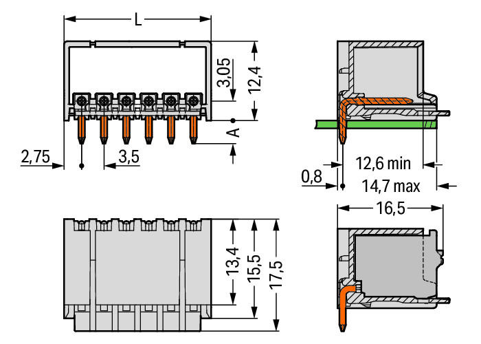

Габариты: глубина | 17.5 mm / 0.689 inch |
GTIN | 4055143460903 |
Height | 14.8 mm / 0.583 inch |
Height from the surface | 12.4 mm / 0.488 inch |
Insulating material | Polyphtalamide (PPA GF) |
Legend (ratings) | (III / 2) ≙ Overvoltage category III / Pollution degree 2 |
Limit temperature range | -60 … +100 °C |
Locking of plug-in connection | Male locking latch |
Material group | I |
Mismating protection | No |
Number of Poles | 7 |
Number of levels | 1 |
PCB contact | THR |
Pin spacing | 3.5 mm (0.138 inch) |
Plated through-hole diameter (THR) | 1.2 (+ 0.1) мм |
Rated current | 10 A |
Rated impulse voltage (II / 2) | 2.5 kV |
Rated impulse voltage (III / 2) | 2.5 kV |
Rated impulse voltage (III / 3) | 2.5 kV |
Rated voltage (II / 2) | 320 В |
Rated voltage (III / 2) | 160 В |
Rated voltage (III / 3) | 160 В |
Solder pin diameter | 1 мм |
Solder pin length | 2.4 мм |
Total number of potentials | 7 |
Вес | 2.54 г |
Ширина | 26.5 mm / 1.043 inch |
