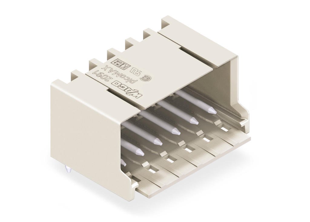

Вилка THT; Вывод под пайку 1 мм Ø; угловые; Шаг контактов 3,5 мм; 10-пол.
THR MALE HEADER1.0 MM SOLDER PIN ANGLED, LIGHT GRAY | |||
| 2091-1430/200-000 Wago | по запросу | ||
| 2091-1430/205-000 Wago | по запросу | ||
| Цвет | light gray |
| Connector connection type | for PCBs |
| Contact material | Electrolytic copper (Ecu) |
| Contact plating | tin-plated |
| Contact type (pluggable connector) | Male connector/plug |
| Country of origin | DE |
| Габариты: глубина | 17.5 mm / 0.689 inch |
| Drilled hole diameter (tolerance) | 1.2(+ 0.1) мм |
| Fire load | 0.064 MJ |
| Flammability class per UL94 | V0 |
| GTIN | 4050821161134 |
| Height | 16 mm / 0.63 inch |
| Height from the surface | 12.4 mm / 0.488 inch |
| Insulating material | Polyphtalamide (PPA GF) |
| Legend (ratings) | (III / 2) ≙ Overvoltage category III / Pollution degree 2 |
| Limit temperature range | -60 … +100 °C |
| Locking of plug-in connection | Male locking latch |
| Material group | I |
| Mismating protection | No |
| Number of Poles | 10 |
| Number of levels | 1 |
| PCB contact | THT |
| Pin spacing | 3.5 mm (0.138 inch) |
| Product Group | 26 (picoMAX) |
| Rated current | 10 A |
| Rated impulse voltage (II / 2) | 2.5 kV |
| Rated impulse voltage (III / 2) | 2.5 kV |
| Rated impulse voltage (III / 3) | 2.5 kV |
| Rated voltage (II / 2) | 320 В |
| Rated voltage (III / 2) | 160 В |
| Rated voltage (III / 3) | 160 В |
| Solder pin diameter | 1 мм |
| Solder pin length | 3.6 мм |
| Total number of potentials | 10 |
| Вес | 3.39 г |
| Ширина | 37 mm / 1.457 inch |
