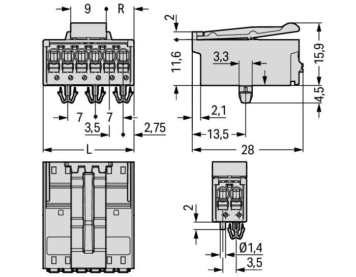

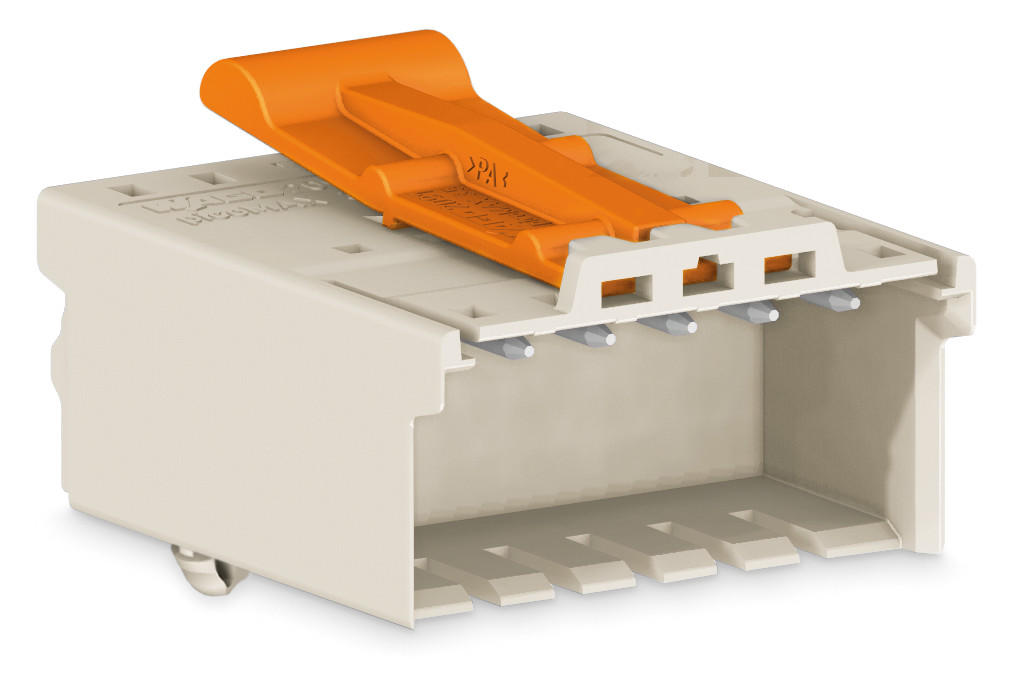

1-проводная вилка; Монтажные ножки; 1,5; Шаг контактов 3,5 мм; 2-пол.
1-CONDUCTOR MALE CONNECTOR; SNAP | |||
2091-1522/020-000 Wago | по запросу |
Actuation type | Push-button |
Clamping spring material | Chrome nickel spring steel (CrNi) |
Цвет | light gray |
Connection technology | Push-in CAGE CLAMP® |
Connector connection type | for conductors |
Contact material | Electrolytic copper (Ecu) |
Contact plating | tin-plated |
Contact type (pluggable connector) | Male connector/plug |
Country of origin | DE |
Габариты: глубина | 28 mm / 1.102 inch |
Fine-stranded conductor | 0.2 … 1.5 mm² / 24 … 14 AWG |
Fine-stranded conductor with ferrule with plastic collar | 0.25 … 0.75 mm² |
Fine-stranded conductor with ferrule without plastic collar | 0.25 … 1.5 mm² |
Fire load | 0.071 MJ |
GTIN | 4050821161394 |
Height | 20.4 mm / 0.803 inch |
Height from the surface | 15.9 mm / 0.626 inch |
Insulating material | Polyphtalamide (PPA GF) |
Legend (ratings) | (III / 2) ≙ Overvoltage category III / Pollution degree 2 |
Limit temperature range | -60 … +100 °C |
Locking of plug-in connection | Male locking latch |
Material group | I |
Mismating protection | No |
Number of Poles | 2 |
Number of connection types | 1 |
Number of levels | 1 |

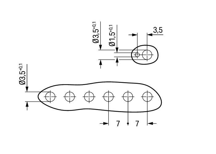

Pin spacing | 3.5 mm (0.138 inch) |
Product Group | 26 (picoMAX) |
Rated current | 10 A |
Rated impulse voltage (II / 2) | 2.5 kV |
Rated impulse voltage (III / 2) | 2.5 kV |
Rated impulse voltage (III / 3) | 2.5 kV |
Rated voltage (II / 2) | 320 В |
Rated voltage (III / 2) | 160 В |
Rated voltage (III / 3) | 160 В |
Solid conductor | 0.2 … 1.5 mm² / 24 … 14 AWG |
Strip length | 8 … 9 mm / 0.31 … 0.35 Inch |
Total number of connection points | 2 |
Total number of potentials | 2 |
Вес | 2.811 г |
Ширина | 9 mm / 0.354 inch |
