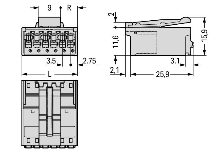

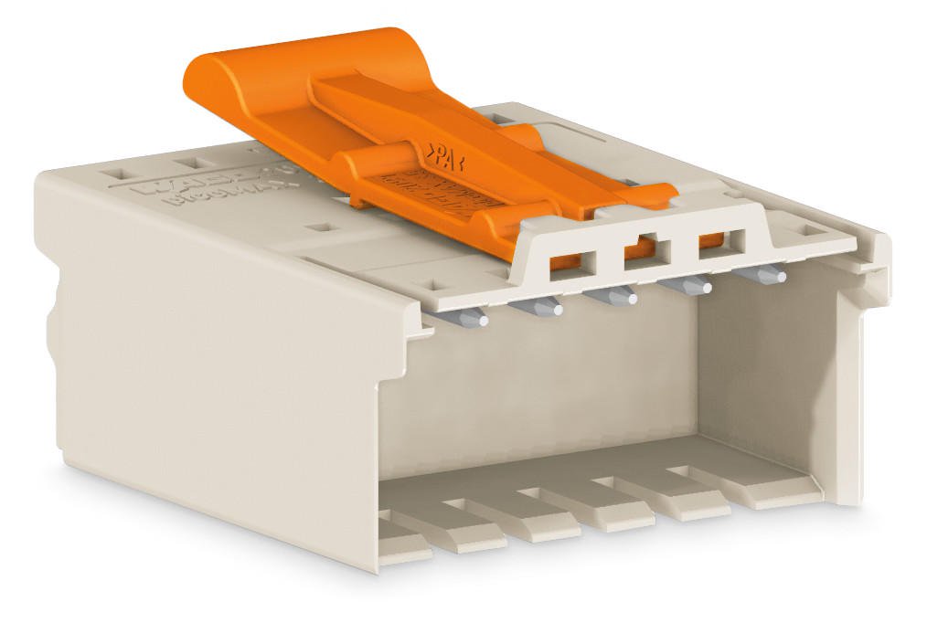

1-проводная вилка; Встроенный рычаг для размыкания; прямая маркировка; 1,5; Шаг контактов 3,5 мм; 5-пол.
Augswan
2091-1525/002-3000
Wago
Wago 2091-1525/002-3000
Actuation typePush-button
Clamping spring materialChrome nickel spring steel (CrNi)
Цветlight gray
Connection technologyPush-in CAGE CLAMP®
Connector connection typefor conductors
Contact materialElectrolytic copper (Ecu)
Contact platingtin-plated
Contact type (pluggable connector)Male connector/plug
Country of originDE
Габариты: глубина28 mm / 1.102 inch
Fine-stranded conductor0.2 … 1.5 mm² / 24 … 14 AWG
Fine-stranded conductor with ferrule with plastic collar0.25 … 0.75 mm²
Fine-stranded conductor with ferrule without plastic collar0.25 … 1.5 mm²
Flammability class per UL94V0
GTIN4055143623056
Height15.9 mm / 0.626 inch
Insulating materialPolyphtalamide (PPA GF)
Legend (ratings)(III / 2) ≙ Overvoltage category III / Pollution degree 2
Limit temperature range-60 … +100 °C
Locking of plug-in connectionMale locking latch
Material groupI
Mismating protectionNo
Number of Poles5
Number of connection types1
Number of levels1
Pin spacing3.5 mm (0.138 inch)
Rated current10 A
Rated impulse voltage (II / 2)2.5 kV
Rated impulse voltage (III / 2)2.5 kV
Rated impulse voltage (III / 3)2.5 kV
Rated voltage (II / 2)320 В
Rated voltage (III / 2)160 В
Rated voltage (III / 3)160 В
Solid conductor0.2 … 1.5 mm² / 24 … 14 AWG
Strip length8 … 9 mm / 0.31 … 0.35 Inch
Total number of connection points5
Total number of potentials5
Вес5.226 г
Ширина17.5 mm / 0.689 inch
