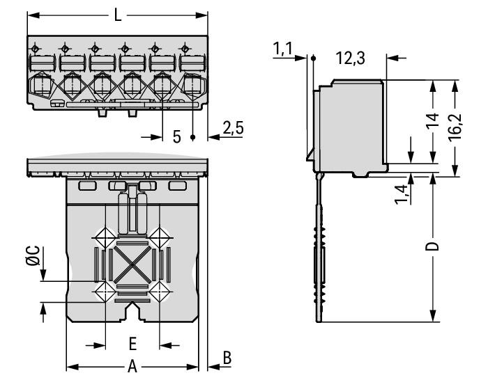

1-проводниковая розетка; Зажимная планка; прямая маркировка; 2,5 мм²; Шаг контактов 5 мм; 3-пол.
| 1-CONDUCTOR FEMALE PLUG; GRIPPIN | |||
| 2092-1103/000-5000 Wago | по запросу | ||
| Actuation type | Push-button |
| Clamping spring material | Chrome nickel spring steel (CrNi) |
| Цвет | light gray |
| Connection technology | Push-in CAGE CLAMP® |
| Connector connection type | for conductors |
| Contact material | Electrolytic copper (Ecu) |
| Contact plating | tin-plated |
| Contact type (pluggable connector) | Female connector/socket |
| Country of origin | DE |
| Габариты: глубина | 13.4 mm / 0.528 inch |
| Fine-stranded conductor | 0.2 … 2.5 mm² / 24 … 12 AWG |
| Fine-stranded conductor with ferrule with plastic collar | 0.25 … 1.5 mm² |
| Fine-stranded conductor with ferrule without plastic collar | 0.25 … 2.5 mm² |
| Fire load | 0.072 MJ |
| Flammability class per UL94 | V0 |
| GTIN | 4050821353805 |
| Height | 35.4 mm / 1.394 inch |
| Insulating material | Polyphtalamide (PPA GF) |
| Legend (ratings) | (III / 2) ≙ Overvoltage category III / Pollution degree 2 |
| Limit temperature range | -60 … +100 °C |
| Material group | I |
| Mismating protection | No |
| Number of Poles | 3 |
| Number of connection types | 1 |
| Number of levels | 1 |
| Pin spacing | 5 mm (0.197 inch) |
| Rated current | 16 A |
| Rated impulse voltage (II / 2) | 4 kV |
| Rated impulse voltage (III / 2) | 4 kV |
| Rated impulse voltage (III / 3) | 4 kV |
| Rated voltage (II / 2) | 630 В |
| Rated voltage (III / 2) | 320 В |
| Rated voltage (III / 3) | 250 В |
| Solid conductor | 0.2 … 2.5 mm² / 24 … 12 AWG |
| Strip length | 9 … 10 mm / 0.35 … 0.39 Inch |
| Total number of connection points | 3 |
| Total number of potentials | 3 |
| Вес | 3 г |
| Ширина | 15 mm / 0.591 inch |
