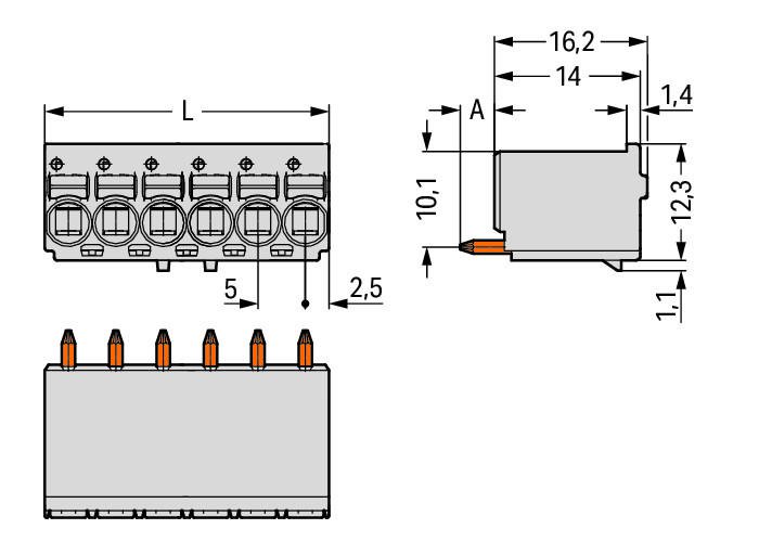

1-conductor THT female header; 1.4 mm Ø solder pin; прямые; прямая маркировка; 2,5 мм²; Шаг контактов 5 мм; 3-пол.
1-CONDUCTOR THT FEMALE HEADER1.4 MM SOLDER PIN STRAIGHT, LIGHT GRAY | |||
2092-1173/000-5000 Wago | по запросу | ||
Actuation type | Push-button |
Clamping spring material | Chrome nickel spring steel (CrNi) |
Цвет | light gray |
Conductor entry angle to the PCB | 90 ° |
Connection technology | Push-in CAGE CLAMP® |
Connector connection type | for PCBs |
Contact material | Electrolytic copper (Ecu) |
Contact plating | tin-plated |
Contact type (pluggable connector) | Female connector/socket |
Country of origin | DE |
Габариты: глубина | 13.4 mm / 0.528 inch |
Drilled hole diameter (tolerance) | 1.6(+ 0.1) мм |
Fine-stranded conductor | 0.2 … 2.5 mm² / 24 … 12 AWG |
Fine-stranded conductor with ferrule with plastic collar | 0.25 … 1.5 mm² |
Fine-stranded conductor with ferrule without plastic collar | 0.25 … 2.5 mm² |
Fire load | 0.065 MJ |
GTIN | 4050821360018 |
Height | 16.2 mm / 0.638 inch |
Insulating material | Polyphtalamide (PPA GF) |
Legend (ratings) | (III / 2) ≙ Overvoltage category III / Pollution degree 2 |
Limit temperature range | -60 … +100 °C |
Material group | I |
Mating direction to the PCB | 90 ° |
Mismating protection | No |
Number of Poles | 3 |
Number of connection types | 1 |
Number of levels | 1 |
PCB contact | THT |
Pin spacing | 5 mm (0.197 inch) |
Rated current | 16 A |
Rated impulse voltage (II / 2) | 4 kV |
Rated impulse voltage (III / 2) | 4 kV |
Rated impulse voltage (III / 3) | 4 kV |
Rated voltage (II / 2) | 630 В |
Rated voltage (III / 2) | 320 В |
Rated voltage (III / 3) | 250 В |
Solder pin diameter | 1.4 мм |
Solder pin length | 3.6 мм |
Solid conductor | 0.2 … 2.5 mm² / 24 … 12 AWG |
Strip length | 9 … 10 mm / 0.35 … 0.39 Inch |
Total number of connection points | 3 |
Total number of potentials | 3 |
Вес | 3.32 г |
Ширина | 15 mm / 0.591 inch |
