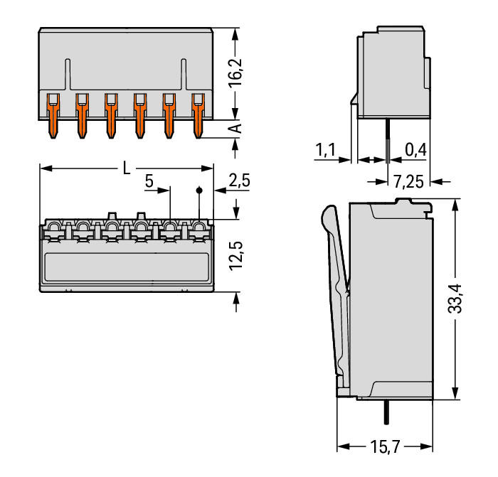

Розетка под пайку THT; 0.4 x 1.3 mm solder pin; прямые; Шаг контактов 5 мм; 3-пол.
Augswan
2092-1303/200-000
Wago
Wago 2092-1303/200-000
Цветlight gray
Connector connection typefor PCBs
Contact materialCopper alloy
Contact platingtin-plated
Contact type (pluggable connector)Female connector/socket
Country of originDE
Габариты: глубина13.6 mm / 0.535 inch
Fire load0.069 MJ
Flammability class per UL94V0
GTIN4050821395461
Height18.6 mm / 0.732 inch
Height from the surface16.2 mm / 0.638 inch
Insulating materialPolyphtalamide (PPA GF)
Legend (ratings)(III / 2) ≙ Overvoltage category III / Pollution degree 2
Limit temperature range-60 … +100 °C
Material groupI
Mating direction to the PCB90 °
Mismating protectionNo
Number of Poles3
Number of levels1
PCB contactTHR
Pin spacing5 mm (0.197 inch)
Plated through-hole diameter (THR)1.5 (+ 0.1) мм
Rated current16 A
Rated impulse voltage (II / 2)4 kV
Rated impulse voltage (III / 2)4 kV
Rated impulse voltage (III / 3)4 kV
Rated voltage (II / 2)630 В
Rated voltage (III / 2)320 В
Rated voltage (III / 3)250 В
Solder pin dimensions0.4 x 1.3 mm
Solder pin length2.4 мм
Total number of potentials3
Вес2.78 г
Ширина15 mm / 0.591 inch
