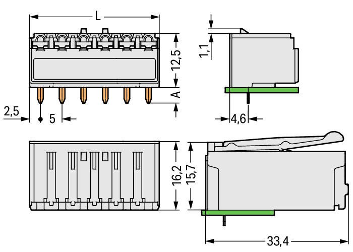

Datasheet Wago 2092-1326/200-000 — Даташит
Розетка под пайку THT; 0.4 x 1.3 mm solder pin; угловые; Шаг контактов 5 мм; 6-пол.
THT FEMALE HEADER; 0.4 X 1.3 MM | |||
2092-1326 Wago | по запросу |
Цвет | light gray |
Connector connection type | for PCBs |
Contact material | Copper alloy |
Contact plating | tin-plated |
Contact type (pluggable connector) | Female connector/socket |
Country of origin | DE |
Габариты: глубина | 15.4 mm / 0.606 inch |
Fire load | 0.138 MJ |
GTIN | 4050821395546 |
Height | 16 mm / 0.63 inch |
Height from the surface | 13.6 mm / 0.535 inch |
Insulating material | Polyphtalamide (PPA GF) |
Legend (ratings) | (III / 2) ≙ Overvoltage category III / Pollution degree 2 |
Limit temperature range | -60 … +100 °C |
Material group | I |
Mismating protection | No |
Number of Poles | 6 |
Number of levels | 1 |
PCB contact | THR |
Pin spacing | 5 mm (0.197 inch) |
Plated through-hole diameter (THR) | 1.5 (+ 0.1) мм |
Rated current | 16 A |
Rated impulse voltage (II / 2) | 4 kV |
Rated impulse voltage (III / 2) | 4 kV |
Rated impulse voltage (III / 3) | 4 kV |
Rated voltage (II / 2) | 630 В |
Rated voltage (III / 2) | 320 В |
Rated voltage (III / 3) | 250 В |
Solder pin dimensions | 0.4 x 1.3 mm |
Solder pin length | 2.4 мм |
Total number of potentials | 6 |
Вес | 5.86 г |
Ширина | 30 mm / 1.181 inch |
