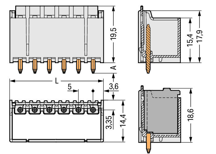

Вилка под пайку THR; 1.4 mm Ø solder pin; прямые; Шаг контактов 5 мм; 10-пол.
THR MALE HEADER; 1.4 MM SOLDER | |||
2092-1410/200-000 Wago | по запросу | ||
Цвет | light gray |
Connector connection type | for PCBs |
Contact material | Electrolytic copper (Ecu) |
Contact plating | tin-plated |
Contact type (pluggable connector) | Male connector/plug |
Country of origin | DE |
Габариты: глубина | 14.4 mm / 0.567 inch |
Fire load | 0.107 MJ |
GTIN | 4050821395676 |
Height | 21.9 mm / 0.862 inch |
Height from the surface | 19.5 mm / 0.768 inch |
Insulating material | Polyphtalamide (PPA GF) |
Legend (ratings) | (III / 2) ≙ Overvoltage category III / Pollution degree 2 |
Limit temperature range | -60 … +100 °C |
Locking of plug-in connection | Male locking latch |
Material group | I |
Mating direction to the PCB | 90 ° |
Mismating protection | No |
Number of Poles | 10 |
Number of levels | 1 |
PCB contact | THR |
Pin spacing | 5 mm (0.197 inch) |
Plated through-hole diameter (THR) | 1.6 (+ 0.1) мм |
Rated current | 16 A |
Rated impulse voltage (II / 2) | 4 kV |
Rated impulse voltage (III / 2) | 4 kV |
Rated impulse voltage (III / 3) | 4 kV |
Rated voltage (II / 2) | 630 В |
Rated voltage (III / 2) | 320 В |
Rated voltage (III / 3) | 250 В |
Solder pin diameter | 1.4 мм |
Solder pin length | 2.4 мм |
Total number of potentials | 10 |
Вес | 5.46 г |
Ширина | 52.2 mm / 2.055 inch |
