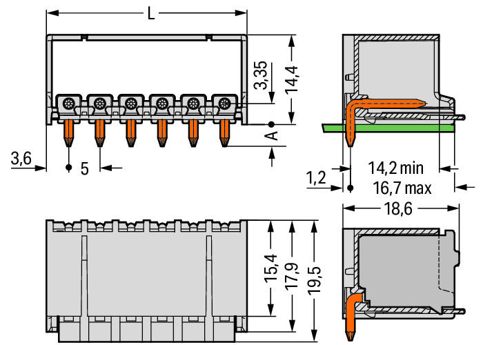

Вилка под пайку THR; 1.4 mm Ø solder pin; угловые; Шаг контактов 5 мм; 8-пол.
Augswan
2092-1428/200-000
Wago
Wago 2092-1428/200-000
Цветlight gray
Connector connection typefor PCBs
Contact materialElectrolytic copper (Ecu)
Contact platingtin-plated
Contact type (pluggable connector)Male connector/plug
Country of originDE
Габариты: глубина19.5 mm / 0.768 inch
Fire load0.089 MJ
Flammability class per UL94V0
GTIN4050821395782
Height16.8 mm / 0.661 inch
Height from the surface14.4 mm / 0.567 inch
Insulating materialPolyphtalamide (PPA GF)
Legend (ratings)(III / 2) ≙ Overvoltage category III / Pollution degree 2
Limit temperature range-60 … +100 °C
Locking of plug-in connectionMale locking latch
Material groupI
Mismating protectionNo
Number of Poles8
Number of levels1
PCB contactTHR
Pin spacing5 mm (0.197 inch)
Plated through-hole diameter (THR)1.6 (+ 0.1) мм
Rated current16 A
Rated impulse voltage (II / 2)4 kV
Rated impulse voltage (III / 2)4 kV
Rated impulse voltage (III / 3)4 kV
Rated voltage (II / 2)630 В
Rated voltage (III / 2)320 В
Rated voltage (III / 3)250 В
Solder pin diameter1.4 мм
Solder pin length2.4 мм
Total number of potentials8
Вес4.64 г
Ширина42.2 mm / 1.661 inch
