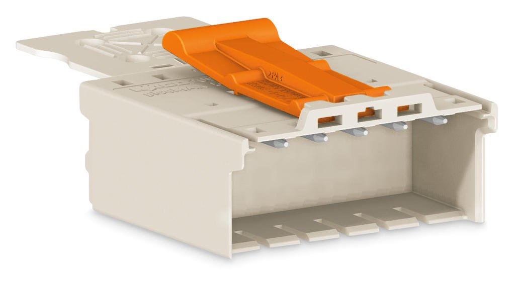

1-проводная вилка; Зажимная планка; 2,5 мм²; Шаг контактов 5 мм; 2-пол.
1-CONDUCTOR MALE CONNECTOR; GRIP | |||
2092-1502/002-000 Wago | по запросу |
Actuation type | Push-button |
Clamping spring material | Chrome nickel spring steel (CrNi) |
Цвет | light gray |
Connection technology | Push-in CAGE CLAMP® |
Connector connection type | for conductors |
Contact material | Electrolytic copper (Ecu) |
Contact plating | tin-plated |
Contact type (pluggable connector) | Male connector/plug |
Country of origin | DE |

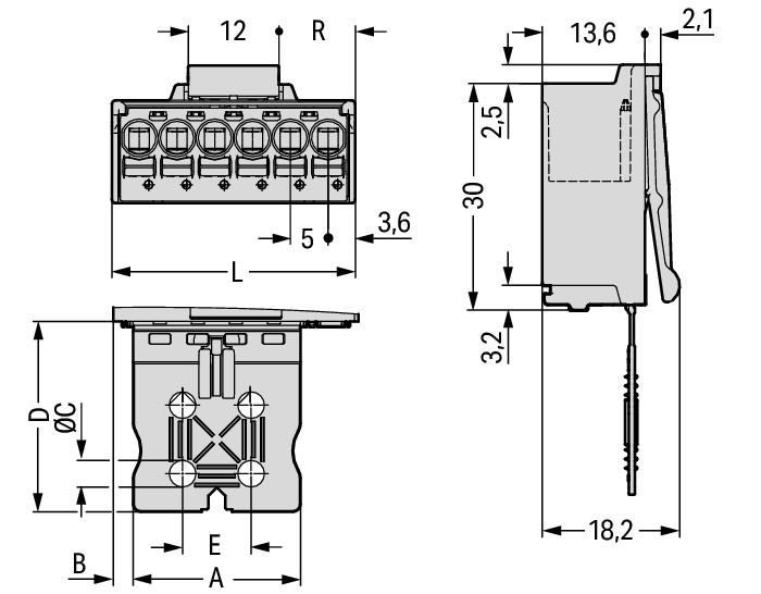

Габариты: глубина | 52.6 mm / 2.071 inch |
Fine-stranded conductor | 0.2 … 2.5 mm² / 24 … 12 AWG |
Fine-stranded conductor with ferrule with plastic collar | 0.25 … 1.5 mm² |
Fine-stranded conductor with ferrule without plastic collar | 0.25 … 2.5 mm² |
Fire load | 0.127 MJ |
GTIN | 4050821164159 |
Height | 18.2 mm / 0.717 inch |
Insulating material | Polyphtalamide (PPA GF) |
Legend (ratings) | (III / 2) ≙ Overvoltage category III / Pollution degree 2 |
Limit temperature range | -60 … +100 °C |
Locking of plug-in connection | Male locking latch |
Material group | I |
Mismating protection | No |
Number of Poles | 2 |
Number of connection types | 1 |
Number of levels | 1 |
Pin spacing | 5 mm (0.197 inch) |
Product Group | 26 (picoMAX) |
Rated current | 16 A |
Rated impulse voltage (II / 2) | 4 kV |
Rated impulse voltage (III / 2) | 4 kV |
Rated impulse voltage (III / 3) | 4 kV |
Rated voltage (II / 2) | 630 В |
Rated voltage (III / 2) | 320 В |
Rated voltage (III / 3) | 250 В |
Solid conductor | 0.2 … 2.5 mm² / 24 … 12 AWG |
Strip length | 9 … 10 mm / 0.35 … 0.39 Inch |
Total number of connection points | 2 |
Total number of potentials | 2 |
Вес | 5.179 г |
Ширина | 12.2 mm / 0.48 inch |
