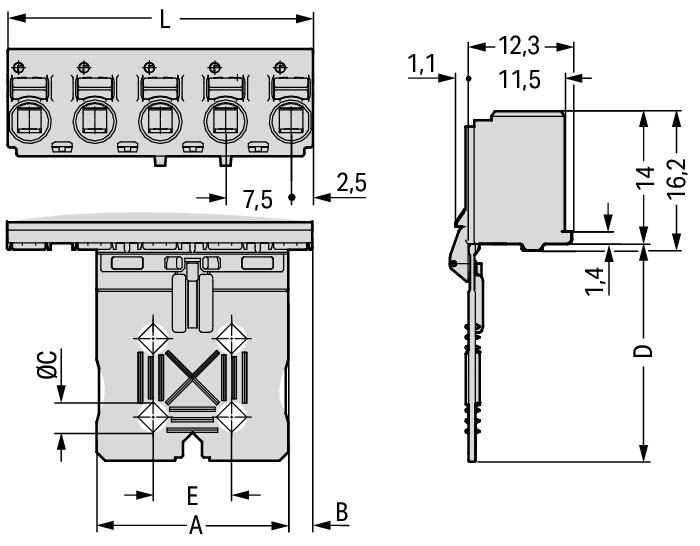

1-проводниковая розетка; Передвижная планка и механизм разъединения; 2,5 мм²; Шаг контактов 7,5 мм; 5-пол.
Augswan
2092-3105/002-000
Wago
Wago 2092-3105/002-000
Actuation typePush-button
Clamping spring materialChrome nickel spring steel (CrNi)
Цветlight gray
Connection technologyPush-in CAGE CLAMP®
Connector connection typefor conductors
Contact materialElectrolytic copper (Ecu)
Contact platingtin-plated
Contact type (pluggable connector)Female connector/socket
Country of originDE
Габариты: глубина14.4 mm / 0.567 inch
Fine-stranded conductor0.2 … 2.5 mm² / 24 … 12 AWG
Fine-stranded conductor with ferrule with plastic collar0.25 … 1.5 mm²
Fine-stranded conductor with ferrule without plastic collar0.25 … 2.5 mm²
Fire load0.171 MJ
Flammability class per UL94V0
GTIN4050821411932
Height39 mm / 1.535 inch
Insulating materialPolyphtalamide (PPA GF)
Legend (ratings)(III / 2) ≙ Overvoltage category III / Pollution degree 2
Limit temperature range-60 … +100 °C
Material groupI
Mismating protectionNo
Number of Poles5
Number of connection types1
Number of levels1
Pin spacing7.5 mm (0.295 inch)
Rated current16 A
Rated impulse voltage (II / 2)4 kV
Rated impulse voltage (III / 2)4 kV
Rated impulse voltage (III / 3)6 kV
Rated voltage (II / 2)630 В
Rated voltage (III / 2)320 В
Rated voltage (III / 3)400 В
Solid conductor0.2 … 2.5 mm² / 24 … 12 AWG
Strip length9 … 10 mm / 0.35 … 0.39 Inch
Total number of connection points5
Total number of potentials5
Вес6.736 г
Ширина35 mm / 1.378 inch
