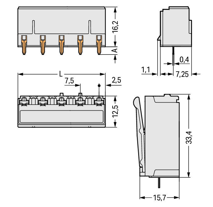

Datasheet Wago 2092-3302/200-000 — Даташит
Розетка под пайку THT; 0.4 x 1.3 mm solder pin; прямые; Шаг контактов 7,5 мм; 2-пол.
Цвет | light gray |
Connector connection type | for PCBs |
Contact material | Copper alloy |
Contact plating | tin-plated |
Contact type (pluggable connector) | Female connector/socket |
Country of origin | DE |
Габариты: глубина | 13.6 mm / 0.535 inch |
Fire load | 0.057 MJ |
GTIN | 4050821396390 |
Height | 18.6 mm / 0.732 inch |
Height from the surface | 16.2 mm / 0.638 inch |
Insulating material | Polyphtalamide (PPA GF) |
Legend (ratings) | (III / 2) ≙ Overvoltage category III / Pollution degree 2 |
Limit temperature range | -60 … +100 °C |
Material group | I |
Mating direction to the PCB | 90 ° |
Mismating protection | No |
Number of Poles | 2 |
Number of levels | 1 |
PCB contact | THR |
Pin spacing | 7.5 mm (0.295 inch) |
Plated through-hole diameter (THR) | 1.5 (+ 0.1) мм |
Rated current | 16 A |
Rated impulse voltage (II / 2) | 4 kV |
Rated impulse voltage (III / 2) | 4 kV |
Rated impulse voltage (III / 3) | 6 kV |
Rated voltage (II / 2) | 630 В |
Rated voltage (III / 2) | 320 В |
Rated voltage (III / 3) | 400 В |
Solder pin dimensions | 0.4 x 1.3 mm |
Solder pin length | 2.4 мм |
Total number of potentials | 2 |
Вес | 2.19 г |
Ширина | 12.5 mm / 0.492 inch |
