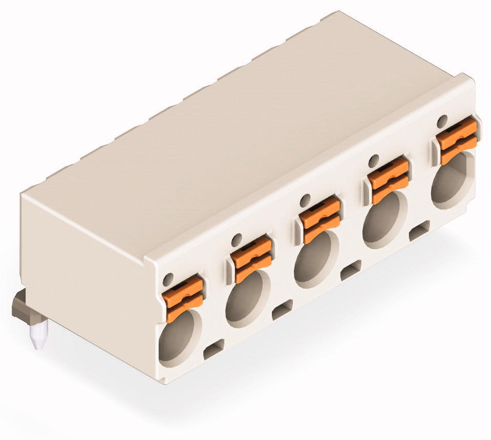

Datasheet Wago 2092-3372 — Даташит
1-conductor THT female header; 1.4 mm Ø solder pin; угловые; 2,5 мм²; Шаг контактов 7,5 мм; 2-пол.
1-CONDUCTOR THT FEMALE HEADER; 1 | |||
2092-3372 Wago | по запросу |
Actuation type | Push-button |
Clamping spring material | Chrome nickel spring steel (CrNi) |
Цвет | light gray |
Connection technology | Push-in CAGE CLAMP® |
Connector connection type | for PCBs |
Contact material | Electrolytic copper (Ecu) |
Contact plating | tin-plated |
Contact type (pluggable connector) | Female connector/socket |
Country of origin | DE |

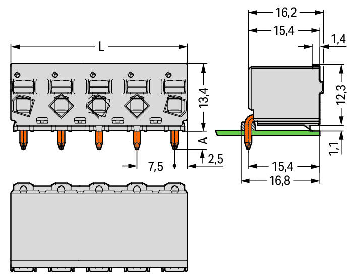

Габариты: глубина | 16.2 mm / 0.638 inch |
Drilled hole diameter (tolerance) | 1.6(+ 0.1) мм |
Fine-stranded conductor | 0.2 … 2.5 mm² / 24 … 12 AWG |
Fine-stranded conductor with ferrule with plastic collar | 0.25 … 1.5 mm² |
Fine-stranded conductor with ferrule without plastic collar | 0.25 … 2.5 mm² |
Fire load | 0.059 MJ |
GTIN | 4050821165460 |
Height | 13.4 mm / 0.528 inch |
Insulating material | Polyphtalamide (PPA GF) |
Legend (ratings) | (III / 2) ≙ Overvoltage category III / Pollution degree 2 |
Limit temperature range | -60 … +100 °C |
Material group | I |
Mismating protection | No |
Number of Poles | 2 |
Number of connection types | 1 |
Number of levels | 1 |
PCB contact | THT |
Pin spacing | 7.5 mm (0.295 inch) |
Product Group | 26 (picoMAX) |
Rated current | 16 A |
Rated impulse voltage (II / 2) | 6 kV |
Rated impulse voltage (III / 2) | 6 kV |
Rated impulse voltage (III / 3) | 6 kV |
Rated voltage (II / 2) | 1000 В |
Rated voltage (III / 2) | 630 В |
Rated voltage (III / 3) | 400 В |
Solder pin diameter | 1.4 мм |
Solder pin length | 3.6 мм |
Solid conductor | 0.2 … 2.5 mm² / 24 … 12 AWG |
Strip length | 9 … 10 mm / 0.35 … 0.39 Inch |
Total number of connection points | 2 |
Total number of potentials | 2 |
Вес | 2.74 г |
Ширина | 12.5 mm / 0.492 inch |
